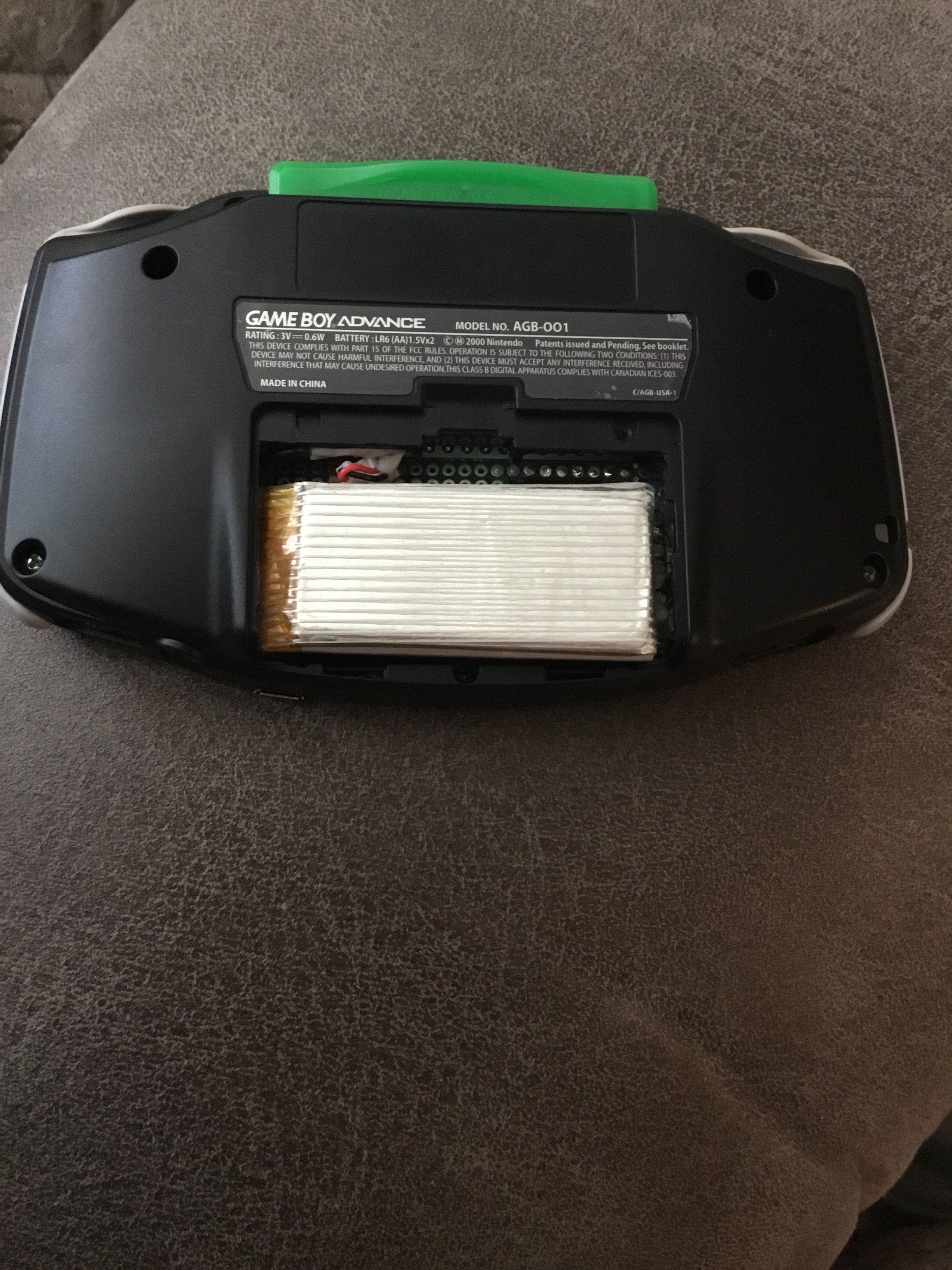

So i know its been a while, but i just had time to finish a build and i took pictures of the perf board.
I have connected the led leads to the side pads to connect led lights to the outside of the shell for the charging indicator.
The mounted board:
The battery above is a 750 mAh drone battery, its a perfect fit for this.

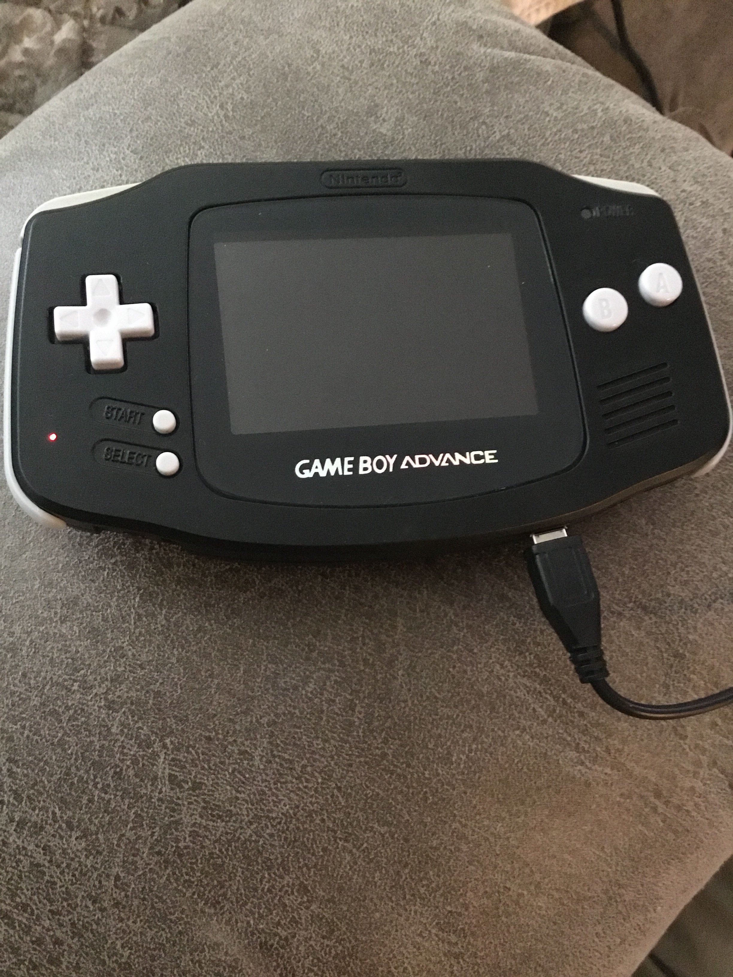

The charging port:
When its charging the light indicator by the Start Select shines red, when its charged it will shine white.

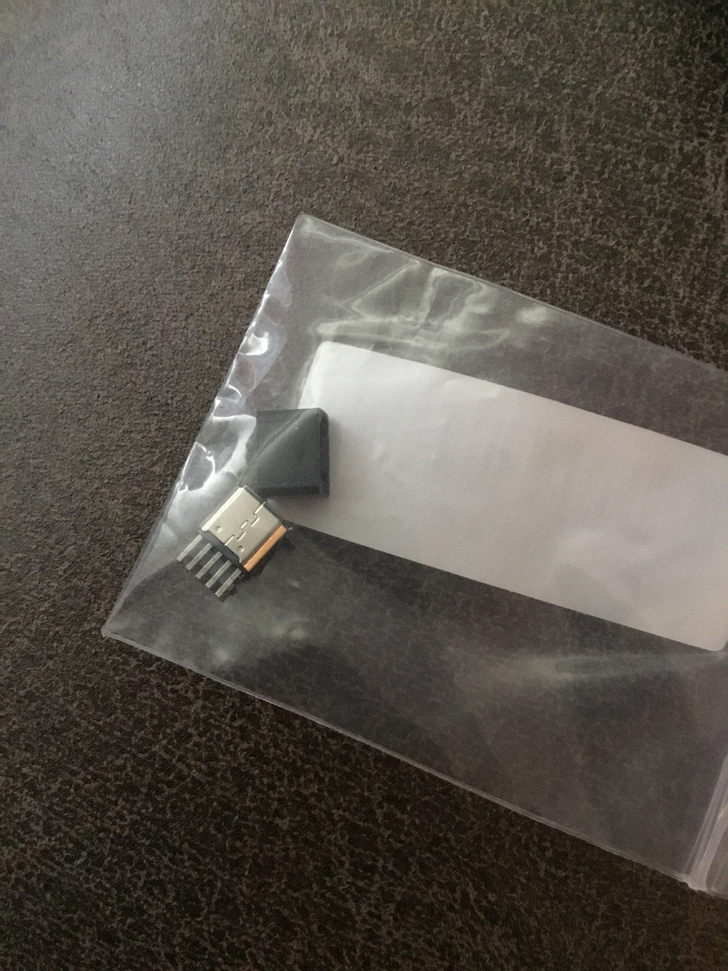

I found that the Adafruit micro usb brake out board doesnt really fit. The best port i found is the Adafruit DIY micro usb port, its really easy to solder it on.
It looks like this:
I hope this helps.
