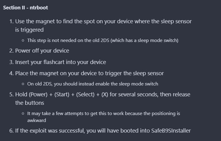

Alright, so I've done all of section one of ntrboot, no problem. Section 2 tells me to hold start button when the 3DS is starting, and my 3DS still just starts normally. What am I doing wrong?

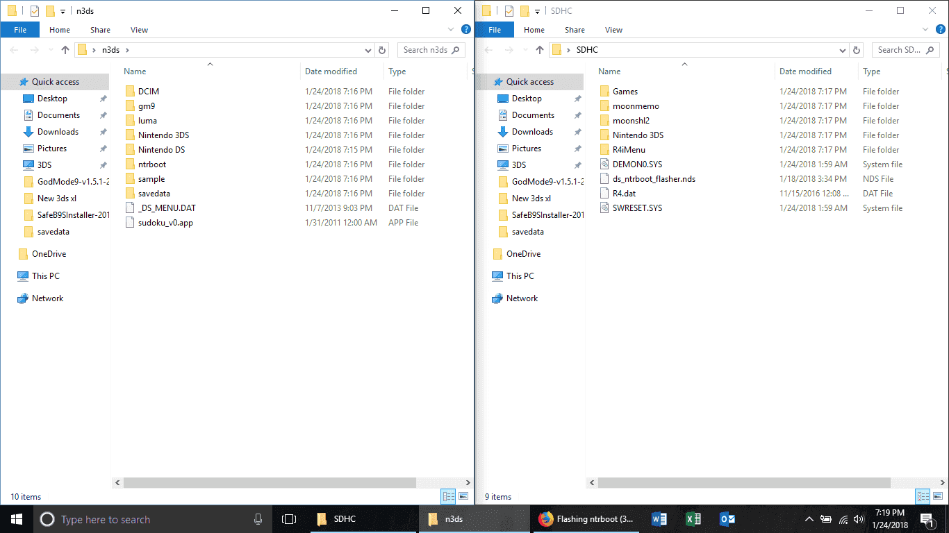

So, by section one, you mean you already did this? (Image below)
Its still not working though?

What exactly have you done already? Can you show us with a screenshot or link? And show us which part you're trying to follow now?

I have the boot.firm; put it in both SD cards (the New 3DS XL and the R4i) didn't change anything.
Sorry Quantumcat, here's what I've tried.
Installing DSiware;
Section I Number 7: doesn't work
R4i SCHI Gold Pro 2018 works
Flash ntrboot 3DS multi system
Section II Number 1: doesn't work

OK, thank you Quantumcat, I'm now at the part where you are inside the R4 card pressing up, up and all sorts. Can't find Section II Number 6. I don't have an option saying RETAIL.
