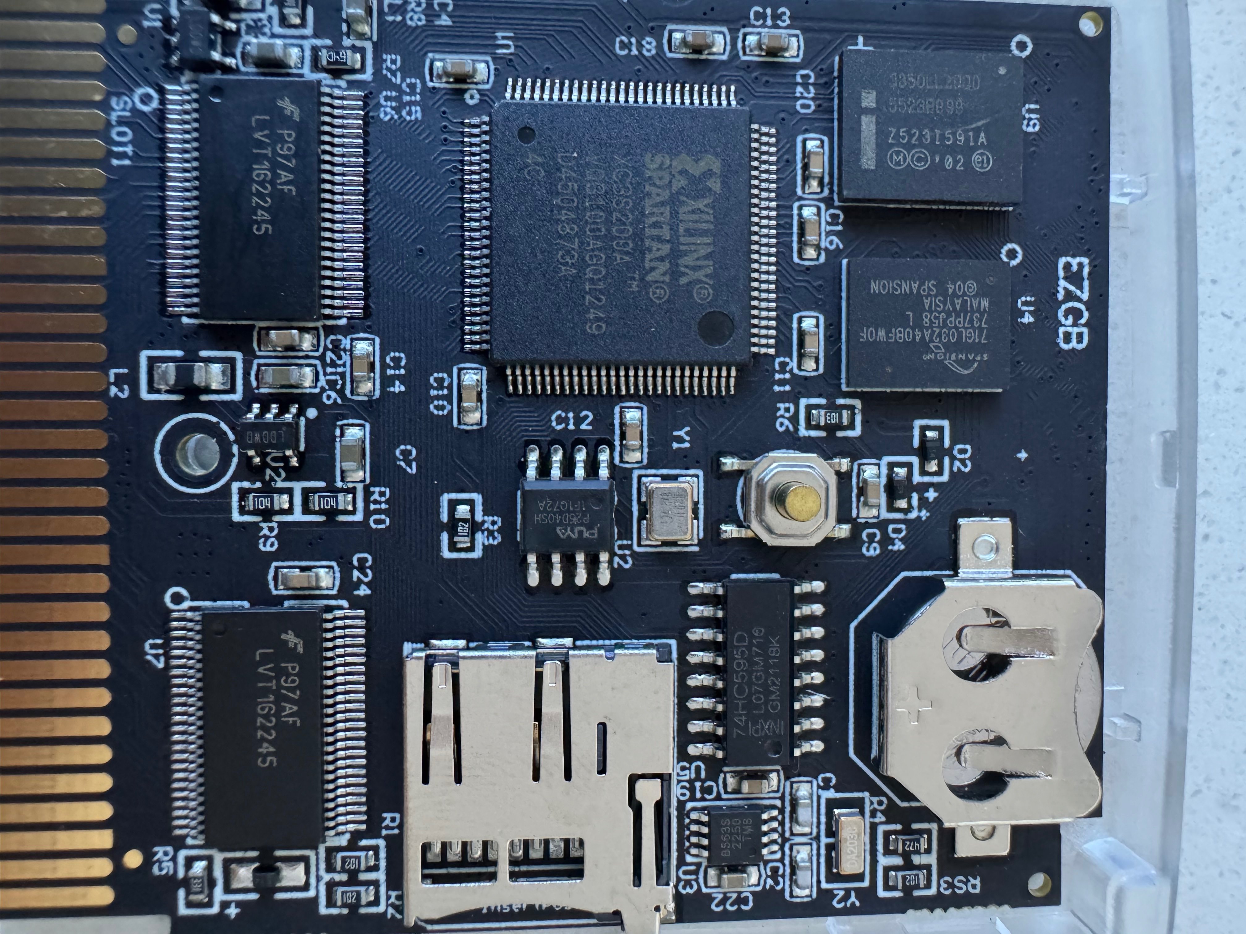

I previously thought, when I start a game, the device loads the ROM file from the SD card to the onboard flash memory (S71GL ic). But, according to the markings on mine, it's maybe not. Because I reckon the flash is in the U4 71GL032A40BFW0F, which is only 32 Mbits, not 64, but I can load a 64 Mbit ROM without any hassle.
I attached a photo of my card and a macro shot from the top-left BGA chip.

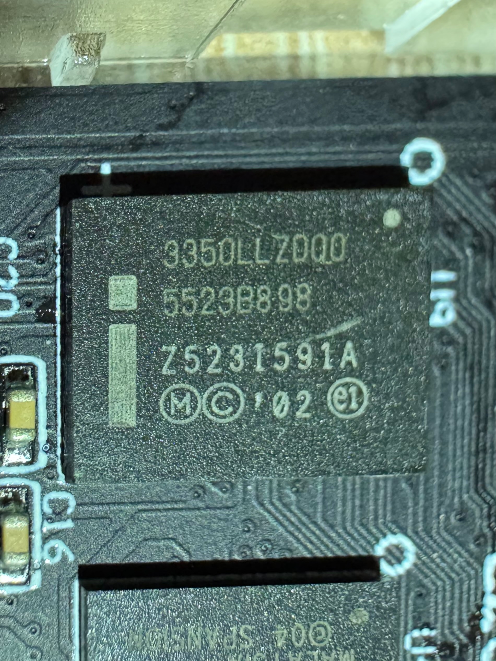

Anyone know what the purpose of the top-left chip (U9) is? I cannot find a datasheet for it (3350LLZDQ0 or 3350LLZDQO and maybe created by Intel?). Some sites describe it as SRAM, but the 71GL (U4) also contains 4MBit PSRAM.
The board also contains a second (and smaller) flash chip (U2 P25D40SH; right to the FPGA), which may contain the initial system and maybe the settings variable for auto-save tickle on the settings page.
The U3 8563S (up from the sd slot) will be the RTC, and the two bottom chips (U6 and U7, 74LVT162245) will be the bus driver.
The U1 is a voltage regulator.
So, my question is, how can I load a 64 Mbit ROM file, or how does this thing actually work?

It uses PSRAM or SRAM present in the S71 chip.
Marked 064 and 032 are mixed and used interchangeably, and there is no noticeable difference even if they are swapped.
ROM is loaded from a chip presumed to be an Intel chip.
Although the exact details are difficult to determine due to the lack of a datasheet, the Intel chip is likely an MCP chip configured with PSRAM and NOR flash.

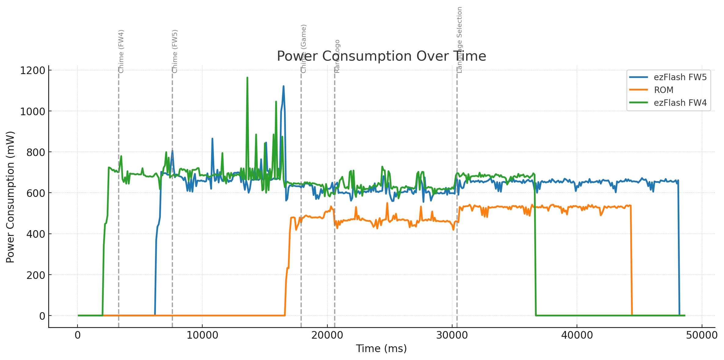

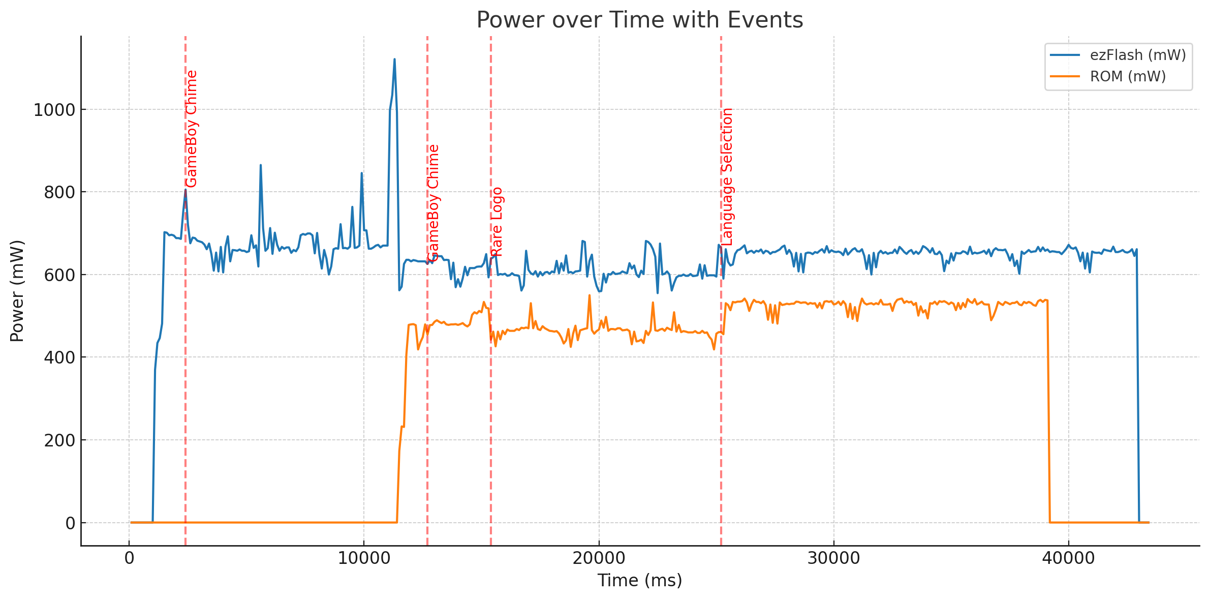

I've finished with the modding of my lab PSU, so I can now measure power usage with a PC. Here are the comparisons between the original Donkey Kong Country game cartridge versus the EZ-FLASH Junior when EZ-FLASH loads the game with the "start then A" combo. I tried to synchronise the charts as I could; to make better measurements, I need to figure out how to do this better.
The ROM cartridge has only one chime, and the EZ-FLASH has a big spike with nearly 1.1W usage when loading the ROM. My GBC has a Hispeedido 2.45 drop-in screen, and the brightness value was 8 from 15.
Anyone tried to downgrade an EZ-FLASH Junior, especially FW5 to FW4? In the future, I would like to do some more tests, with multiple brightness levels and with the OEM screen as well.
Edit: The firmware can be downgraded with the updater package, so I made a second graph, where the FW4 chart has been added. Loading a ROM with FW4 is even slower, and even more spikes are visible there. Overall, the power consumption in FW4 is higher than in FW5 when a ROM file is loading. The consumption when the game is running is nearly the same (below the error threshold).

A few things I can add from poking at the firmware and doing some hardware tests.
The thread's right that the game runs from U9's pSRAM, and I can confirm it's volatile: after loading a game, a quick power cycle reads the ROM back intact, but leave it unpowered a bit longer and the bytes fade to $FF (pull the cart and it's all $FF). So it genuinely runs from RAM, not flash, which is why it re-loads from SD every boot. That SD-to-pSRAM copy is what the ~1.1W load spike is.
The auto-save toggle and other settings aren't in the small SPI flash (U2). They live in a separate 512 KB battery-backed pSRAM (the pSRAM die inside U4), same place saves are kept, which is why a dead coin cell wipes settings and the RTC along with saves. U2 holds the FPGA bitstream, and the boot ROM looks like it's baked into that bitstream as block-RAM init rather than stored on its own.
What's weird is that between the two chips there's roughly 36 MB of NOR flash (4 MB in U4, 32 MB in U9) that the firmware never touches. I went through the kernel and the updater and nothing addresses it. U9's NOR shares the bus with the game pSRAM so it's probably wired to the FPGA, just unused. No idea if it's reachable without reverse engineering the bitstream.
