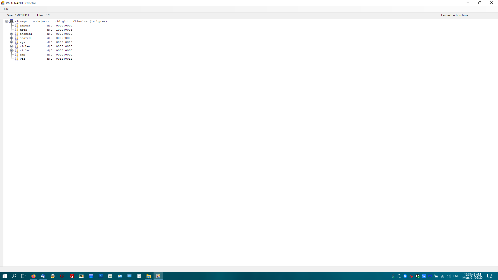

here's what it will look like:
you need the otp.bin from the same system in order to make changes or extract anything. it errors if it can't find that file. also, slcmpt and slc should be: 540,672KBs apiece.

here's what it will look like: View attachment 192481
