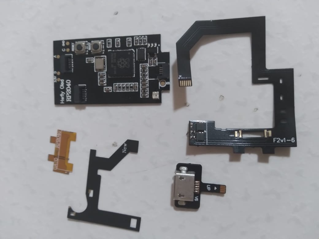

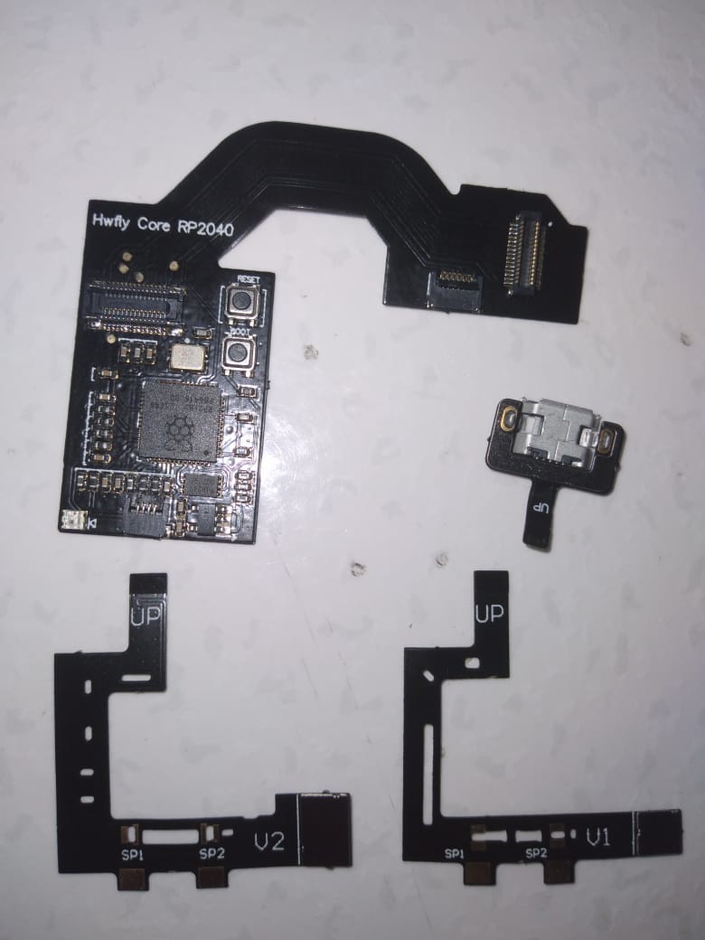

Hello! The chip has arrived (to the warehouse) and the agent took some photos
I tried to get the option for the Switch Lite... hopefully it is correct?
O1CN0133S0GO1HeexNsfjmE_!!53-fleamarket.heic
Since the listing of this chip I got is still up and I got pictures of the item (proof it really exists) I will send people the link via DM later tonight of where I got it.

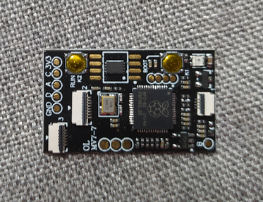

I've started to notice these custom PicoFly boards being made as well.
https://www.aliexpress.com/item/1005005514725775.html
I have a couple of these ordered and I'm looking forward to playing with them.

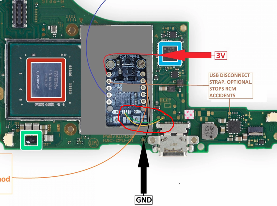

I'm super interested in that little + and - up top. Should be usb passthrough for programming / debugging over the switches usb c port.
I also managed to get my hands on one of the lite versions of these chips.

Got mine and successfully installed. Everything from flex cable to cut position on the aluminum shield is completely identical to HWfly.
I forgot to take a photo before installing the aluminum shield, but it looks very much the same as HWfly.
Photos are updated on #1.
I don't think it works like that - it's just the USB of the RP2040, to be soldered to its own USB connector once (for programming), and then removed before installation.
It looks like a similar setup to the trinket m0 which has the ability to be reprogrammed over the switches usb down the line. It's just these two wires that handle that afaik. I don't see why the same couldn't be possible with the rp2040

Interesting, I think I got a chip that's supposed to work on either OLED oror
The one I got works both for the OLED and Switch Lite but I will try to find one shaped like that since the installation of that one seems easier for a Lite. I might save the one I got for an OLED.

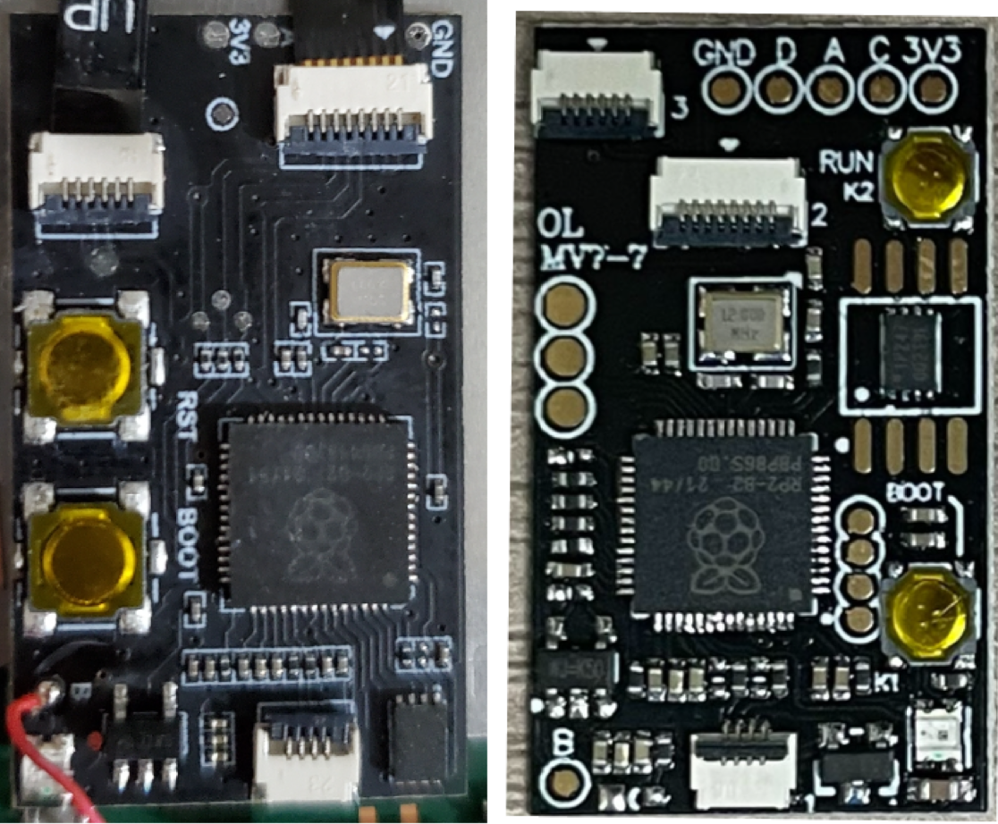

The board in 1st image does not seem to have any soldering pads available

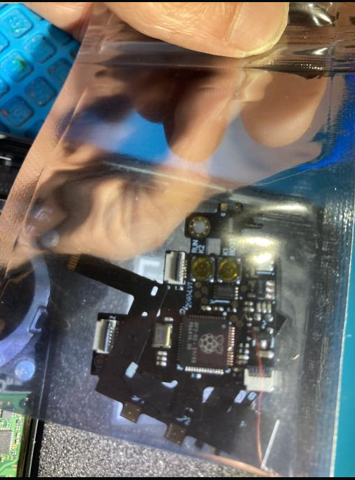

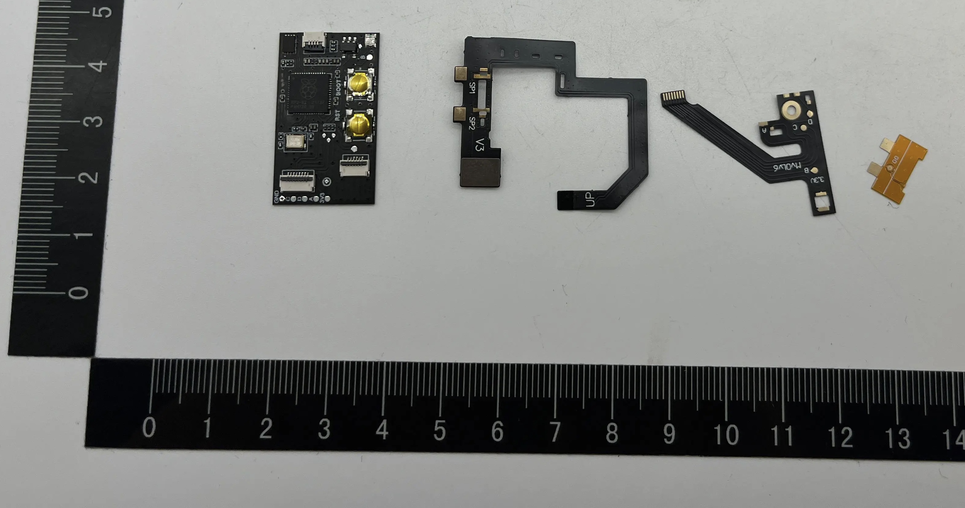

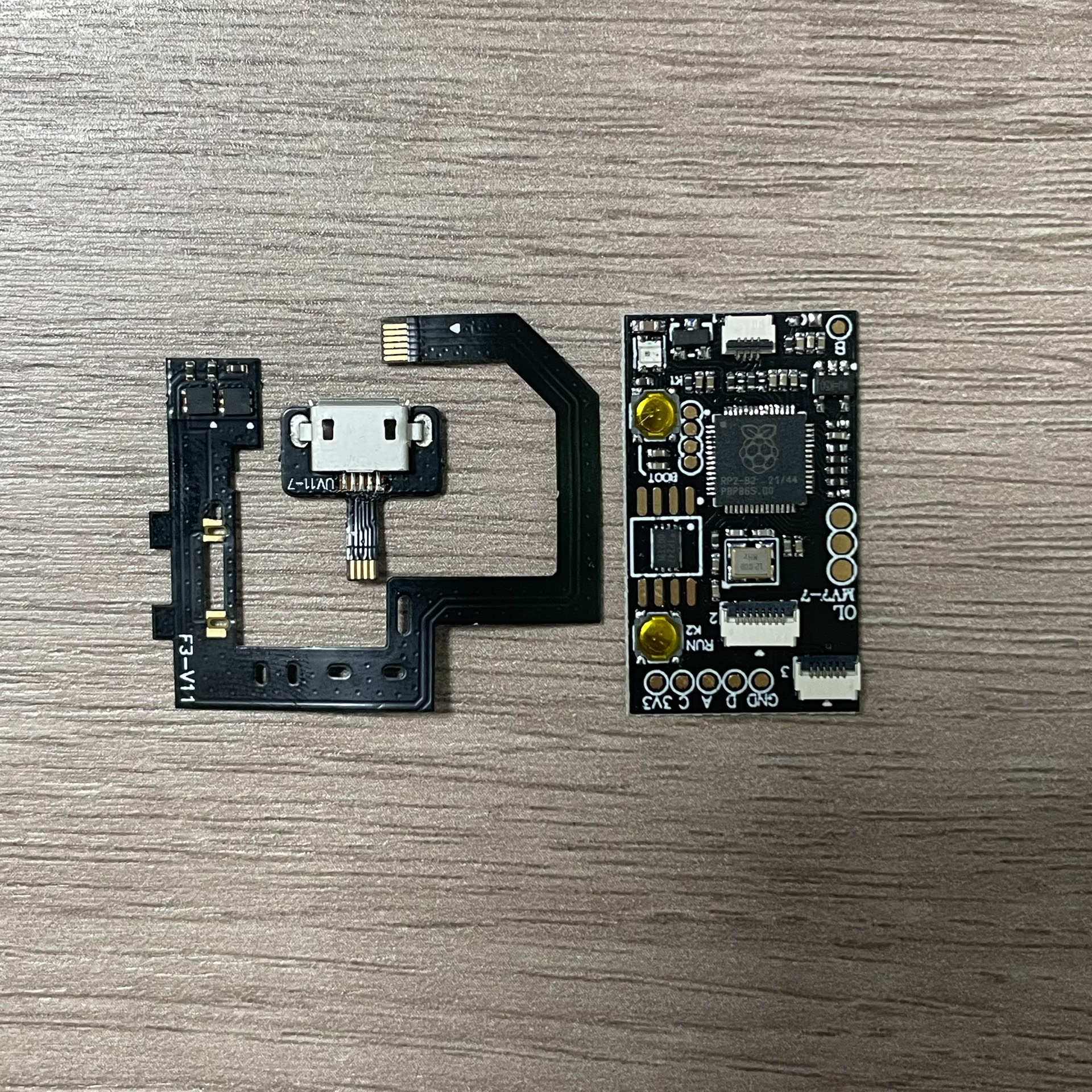

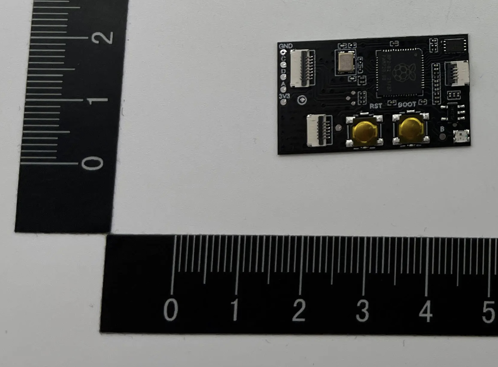

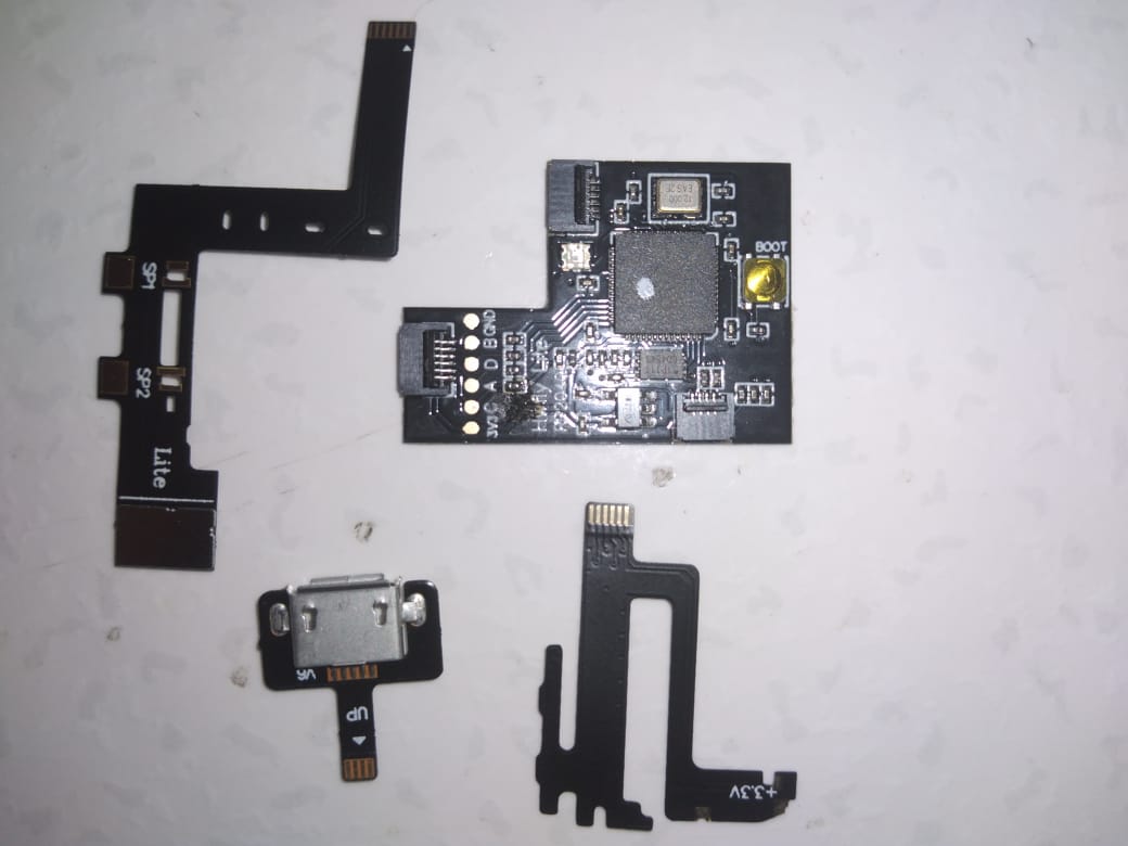

Here are QC pics I got from my agent when I ordered from a vendor.
I think I’m just missing the usb connector for upgrading the firmware right?
I asked for the OLED version.
the pads are behind the flex cable in the first pic.
i get mines last week,cant update via pc,so what for the buttons then?? boot boton?,we install one then in brand new oled,console start fine,we test like 5 times and everything was fine,after 5 successul booting,the console is dead,only black screen,chip only have solid blue light,and the screen show 2 times pink screen and now is totally dead,no show anything than black screen,we try everything and cant fix it,this never happen with the old real hwfly!
pink screen is usually a damaged cmd resistor on oled.
Check that the resistor measures 4.7k ohms
rp2040 will throw a slow emmc error if there's no 47ohm resistors on cmd clk and dat0.
maybe these boards are missing those added resistors? check the rp2040 install pdf. slow emmc will happen if you don't add resistors to those lines.
