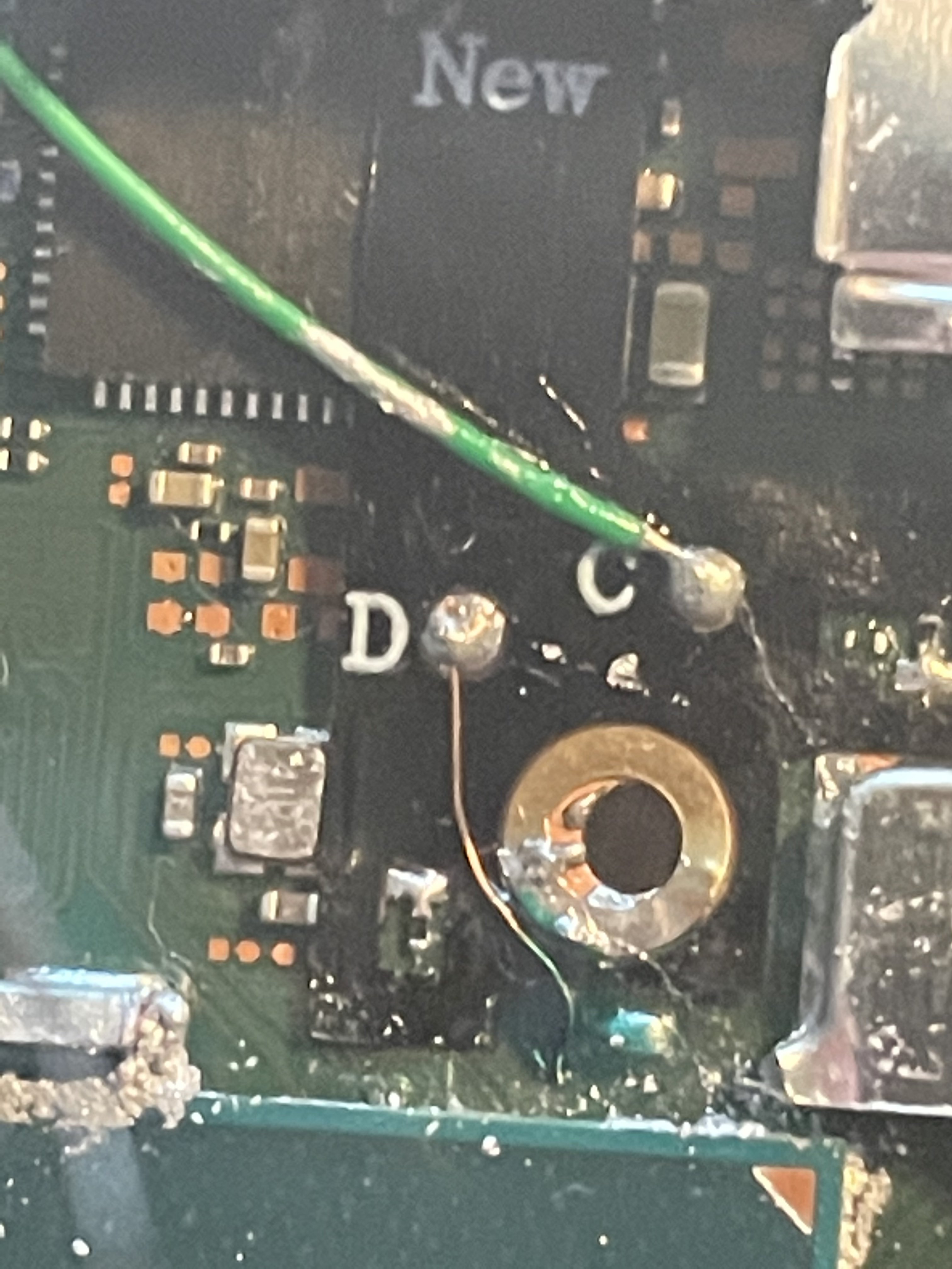

Anyways! Close up pics of CLk point. Reading is low. And you need to trim all your wires. Too much excess which can cause problems
Most likely killed point clk

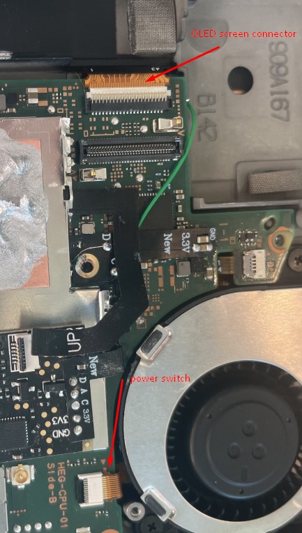

Just few questions to sync: when you press the power button, nothing happens, like neither the fan spins? Have you tried disconnecting the 3.3V line to see if the Switch turns on and boots to OFW?
EDIT: @tvchip just noted on the second photo that you posted, that screen connector is not fully inserted.
Hey, yeah with the 3.3V disconnected it does not boot ofw. No fans spinning, no lights, nothing at all. For clarification, is the screen connector the ribbon cable just below the fan? I think see it is not fully connected in the photo as well. Will try properly connecting it and trying another boot up.
The one that you're referring is the power button ribbon cable, which actually does not seem fully inserted as well, let's hope it's the culprit for "no power at all" issue. Check the image below for reference.
So, first remove all the thermal paste with IPA, keep the HWFLY disconnected from 3.3V, make sure that the power and screen ribbon are well inserted and try to power it on again, if it's for short time you don't need thermal paste.
Proceed with much care with the screen connector (the one soldered to the board) while inserting the ribbon cable, it's very fragile and can break if the ribbon cable is not completely aligned (straight) when inserted.

There's a via under CLK, is there not? Point D. If you scraped too much, you could have easily broken the via. The shop adding a wire to the trace might get you a somewhat acceptable reading to the X1, but that doesn't mean the X1 is connecting to what it NEEDS to connect to, from that point.
My first attempt at a mod did just that (my microscope was too small/crappy). But I did get lights on my chip with it, I was just never able to train, and now it's a brick. Wish I knew where the other end of point D went, so I could try to jumper it...
There's no point diagnosing any of the connections unless the 3v3 is actually there. The only thing to focus on now is figuring out why that isn't the case.
Measure resistance to ground from the 3v3 point. If there's a short, figure out where it is and solve that. If there's no short, but no 3v3 output on the output of the max77801etp chip that generates the 3v3, then look at the input of that chip.
Regarding the CLK point: the via under CLK goes through 3 layers. If it's not shorted to ground, and gets a reading, it's very likely to be fine.
