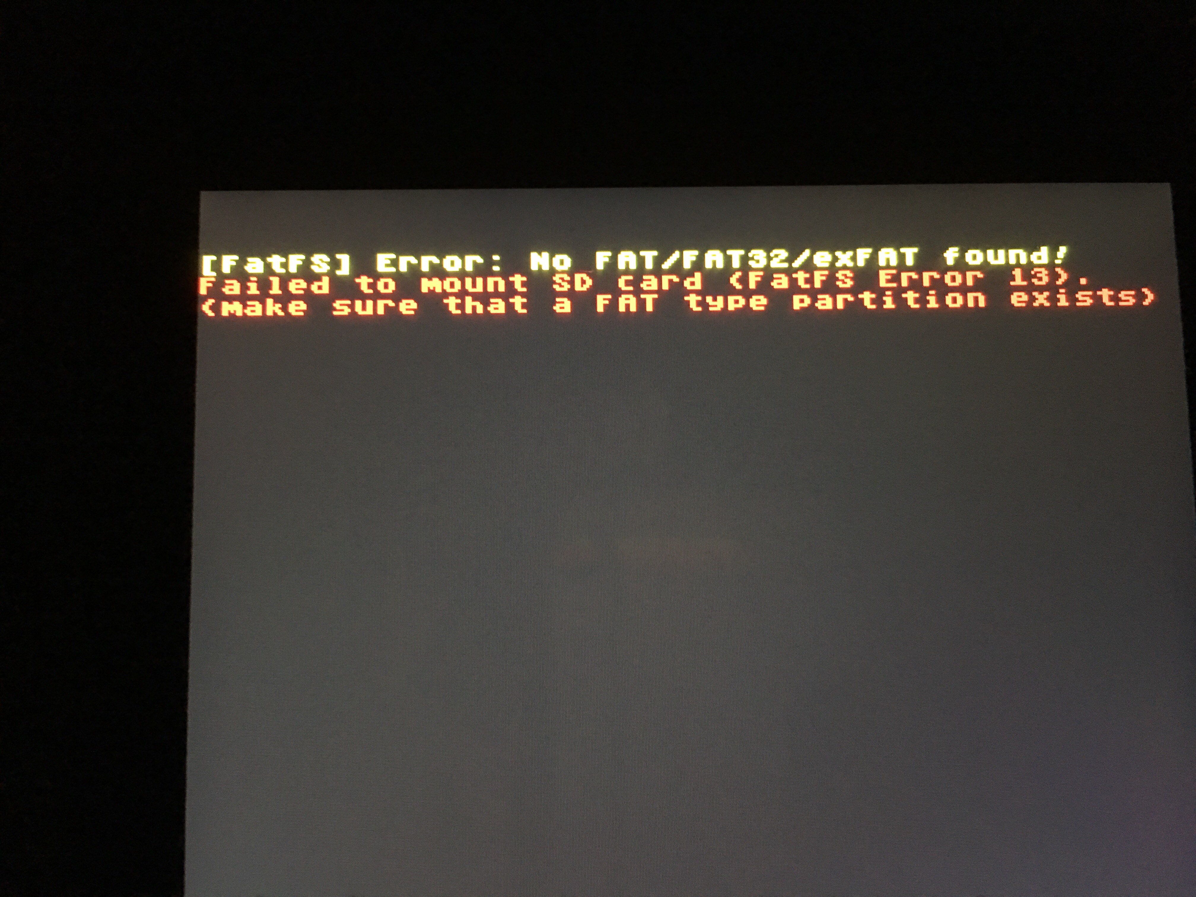

Tonight when I try to inject hekate v3.2 payload, it successes. When I try to print fs info or dump emmc info to SD card, it failed to mount the sd card.
So I think my switch is not the "newer switch" that can't Jailbre*k. And not the sx pro hardware problem.
Maybe I should continue to find a correct sd card formater,or wait someone who find the reason why sd card failed to mount in rcm.

Update:
I download a hekate v3.2 source code and recompile it with some debug code. And see my SDcard failed in init process. The reason why init failed is the query command (CMD6) response data judgement failed in setting SD card to high speed (the sd card init process before is fine, this is the very last of SD card init process, before the fat32/exfat system mount ). So it has nothing to do with the SD card format. It is the incapability between SD card and hekate sd card driver(and SX OS).
A fast way to avoid this problem is to use a "correct" sd card to meet the sd card driver, but it needs to try.
code:
int _sd_storage_enable_highspeed(sdmmc_storage_t *storage, u32 hs_type, u8 *buf)
if (!_sd_storage_switch(storage, buf, SD_SWITCH_CHECK, 0, hs_type))
return 0;
u32 type_out = buf[16] & 0xF;
if (type_out != hs_type) //FAILED HERE
return 0;
if ((((u16)buf[0] << 8) | buf[1]) < 0x320)
if (!_sd_storage_switch(storage, buf, SD_SWITCH_SET, 0, hs_type))
return 0;
if (type_out != (buf[16] & 0xF))
return 0;
return 1;
