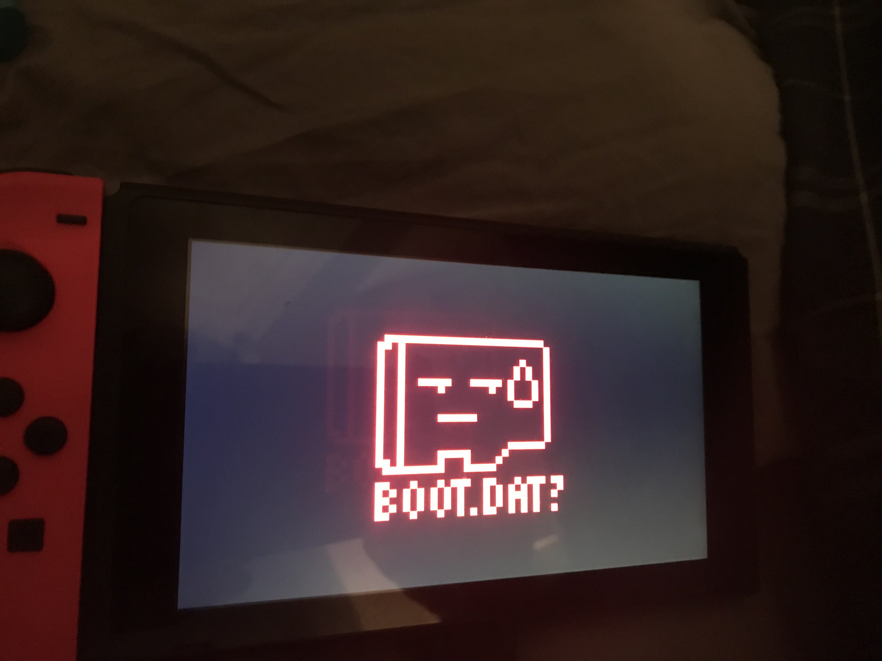

I also have the exact same issue and never used hekate as a last resort I even ordered and replaced the sd reader in the switch still not both am completely fucked
my switch was first on 4.1 and after a few hours of issues I updated to 5.1 with exfat support and nothing worked. I also tired a 16gb card in fat32 and that didn't work. I tried a total of 5 sd cards. as I said I had to buy another switch and everything works perfectly including all 5 sd cards. So there's either a certain type of switch that's incomplatible with sx-os payloads/hekate or hekate could cause this in rare occasions. Until I hear of somebody getting the boot.dat? error without having tried hekate i'm going to assume Hekate has something to do with it but so far the few people that have reported this issue have all tried hekate.
Never used hekate sx os payload was booting fine up to a week again where I can’t load sxos I am completely out of ideas even put a new sd card reader in the switch still nothing

"Btw, I found long ago what these "mysterious" sd card readers are.
Basically the connector is not fully seated.
It's common when you change the shell for example. There's a reason the connector has that black padding on top of it.
So, this makes both the controller and the card to fallback to 1bit data bus width. let's call that mode SDSC, aka sd card v1.0.
I never added SDSC support to hekate and that's the reason it does not work.
This will remain like this for 2 reasons.
First, SDSC cards do not exist anymore (or it's quite difficult to find this ancient tech).
Second, it's the only way to identify this problem. And it's important to identify it because the bus speed is 4 times lower in these cases.
Imagine having a UHS-I U3 card and the speed would be like a crappy card."
This quote explain the possible issue. try re-seating the connector.

I tried this didn’t work for me I am fresh out of ideas
SUCCESS!!!! i (finally) received the Sd reader today marked with TS HF.. and as predicted.. no more Boot.dat error! its safe to say im one happy bunny!
if you do search these order a few.. i ordered 2 and the seller sent me one marked TS HF and one marked CA HF.... the CA HF still gives the error.. im not gonna bother sending it back or anything because its not worth the hassle.. i can sell my second modded switch now and crack on with business! happy days!
hope this helps .. yall have a nice day

To fix your issue as I had the same and for all people looking to fix;
failed to init sd card for CFW and BOOT.DAT? for sxos , replacing the sd card adapter in the switch will solve your issue, you do not have to buy another switch like some people have done! The adapter either becomes shorted out or the surface mount capacitor dies.
Stick to using FTP for transfer of files rather than removing the sd card every time like I did.
This is now solved PEACE!

Could sd reader still be the issue if it works fine in official firmware just not custom firmware
yes, that's exactly the issue. dunno if you read but I would have never known the sd reader was faulty if I had not used cfw. try re-seating the sd card reader or replacing it altogether.
I’ve ordered one just waiting for it .it’s pretty much my last resort tried absolutely everything else ...
