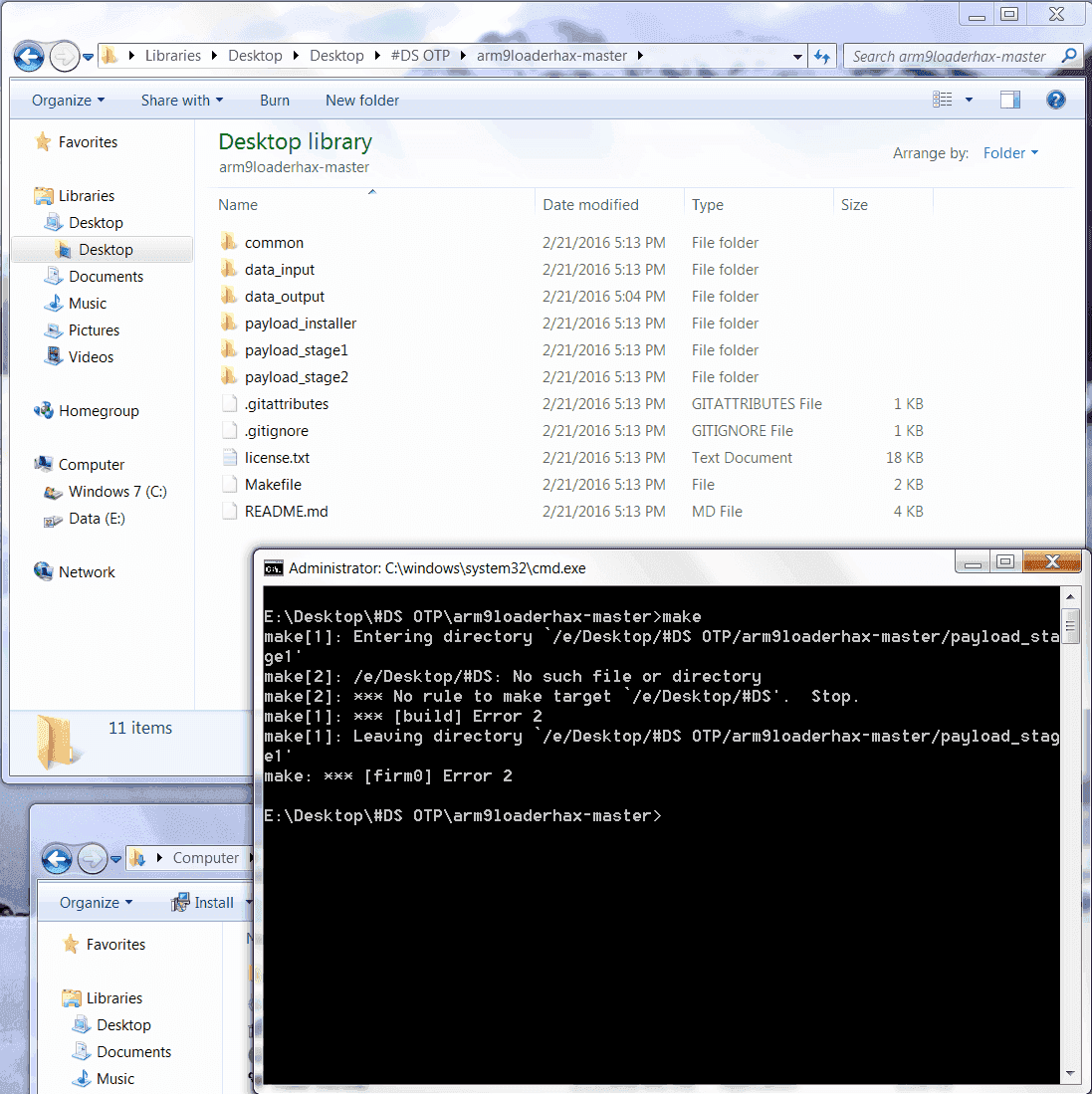

I keep getting an "error 2" while trying to compile. Could somebody explain why please?

You know... when you install python, there is a checkbox to add it to your path.
devkitpro can't handle spaces in your path. You should not only use a path without spaces, but also move the devkitpro related entries in your path to the BEGINNING of your path (because it doesn't like "()" either.... as in "Program Files (x86)".
