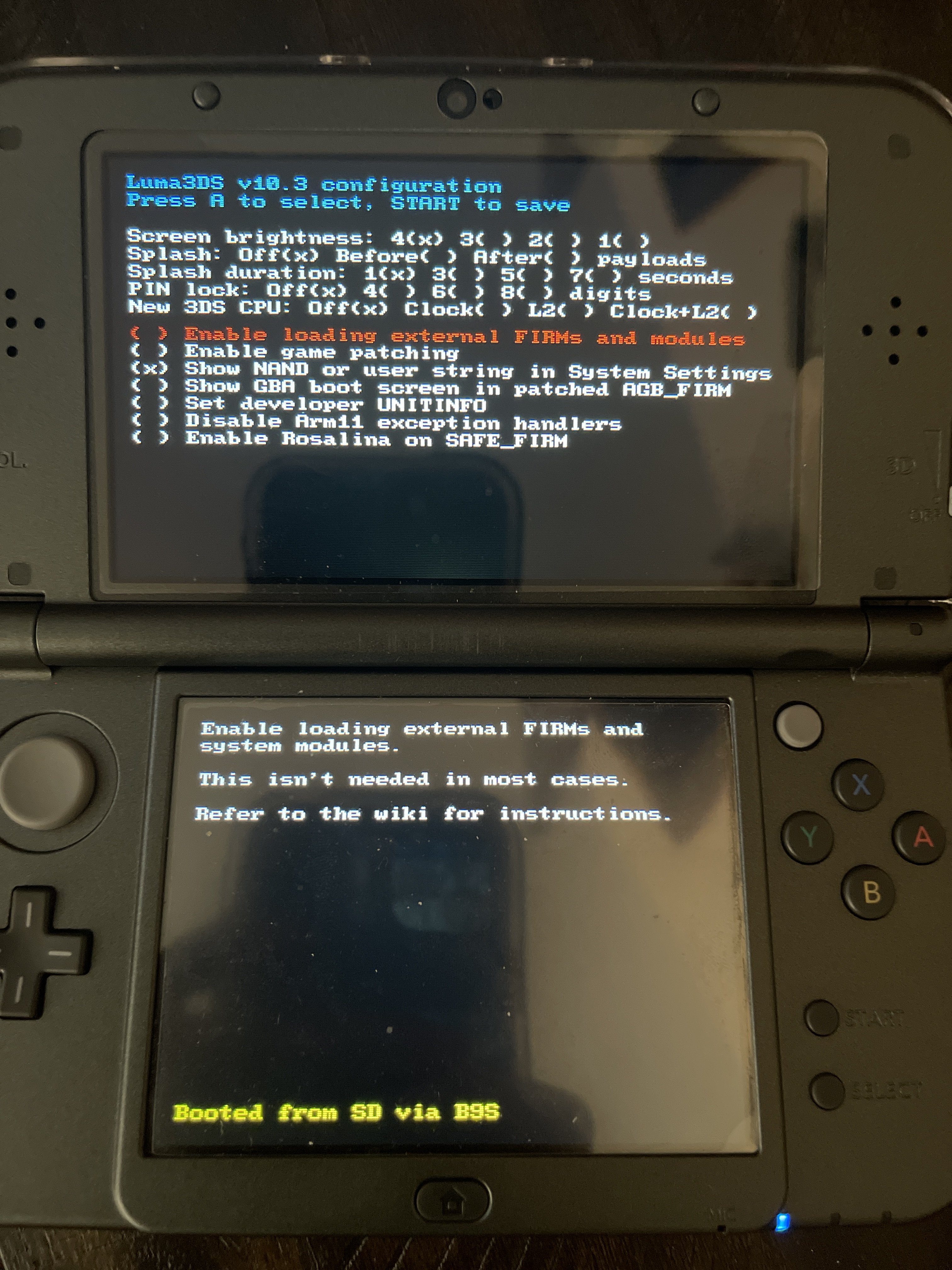

Sorry for not responding sooner I’ve given up lol I attached picture of luma start up is there anyone who I could pay to unbrick it for me or can I buy a motherboard and swap them. 3ds is I’m great condition pretty much brand new which is why I wanna save it lol

@Jar5 the pic you've attached above of Luma3DS menu, is made when the system is booted with the sd card inserted. I told you to take one when the sd is not inserted...
