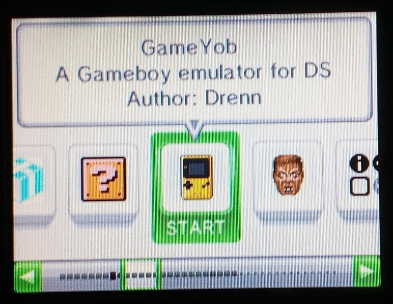

I've encountered a problem trying to install DSi homebrew onto the main menu. The app will install and launch like it should, but the game icon and title will be blank. But not every app does this.
Works:
- DSiMenu++
- WoodDumper
- nds-hb-menu
White Boxes:
- Gameyob
- nesDS
- dsdoom
- TMFH
I've checked the files with ndstool and the banner checksums are correct, so idk what's wrong.
Is there a known solution to this problem?

I found exactly what I was looking for: these apps were made with an out-of-date ndstool.
github.com/devkitPro/ndstool/issues/3
"It seems that Launcher expects all NAND based DSiWare [...] to have 0x23C0 reserved for the icon. 0x840 sized icons can be used, but if the DSi extended binaries end up in that 0x23C0 region (as ndstool and libnds currently do with SRLs built from it) then Launcher considers the icon invalid."
Ndstool was updated last march to accommodate this. Apparently, updating libnds with devkitProUpdater does not update ndstool. After compiling the newest version of ndstool I can now compile homebrew with working icons.
For anyone who wants it, I've included a zip with my compiled versions of ndstool (windows), gameyob, nesDS, and dsdoom. (For dsdoom put your game files in /usr/share/games/doom/)
