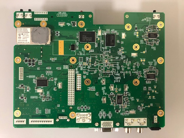

Has anyone gotten homebrew software running on the arcade model of the Wii (RVA-001) that Capcom used in Japanese arcades?
A lot of the hardware is the same as the retail Wii, but it outputs in VGA and the controls are JVS via USB.
I'd like to extract the software from the NAND as it may be undumped.

Wow ! They used the older/larger TF card as storage & apps ?
I believe the software is stored in a NAND flash memory chip on the underside of the motherboard not visible in that picture.
It has the ability to accept updates through the SD slot but I'm not sure any games used it.

I think that would be the attack vector to load homebrew off of
That's how my Wii was hacked years ago, and I was using a USB HDD for storage. Now it looks like it can be loaded via USB so I will have to try that as well.
It would have to be SMD & non-removable/changeable ?
I also hate it when they remove IC IDs :(
Yeah, I believe it is the same surface mounted chip the Wii used for internal memory. The top middle black IC here.

It's more like the main store is a NAND just like the retail Wii, you can try to use the hardware methods to dump the original NAND before do anything to the board.
Wanikoko could help you with the hacking of that console, it must be a normal one with a tweaked firmware to use the the extra hardware and the USB (JVS) controllers

Someone on Dolphin's IRC was trying to extract the NAND but I don't know if they were successful. The issue's you can't easily gain homebrew access on it because the methods to mod a Wii are closed off because you can't trigger an exploit. The key to decrypt the NAND is only accessible with software. You can't use BlueBomb either since to exploit it you would have to generate a small binary called stage0 which is made with the game DOL. This would be hard to mod unless you can figure that out

I'd like to dump the software for preservation. I don't know know if anyone could make it playable considering the control scheme, but there may be some cool assets that Nintendo fans could extract.
I was hoping that it would behave like a retail Wii where you could revert back to a previous image of the flash memory.
Thank you for this information. I was hoping one of the newer tools could boot to an app that would circumvent the system's OS, but that doesn't seem to be the case.
I believe Tatsunoko vs Capcom has been dumped, so I wonder if there is a unique problem with extracting this game.
Apparently the SD card slot is used to load both updates and extra data if 512MB wasn't enough. According to the internal documents from the gigaleak the arcade games are stored as 512 megabyte wads. The same gigaleak also has the cryptographic keys needed to sign packages for the 5 arcade developers Nintendo intended to sign on for this arcade board. If you have no hangups about using leaked internal keys to sign a homebrew loader that might be the way to go.
Isn't this Wii arcade version different from the Wii disc version?
The arcade board uses JVS controls so I don't think it would work if you installed it on a retail Wii, although some enterprising hacker could probably make a gecko code to add GameCube or Wii controls.

I talked with someone that can dump it by taking off the NAND and then flash a debug BootMii image to it, then put it back on the console to dump NAND and keys. I didn't think of doing this, you could still try to do it the way I mentioned before but this is more straightforward. @ProbablyBobably... Check your inbox

Just read this part now, the only way I can see you can dump it is with the trick I mentioned. BlueBomb creates this file to exploit it that reads part of the DOL and creates a stage0 file with an address, however it would be trivial to brute force that value (since you don't have the DOL) because even if you get it to exploit, there's not a guarantee you can install BootMii to it, plus you will have modified the NAND. This dude's been able to dump development hardware and is currently talking to the owner of Tatsunoko vs Capcom hardware to get a dump. He's got good tools to do this kind of thing and can give it back to you when it's dumped, and him and I really want to do it for you
