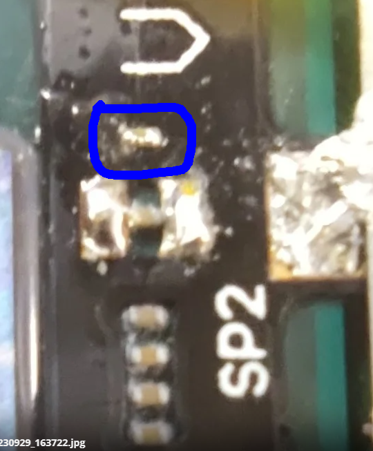

That's right, my switch didn't boot, didn't do anything, black screen and the new2040plus didn't show any light. I try to connect it to the PC but I can't get into the chip, it only shows a blue light and flashes yellow, then it turns off. I was hoping to be able to flash some firmware that would boot the switch. What would be my next step to solve all this? What would you do? Thank you very much for your answers.
That looks bridged from here , little flux and tap it with solder iron

Long flashes , short flashes ?
Blue light and yelow light is the latest FW for RP2040. Check your shorted capacitor where it says V1
