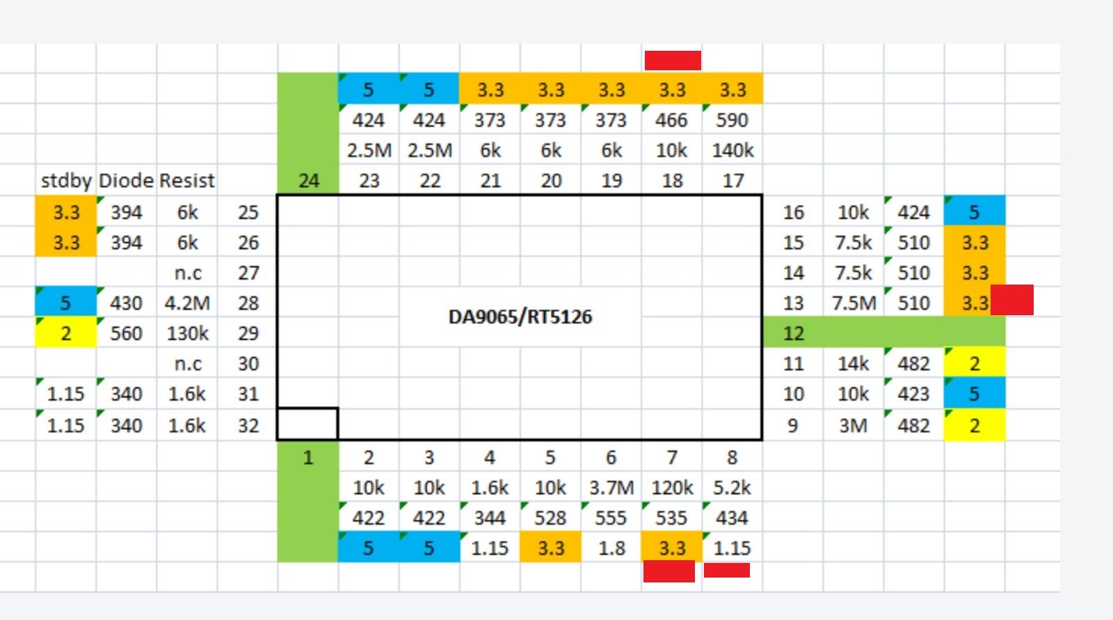

Hi, I've already replaced this IC and I'm still getting the same readings; the voltages marked in red are missing. Do you know if those voltages are generated by the southbridge?

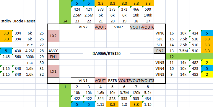

The PMIC chip is generating the missing PG2 voltages if the pin 13 (EN2) is set high by the southbridge.
Usually this EN2 is pulled low if an error is detected.

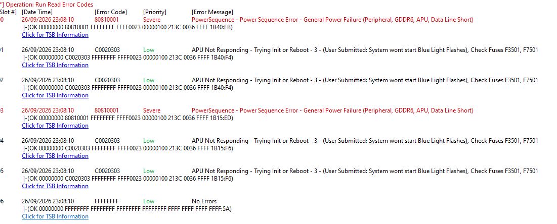

I would check the UART codes.
26/09/2026 23:08:10 80810001 Severe PowerSequence - Power Sequence Error - General Power Failure (Peripheral, GDDR6, APU, Data Line Short)
|-(OK 00000000 80810001 FFFFFFFF FFFF0023 00000100 213C 0036 FFFF 1B15:ED)
That's the UART code.
