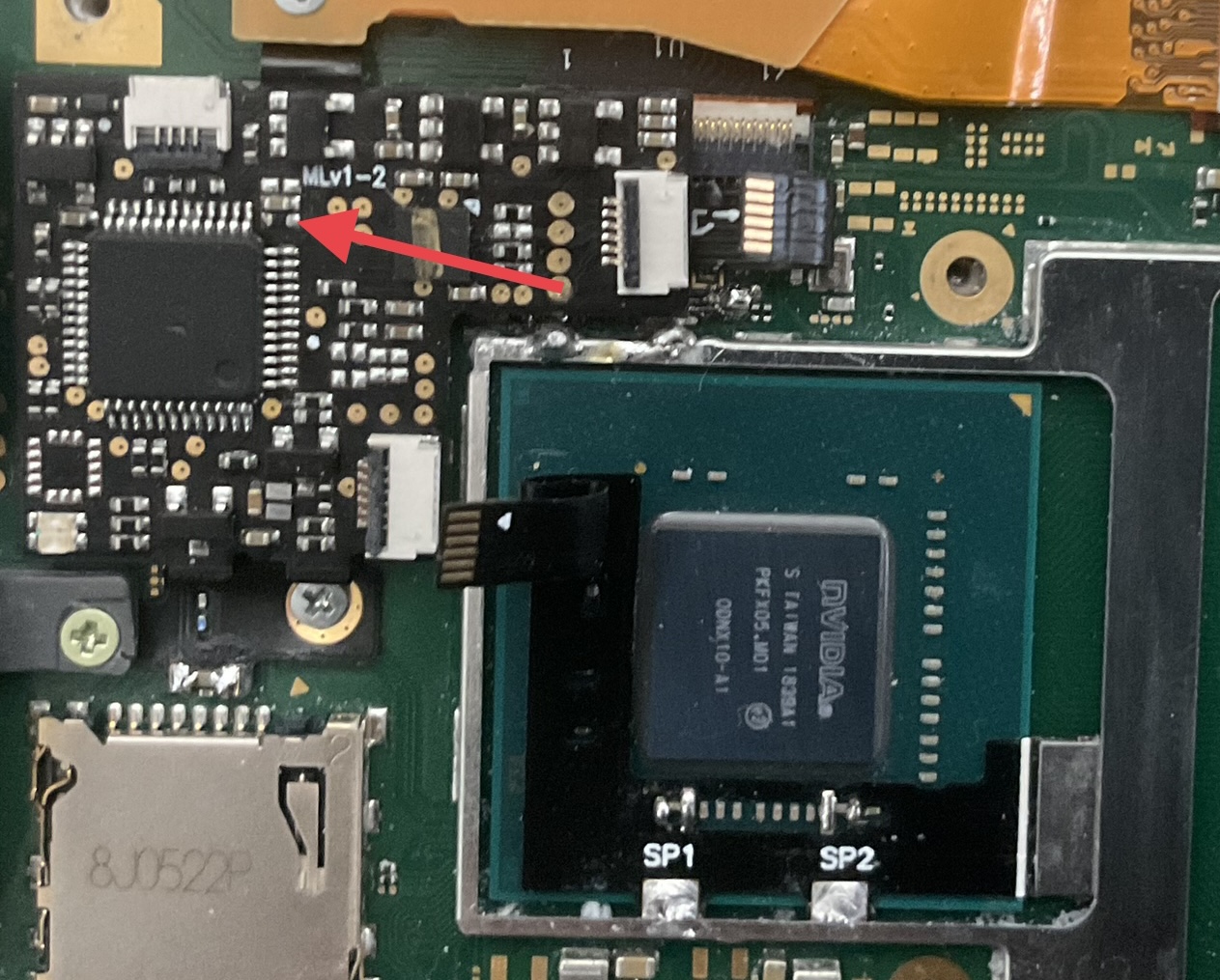

can anyone help me and check for continuity on an hwfly v4.1 ... can you check if RST pad has continuity with the point I marked with an arrow in pic? or any other point around that area?
thanks

I’ve got a V5 sitting on my desk right now and it looks virtually identical to your V4.1.
I’m reading 2 ohms between those two points. Are you looking for an alt RST point?

hello thanks for reply ... yes I have an hwfly lite with lifted RST pad and need an alternative point to solder the RST cable on ... any idea ? thanks so much
even if 2 ohm are so low that could be probably be considered as zero ... at potentially that is the correct point
But that close together, it should see zero. I still have some time to probe around…let me see what I can find.

ehehe was not my fault I received the oled including hwfly damaged to be repaired... I am good at smd and microsoldering etc. just needed an alternative point to solder the RST to.
Reactions: binkinator
hello mate you are the man! soldered RTS to that resistor and the hwfly is working great! you deserve a coffee whenever you will come to Italy :)
