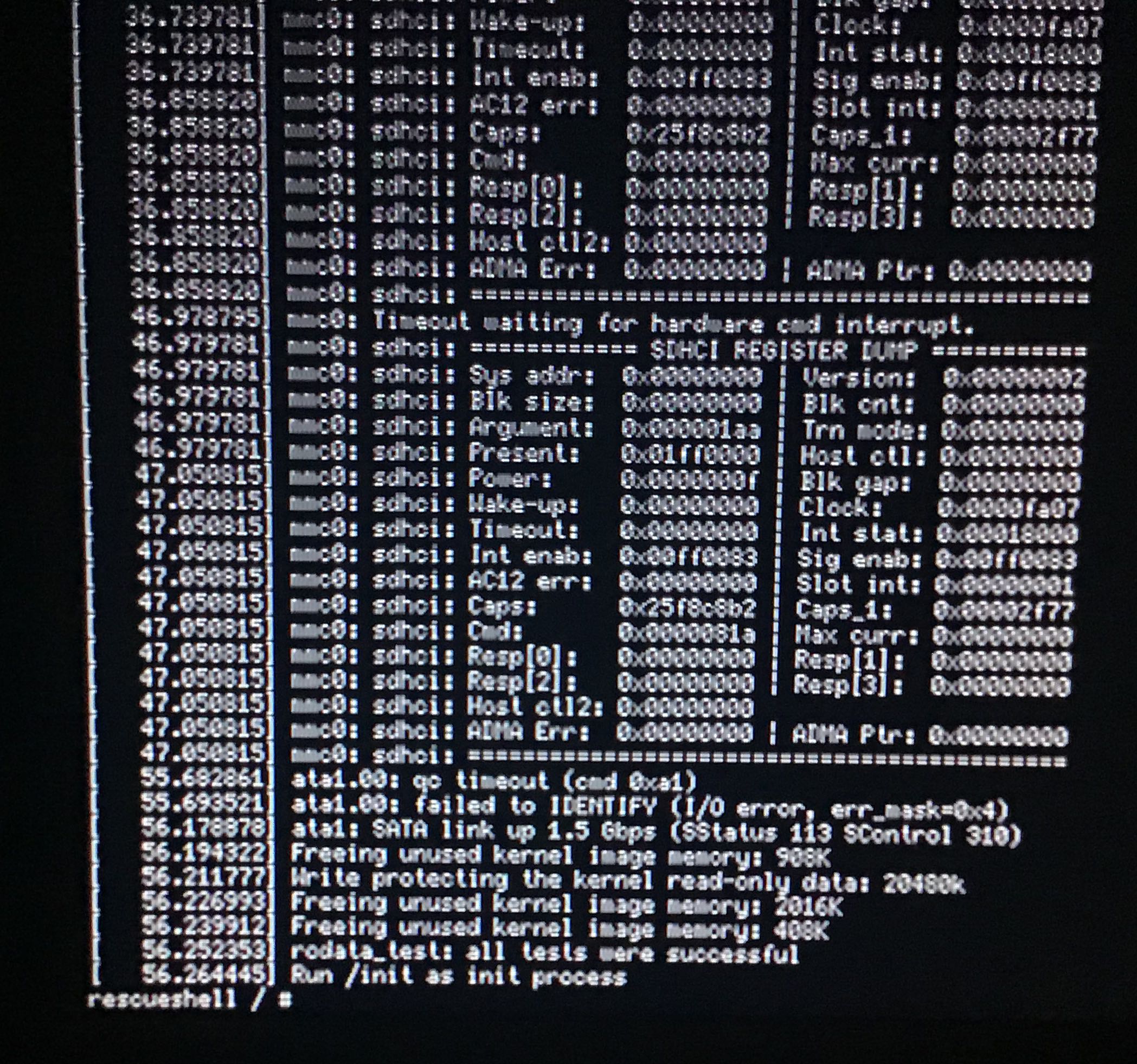

Anyone help, I also have slim CUH-2015A model (Uncharted4). Here's the message I get when booting from usb linux, I press one key and PS4 turns off.
