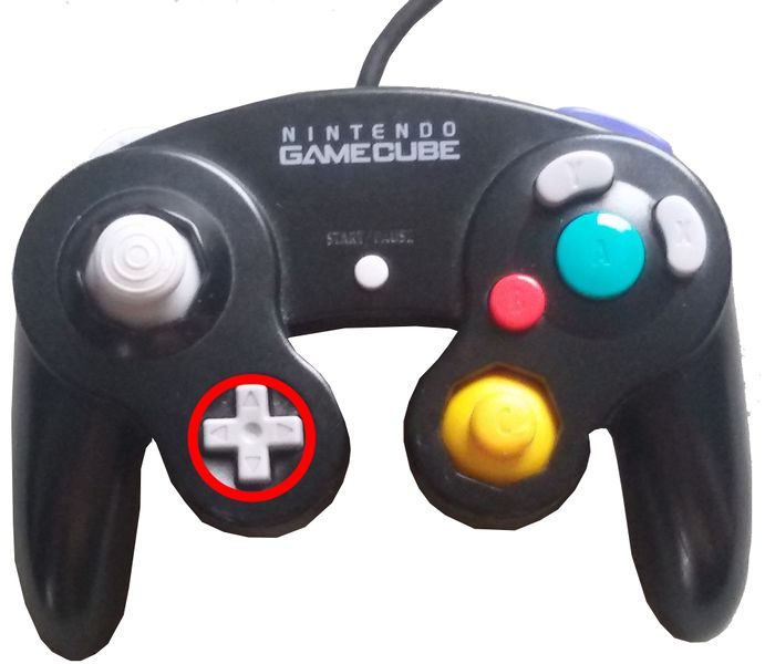

To broken for making the SaveMii "Recovery do it yourself Dongle ?
Prepare GameCube Controller
If it is an official controller, it must first be unscrewed. This step may be skipped on 3rd party controllers.
Screw your GameCube Controller with the Tri-Wing Screwdriver, making sure not to misplace the screws. If you have removed all the screws, carefully remove the controller's rear panel and remove all screws from the controller's motherboard, taking care to put them back where you find them.
When all screws are removed, you can now remove the board of the controller from the case. When removing the board, make sure that the individual rubber pads on the buttons can still stick to it.
All you have to do now is hold the board with the connection cable in your hand - take the Pad of the D-Pad and place it on the motherboard where the D-Pad was.
Run SaveMiiFrii
- Plug the controller into the fourth port on the Wii console
- Turn on the Wii and hold all buttons of the D-pad pressed simultaneously (or on the rubber where the D-pad was)
- The screen should remain black and (depending on the menu) show the version number of the system menu at the bottom right
- Insert a disc with a newer version of the Wii system menu than the currently installed version and the Wii should update from the disc
