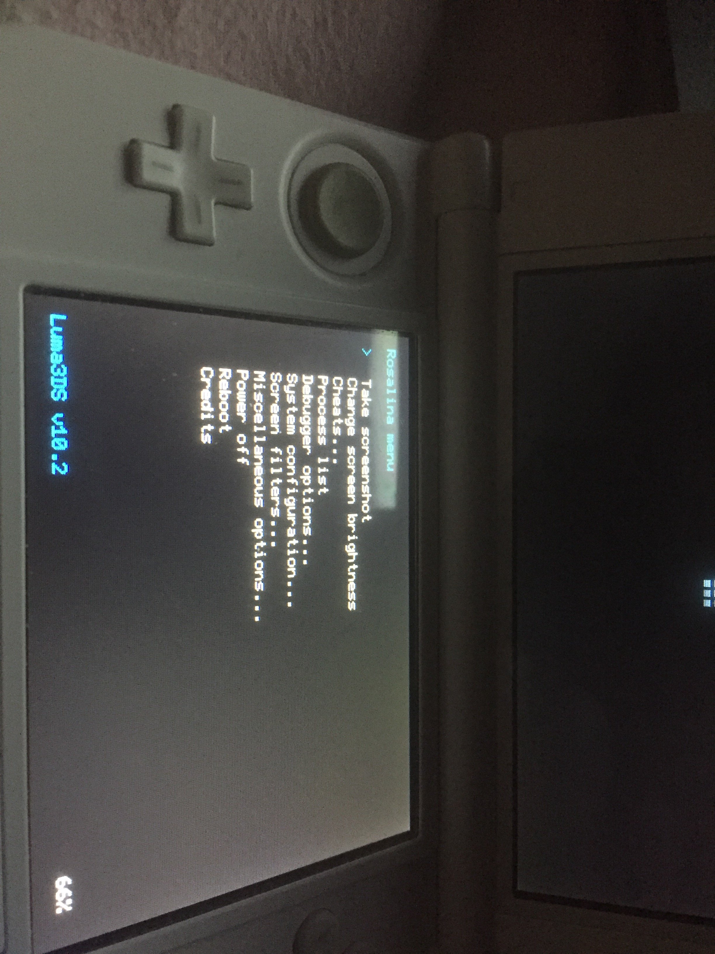

I am in the rosalina menu. I only get into Homebrew Launcher, I can't open it. I also tried to find in Miscellaneous options, there is no homebrew in there ???
Oh? The o3DSXL finally boots to HOME Menu?
You switched the sdmc:/boot.firm back to Luma3DS v10.2, right?

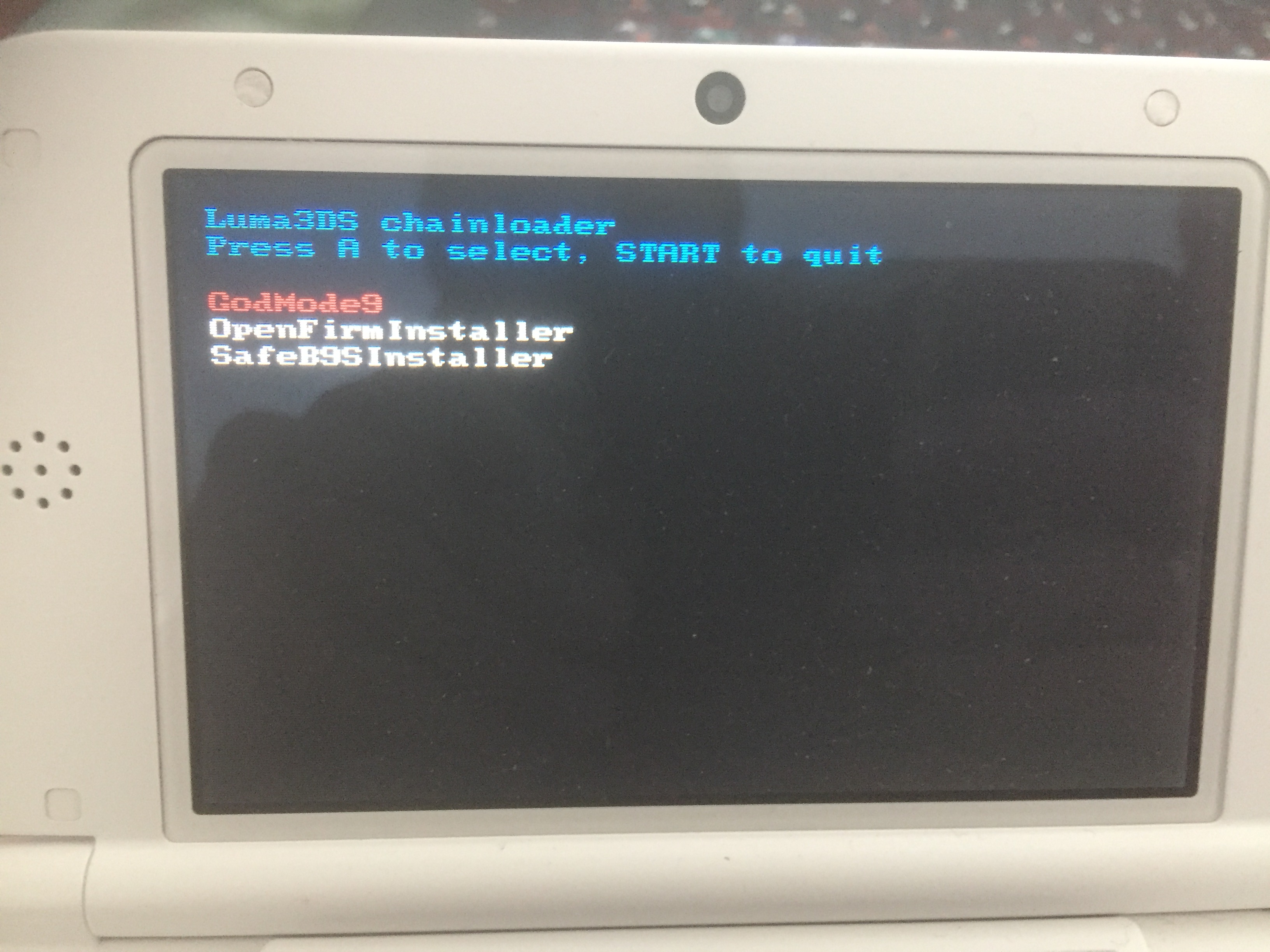

Are you able to boot GodMode9 through Luma3DS chainloader?
  1. sdmc:/luma/payloads/
    • GodMode9.firm
    • SafeB9SInstaller.firm
  2. Turn on o3DSXL → hold (START) button → GodMode9.
You can ignore the picture with the kitty and puppy in how to Rosalina menu inject Homebrew launcher to a system title.

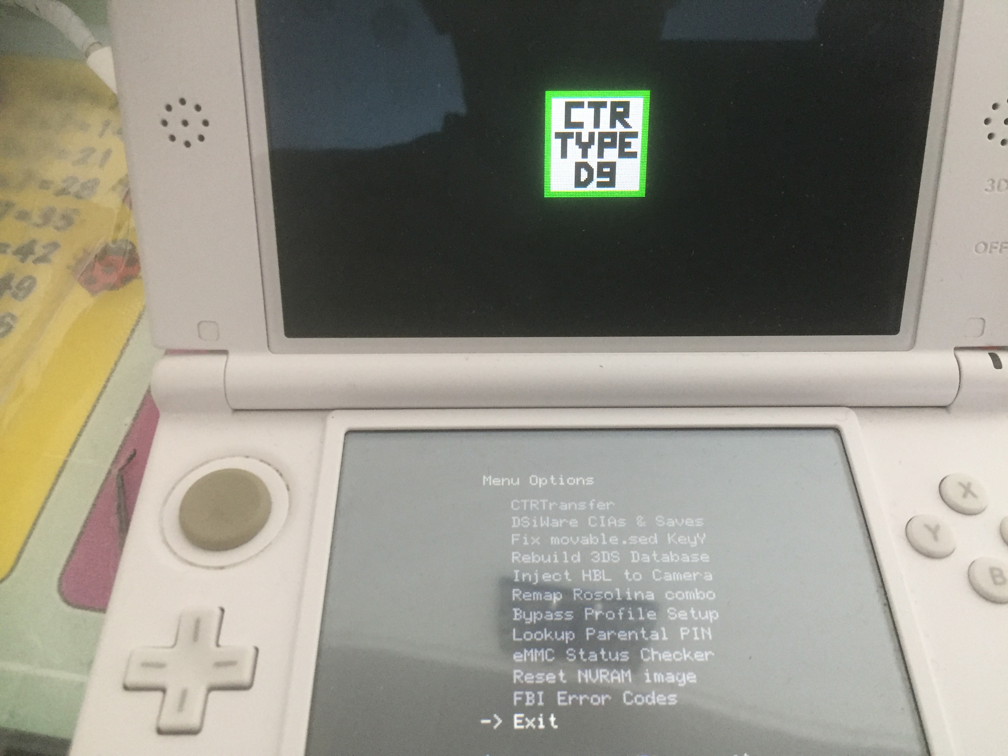

  1. GodMode9 → (HOME) button → Scripts...CTRTransfer (Type D9)Inject HBL to Camera.
  2. Exit → press (START) button to exit GodMode9 → HOME Menu → Nintendo 3DS Camera
  3. Homebrew Launcher; continue at step 12.

Wenn Sie jeden Schritt bis Abschnitt III auf 'Setup abschließen' befolgt haben und nicht auf Homebrew zugreifen können, benötigen Sie meines Erachtens auch das Homebrew-Menü v2.2.0 von hier (laden Sie boot.3dsx herunter und legen Sie es auf Ihrem SD Stammverzeichnis. Ich habe keine Ahnung, warum der Leitfaden es nicht mehr erwähnt.

If you've followed every step until Section III of Finalizing Setup and are not able to access homebrew, then I believe you also need Homebrew Menu v2.2.0 from here (download the boot.3dsx and put it on your SD root). I have no idea why the guide no longer mentions it.
After putting it on your SD card, do the following:
1. Open Download Play
2. Press L + Down + Select
3. Go to 'Miscellaneous Options'
4. Choose "Switch the hb. title to the current app."
5. Press B 3 times
6. Press Home and close Download Play
7. Re-open Download Play

CTRTransfer (Type D9) was supposed to automatically Rosalina menu inject Homebrew Launcher to Nintendo 3DS Camera. The reason that failed the first time was because he replaced the sdmc:/boot.firm (Luma3DS) with GodMode9 renamed as the boot.firm. No Luma3DS means no sdmc:/luma/config.bin is made. Without the config.bin in place, the script won't edit the proper regional camera TitleID injection path.
Also, those who have trouble with the early preparation steps in the Instructions tend to have a hard time grasping how to Rosalina menu inject HBL to a system title. I hate to say it, but I rather have anyone who hasn't properly learned how to do so to go back to the script and let the Inject HBL to Camera function do it for them.

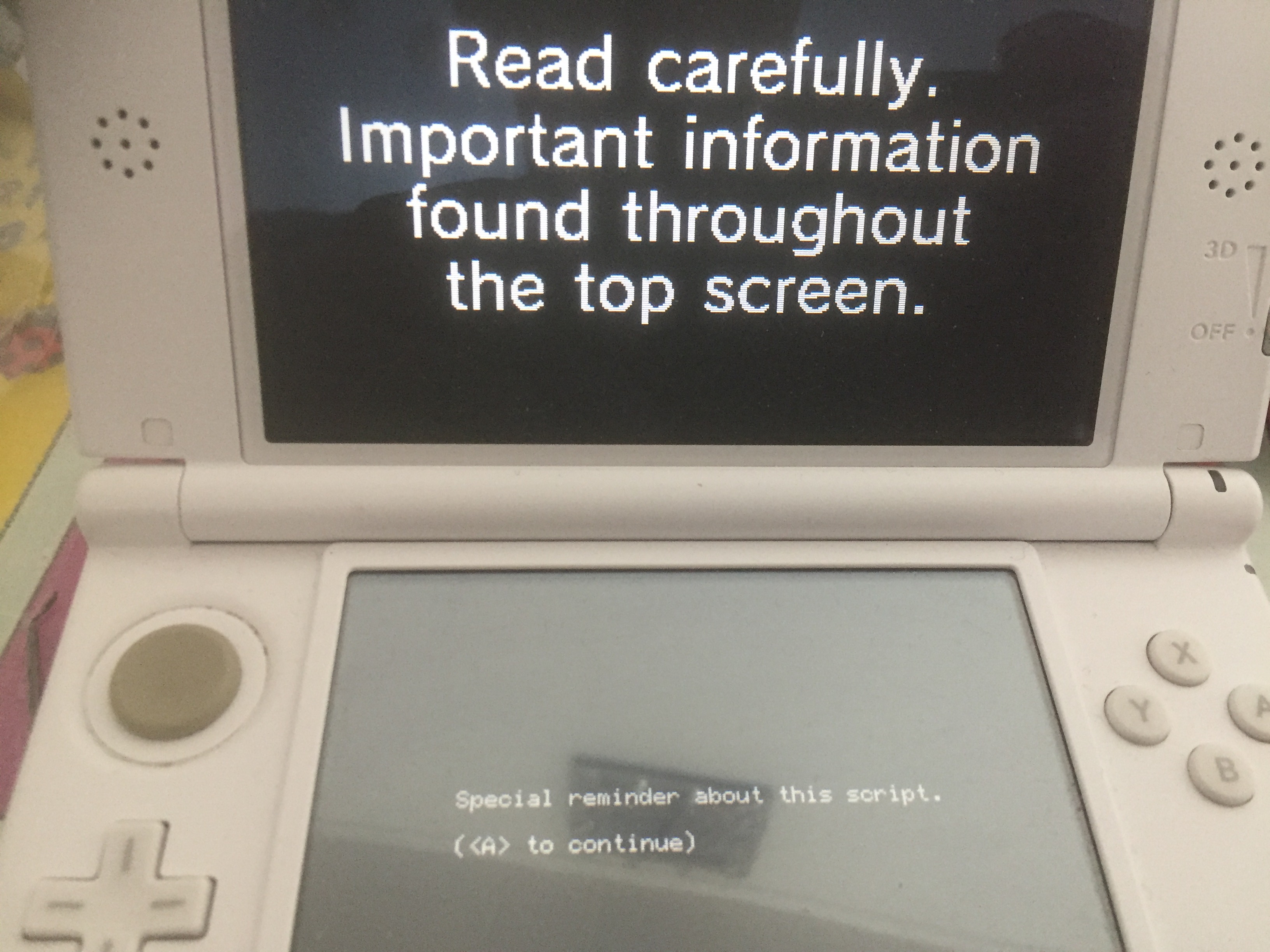

did the instructions: GodMode9 → (HOME) button → Scripts ... → CTRTransfer (Type D9) → Inject HBL to Camera.

Don't follow the steps given by @MarcusCarter.
sets the Homebrew Launcher on Nintendo 3DS Camera, not Download Play.
You can later change the injection to a different system title after the o3DSXL's 3DS firmware is fully repaired.

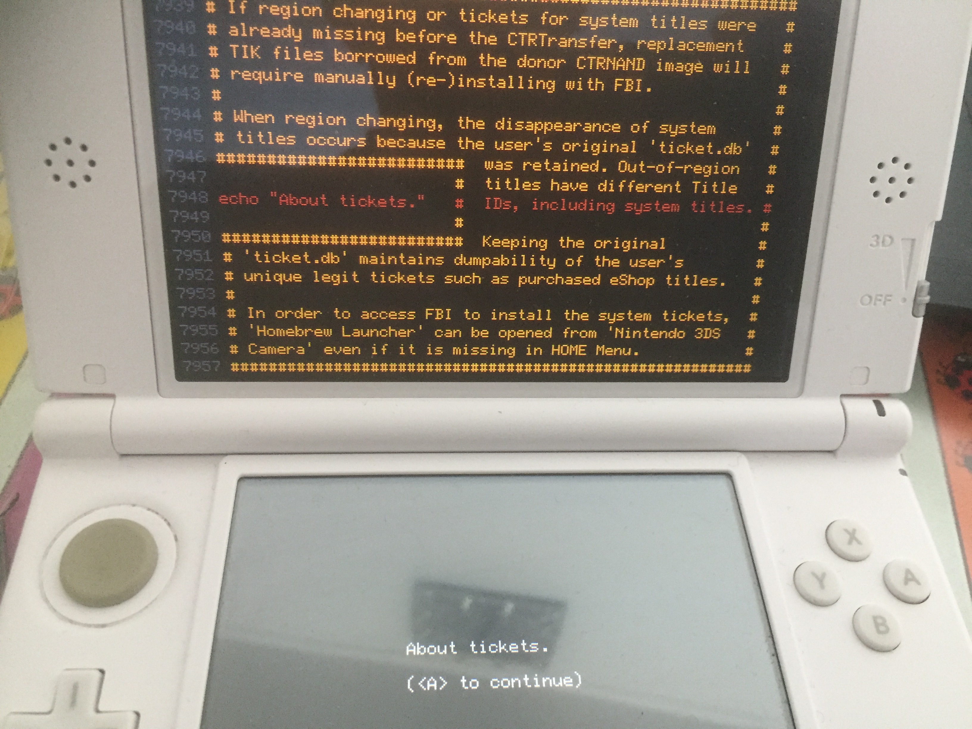

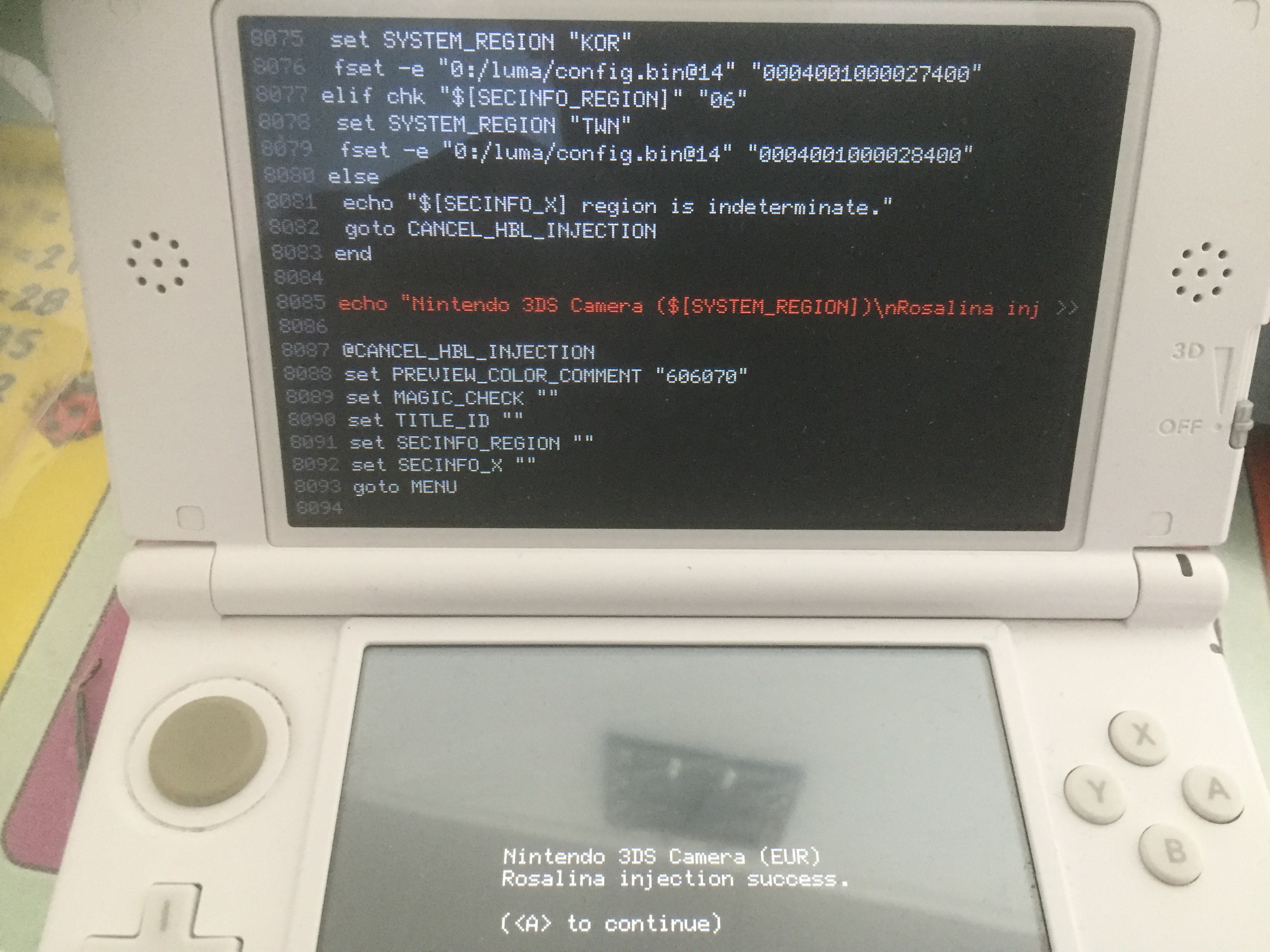

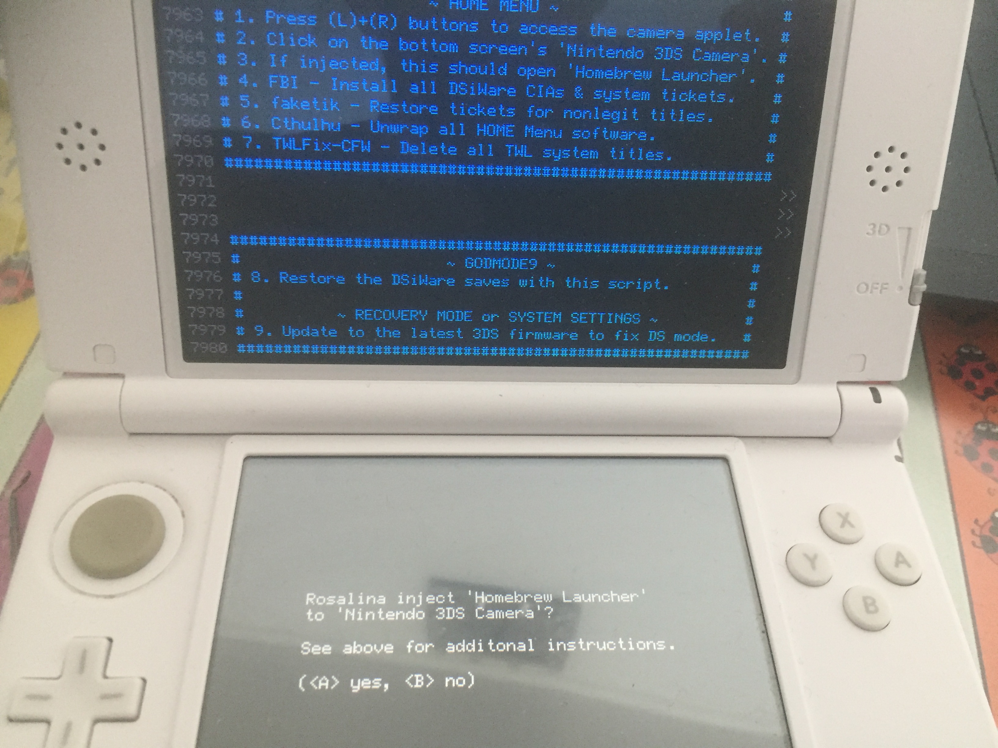

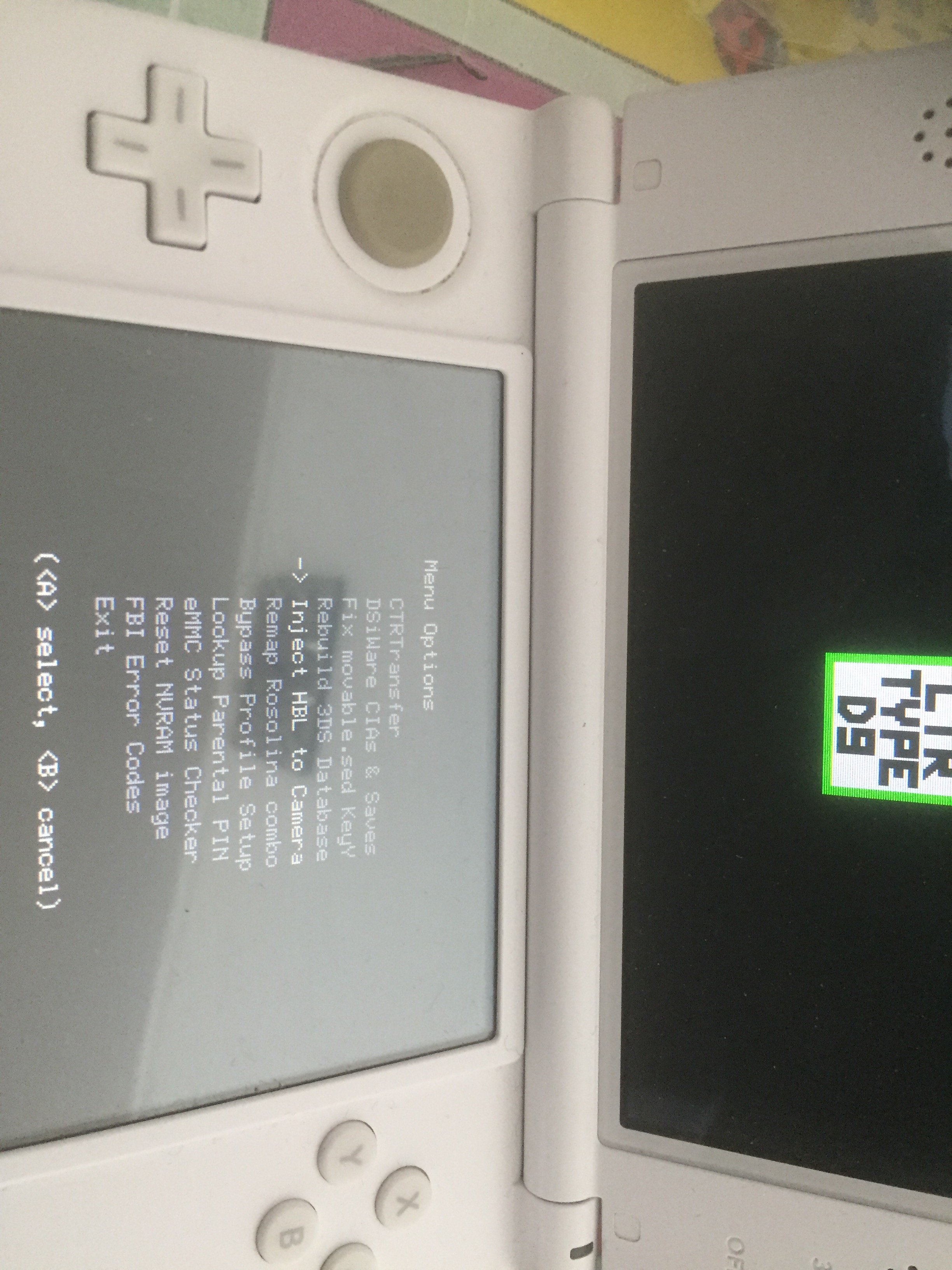

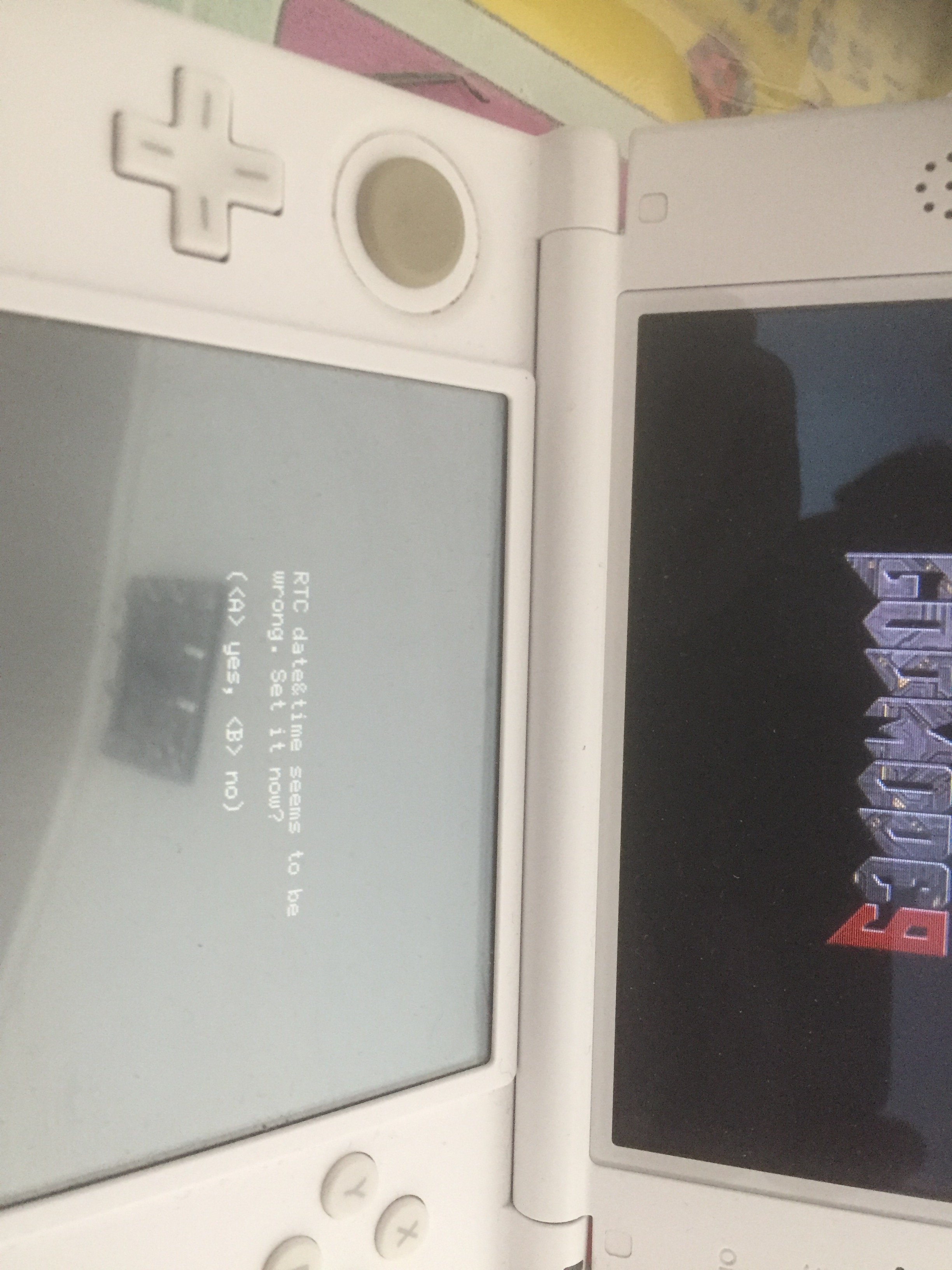

so i made 1-8 steps
I'm in the homebrew lauchner
