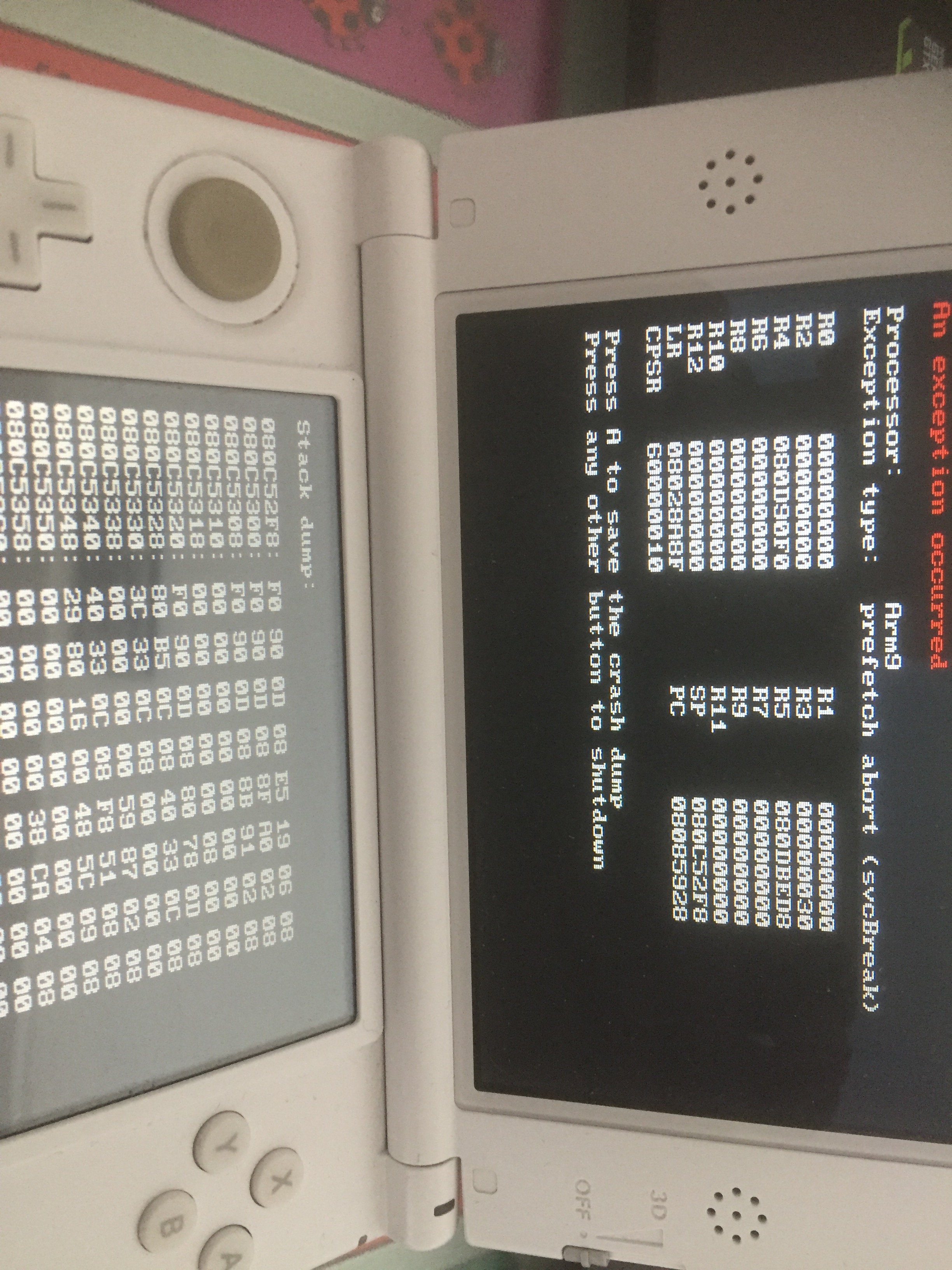

I downloaded 11.5.0-38E_ctrtransfer_o3ds, copied to SD card gm9.hab then with god mode9, did ctrtransfer.
when I restart, the picture shows me again.
can it be something to do with arm9loaderhax ??
No, it has nothing to do with arm9loaderhax. Your o3DSXL has a badly softbricked 3DS firmware.
This will need to be fixed with alternative or heavy duty CTRTransfer.

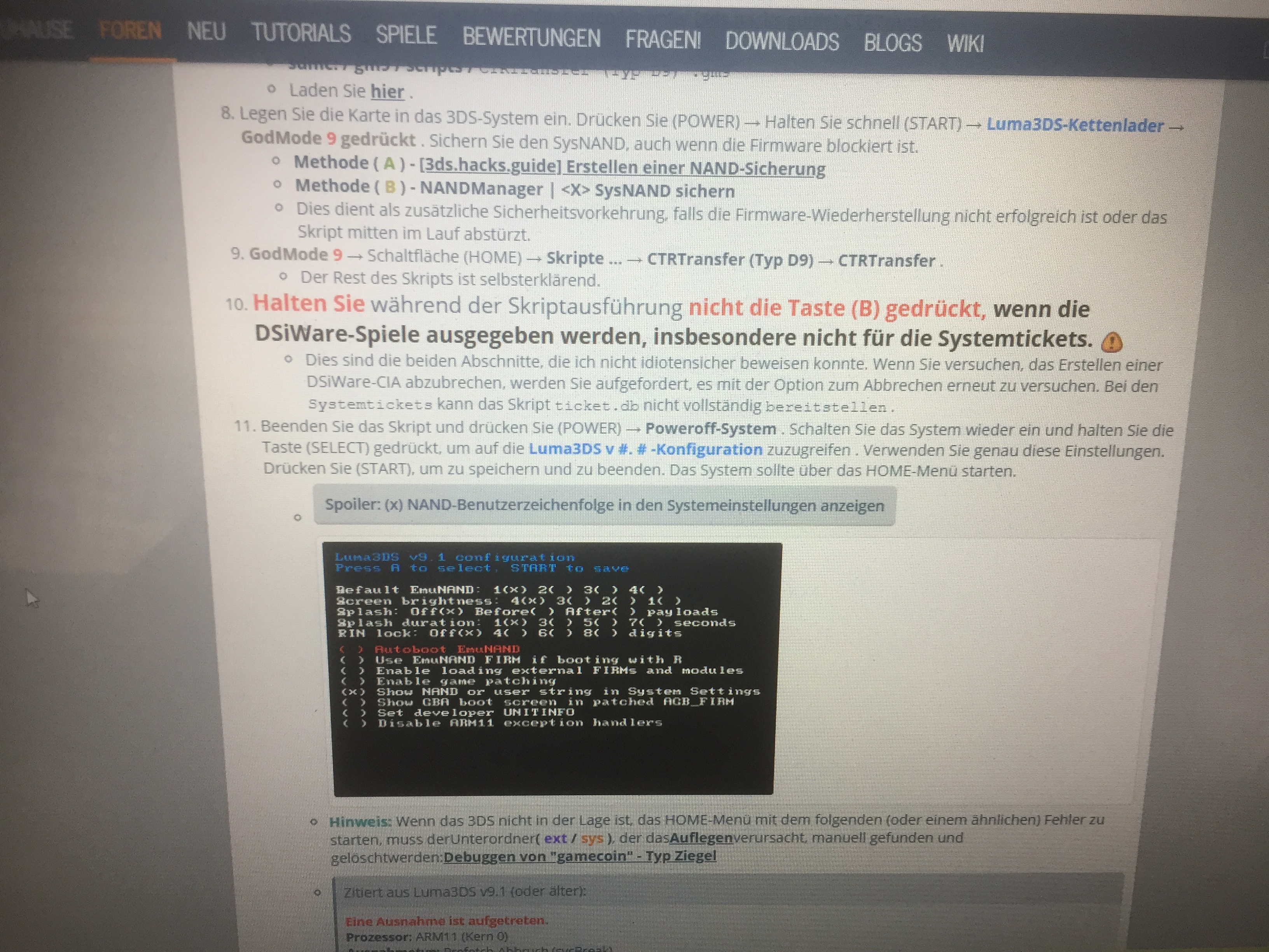

  1. Click on the CTRTransfer (Type D9) link in post #41.
  2. Scroll down until you see the Table of Contents and then click on Instructions.
  3. There should be a list of languages. Click on Deutsch to google translate the page to German.
  4. Sie sollen jetzt das Wort Anleitung sehen. Finden das Kätzchen.
    • ( You should now see the word Instructions/Manual (in german). Find the kitty. )

did everything as described until step 11, I press V #. # configuration start in the Luma3DS, then the error comes again ??
I also did that, as with the instructions

tried upgrading to B9S (A9LH is no longer supported). Install the latest version of Luma. When I press power I get to Luma 10.2, then I press start the same error occurs again ???
You're not supposed to restore sysnand with the <date>_<serial>_sysnand_###.bin image created from step 8 in the Instructions. That image is for safety in case the CTRTransfer (Type D9) crashes or fails to fix the 3DS firmware.
Restoring the image undoes all of the repairs done by CTRTransfer (Type D9) and returns the o3DSXL back to its current softbricked state.

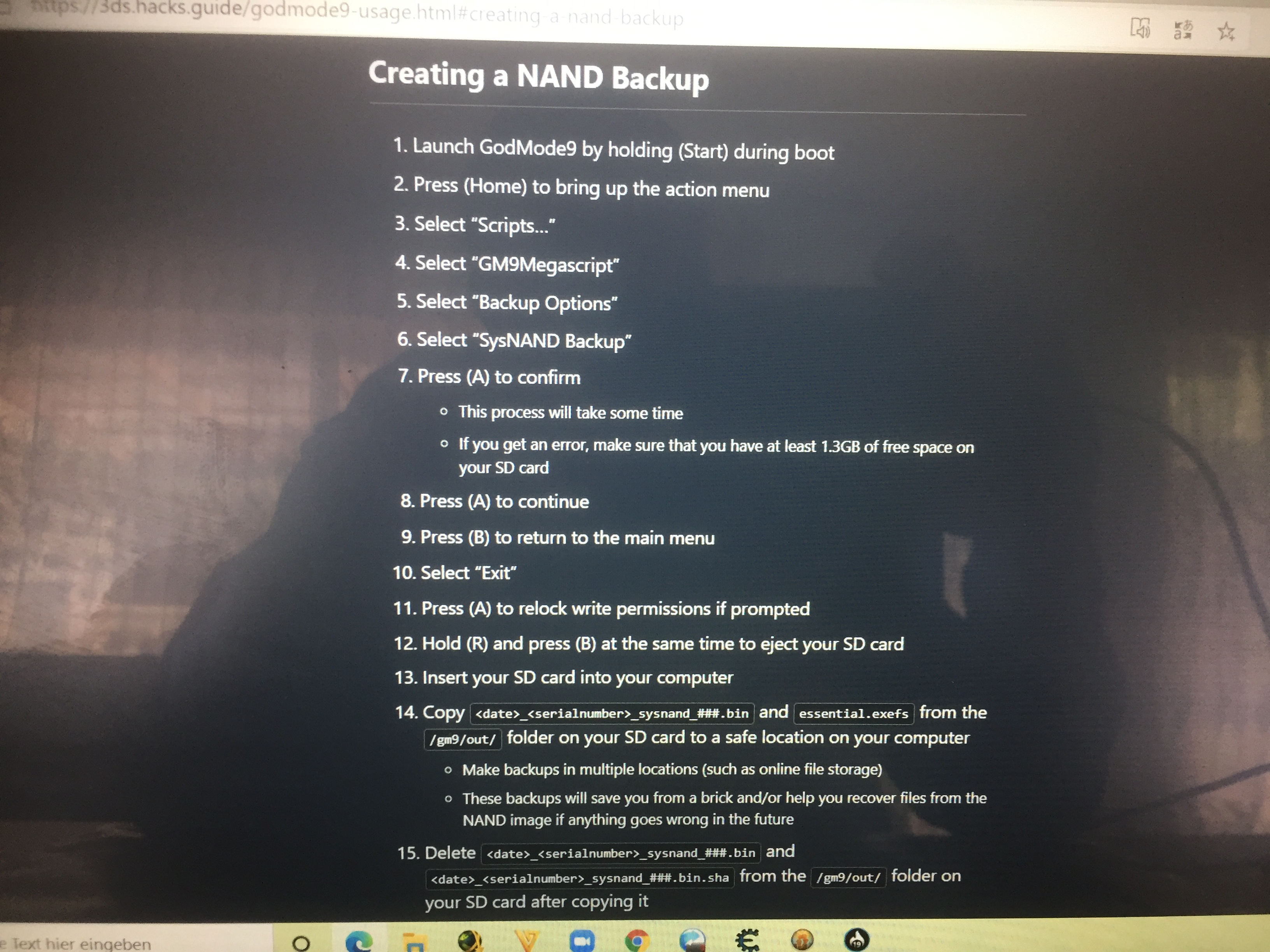

where do I get <date> _ <seriell> _sysnand _ '
<date> _ <serial> _sysnand_.bin.sha
what step can I take?
is it the nand fuse ?? because I have copied nand fuse as in the instructions in Pc, as fuse.must the two dates into the out folder ??
Vor (BEFORE)
  • sdmc:/gm9/out/ (nichts!)
Jetzt
(NOW), Step 8
  • GodMode9 → (HOME) button → Scripts...NANDManager<X> Backup SysNAND
Später
(LATER)
  • sdmc:/gm9/out/
    • <date>_<serial>_sysnand_###.bin
    • <date>_<serial>_sysnand_###.bin.sha
