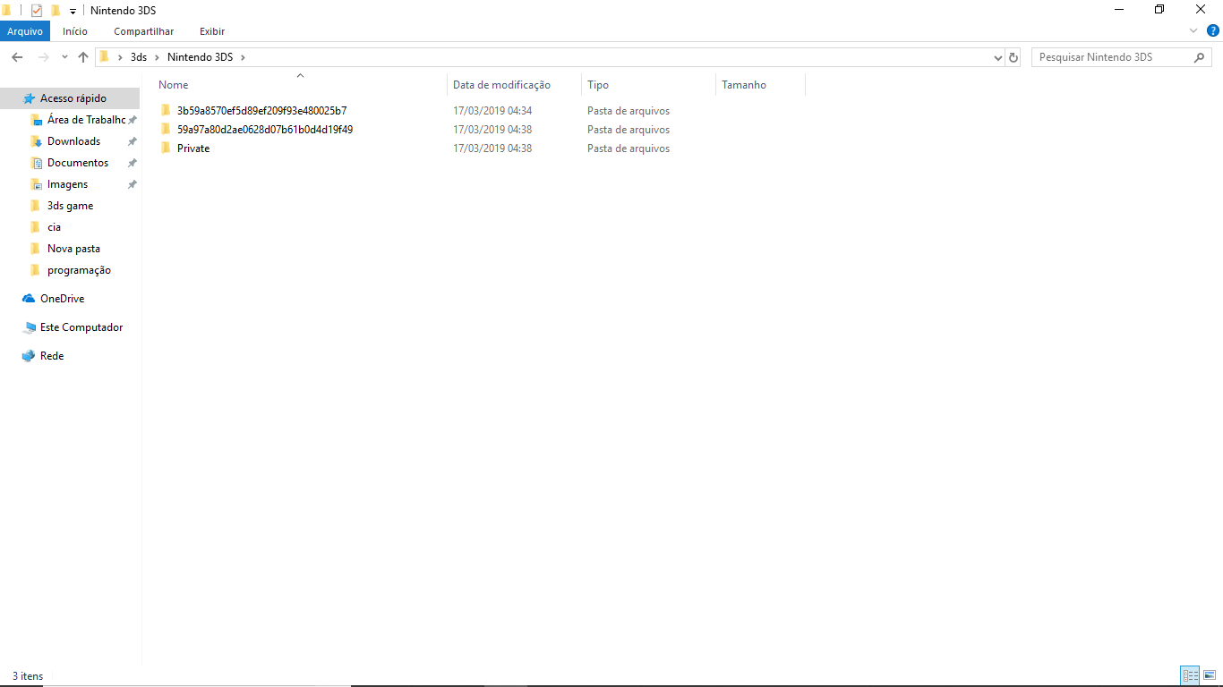

huuuum, I understood, the sd exchange occurs in the same system and the splash appears showing that it can still read the sd, so I do not consider that it should be a problem of 3ds.I will study further down this folder because in my so appears in the image attached and because of this I am confused as to follow the instructions correctly.

huuuu, I understood, the sd exchange occurs in the same system is the splash appears showing that it can still read the sd, so I do not consider that it should be a problem of 3ds.I will study further down this folder because in my only appears the following imagen is do not know how to follow the instructions correctly.
  1. You have two <ID0> folders, one of which has your original setup.
  2. You can't shared <ID0> folder between different 3DS systems because of different movable.sed.
    • Unless it's System Transfer.
  3. You can also lose the matching encryption KeyY tied to that <ID0> on the original system if you did a Format System Memory.
To learn more about this, read here:
You might be able to brute force back the lost KeyY using this gm9 script.
