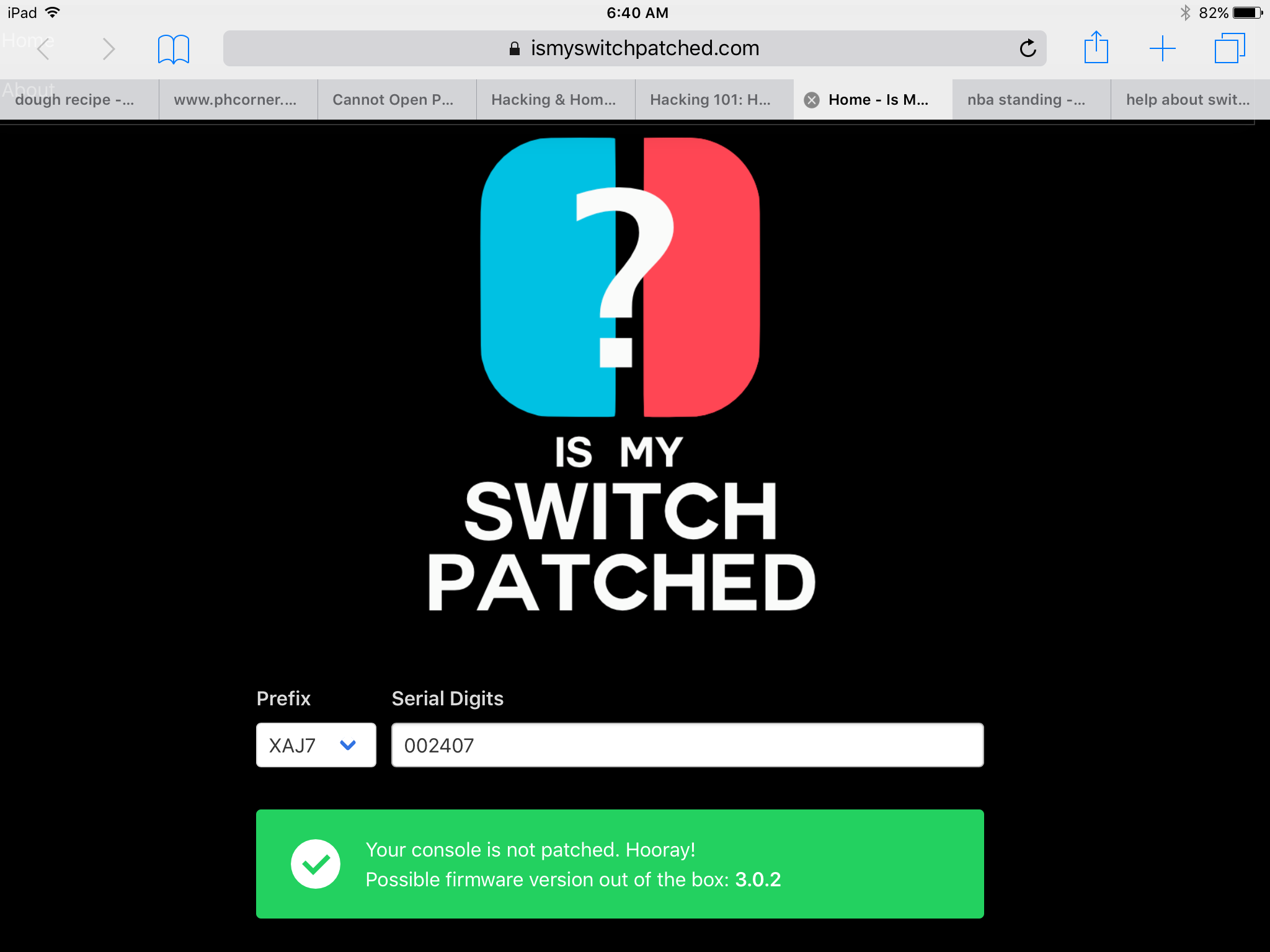

It is 100% unpatched, first patched unit firmware is 4.1.0 I believe.
its said not patched am i good to hack my switch?
It could only be hacked if it is a non patched system. The only way to get HB though a software exploit is on v.1.0.0 to v. 3.0.0

1,559
Answer to that should be fairly obvious. If it's not patched, it'll be hackable. The patch is what stops the exploits working.
