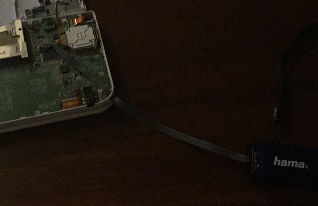

I tried to downgrade my 3DS XL into 9.2 version, and it downgraded successfully, but after reboot, it returns into error
I read somewhere, the wires must be under 15cm, and that is >15cm but PC have found them...
I checked all wires and all are right.
Can someone help me??

Looks like a hardware error to me.
You flashed your own previous 9.2 nand backup/dump right? If you used a doner nand or nusd download it will fail?
It should boot unless connected.
The only time i see blue screen like this, is when people fudge their hardware based nand mods.
Remove it and clean up any of your excess solder and see if it boots?

The error is:
00F800EF
FFFFFFFF FFFFFFFF
00000024 00000000
And, no... I didn't posted into Hardware section...

I checked the solders and all are right...
Yesterday I downgraded into 9.2 version successfully, but, after reboot, that error...
Maybe must I remove solders?
I have seen this... you had touch anything other solder points, or your NAND should be partially unsoldered... bad contact, short circuit.
DAT line(s) are connected to GND

i "semi" resolved this probleme with a big magnifying glass, a soldering iron, soldering flux and 3 hours of work....
the problem was, i had touch the chip, (less 1 seconde) with the soldering iron, beside the soldering point...
i hope you understand i write... sorry for my english.
