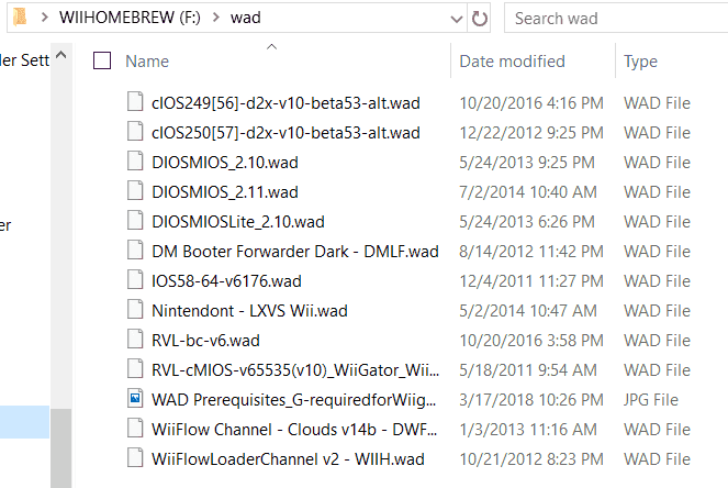

On my SD I tend to keep all the WADs I have installed, so here:

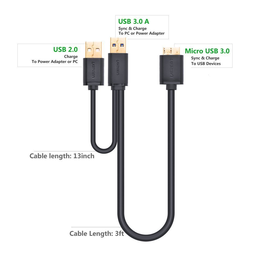

this cable should help you
https://www.lazada.com.ph/products/...-cable-for-wii-u-black-i1744286-s2114967.html
but word of advice
wii may or may not detect it still depends on the usb controller too -
i bough a 2.0 with y and a 3.0 single cable enclosures
the 2.0 didn't work even with the y cable
the 3.0 obviously didn't work -
what I did was, use the y cable from the 2.0 and used the 3.0 enclosure and the wii detected it.

How would I combine the two cords if all of them end in males? The cord I have currently is 3.0 micro B male to A male.
I noticed in some cords the Y has both 3.0 and 2.0 A males. I can't tell if all of them are like this, or if some has both ends as 3.0... Is the one you linked 3.0 all around?
(Woops, double posted, sorry!)
The main USB plug goes into port 0 on the Wii. (Closest port to the edge of the console.)
The short lead one that's labeled "2.0" is only for extra power and doesn't have the data pins connected. You can either connect it to the other port or a USB power brick.

Sorry, I just reread this... You're not combining a Y cord and a single cord, but a Y cord with an "enclosure"? Googling enclosure, does HDDs connect to that, which you then use a cord to connect it to something else? So, your setup is, the Y cord's two A ends are connected to the Wii, while the micro B end is combined with the enclosure to connect with the HDD?
See, this is why I was confused about how to combine my cord with the Y cord you linked, since all the ends on both cords are male. >.< I think I better understand now..
So, will I have to buy an enclosure, too?
Alright, thank you for the clarification. ^_^
You just need a MicroUSB Y-cable. USB 2.0 or 3.0 doesn't matter since the Wii only supports USB 2.0 anyway.
An enclosure is only for when you're providing your own 2.5" HDD.

That d2x beta 53 could be your problem. It's got serious compatibility issues with both drives and games. It is only useful if you cannot use USB port 0 on your Wii.
To load homebrew from USB instead of SD press 1 on your Wii remote and select USB instead of SD. You will have to have some sort of homebrew on your USB in an /apps/ folder.
I tried to load HBC from the USB, but it seems to be unclickable... Since I'm desperate, I'll try to replace the d2x beta 53 anyway.
So, do I uninstall both "IOS249[56] (rev 21010, Info: d2x-v10beta53-alt)" and "IOS250[57] (rev 21010, Info: d2x-v10beta53-alt)"? Then replace them with cIOS249[56]-d2x-v10-beta52? That's a wad I just happen to have since I have Abz's megapack. Or do I only replace 249's with that?
