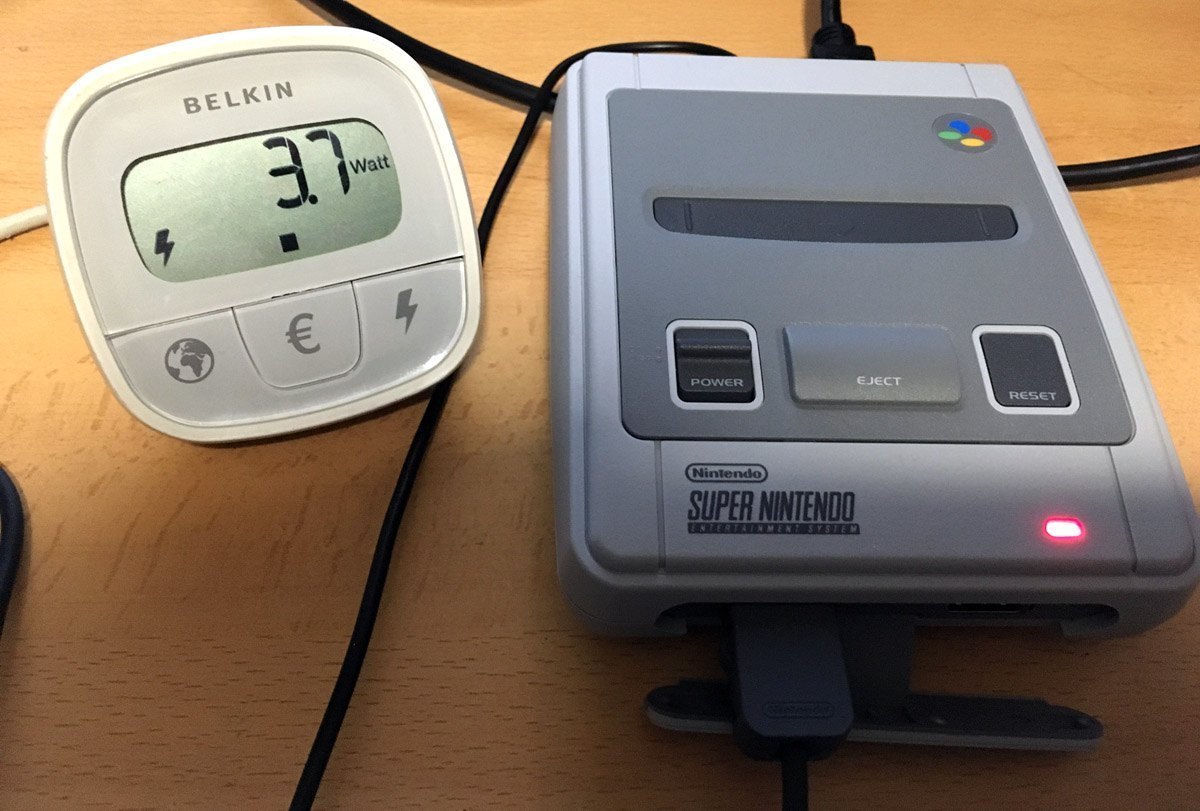

I measured with my Belkin meter. It is very accurate, I use it a lot. I did it again (with the last "Release" version) with the custom kernel. You can see wih your own eyes, I took a shot (SNES is in game menu):
(My SNES is an EUR one with d76c2a091ebe7b4614589fc6954653a5)
Photo:
Could be that some SNES are "faulty" from origin?
(When in-game it raise up to 4.2W sometimes)
Have you tried uninstalling hakchi2 completely using the uninstall option and starting from scratch? How many games did you add? Do you have any mods or hack settings? I myself started my measurements from a "virgin" system, i.e. no prior hacks and leaving most settings in hakchi2 at default.
