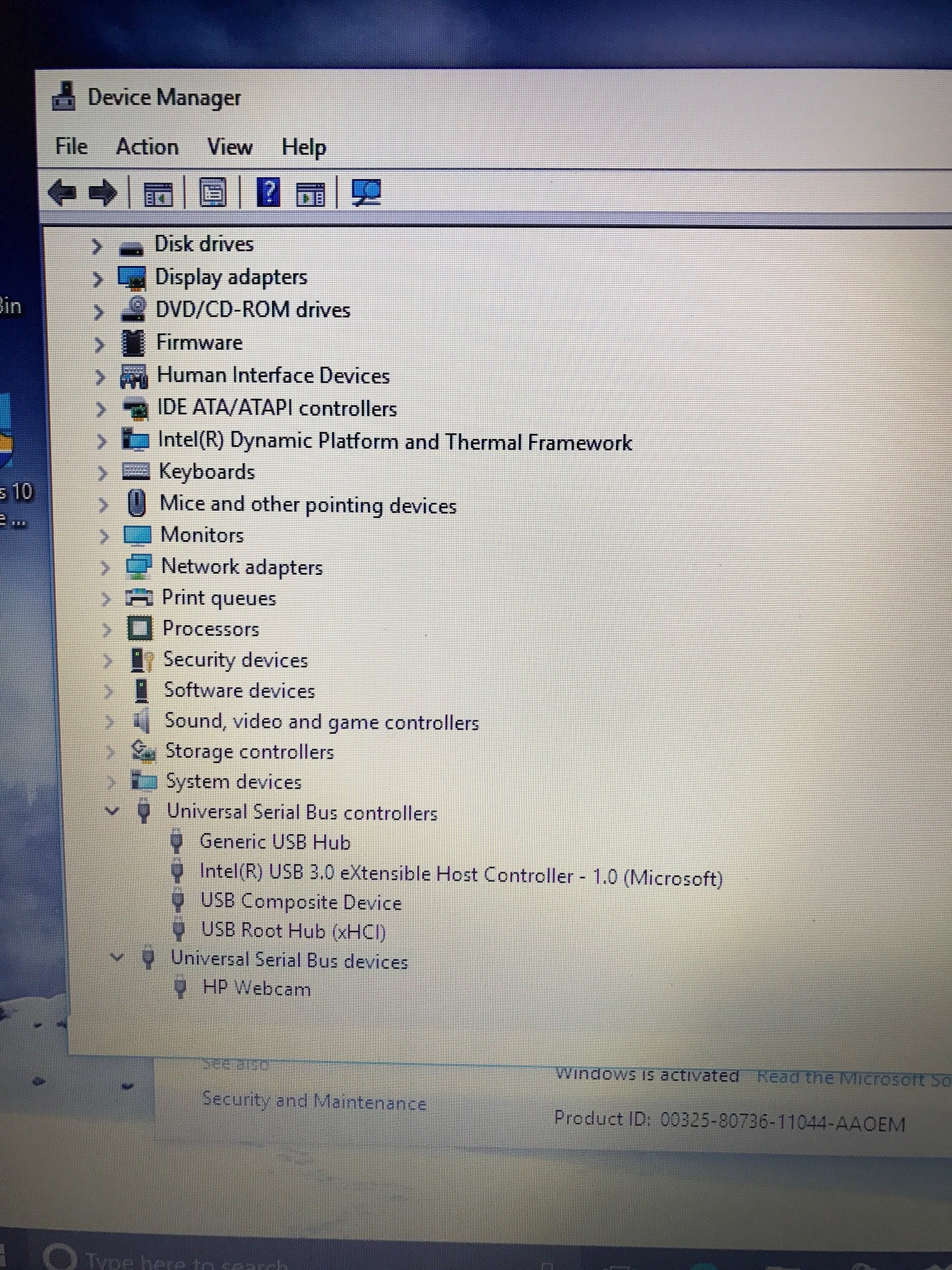

I just bought a laptop Saturday. I only have one USB plug on this computer and when I try to install the driver. It never recognizes the mini

Let's hope it isn't a usb 3.0 port! If that is the case, you may possibly be out of luck. What operating system, and model number for the computer?

It is a USB 3.0 Port, unfortunately. So, there are a few possible options you can use. This does not mean you have "no way" of using the port. There may be another conflict at work. But, generally, 3.0 Ports do not play well with the NES Mini. I have had many switch to 2.0 Ports and be fine! You can try going into your BIOS Settings, when booting up the computer, and disable 3.0 functionality for USB and/or enable legacy device support for older 2.0, etc devices! You may also get decent results using a 3.0 to 2.0 USB Adapter. These are cheap, and may be worth a few bucks to test out. They have worked for me in other Computers I have troubleshooted with Older Hardware Setups and Configurations!
But, getting back to my original "no way". You may potentially, also have virus protection, or lack true Administrative Rights, as far as being able to actually do anything with the Mini NES. Hakchi2, generally false positives many Virus Protections, especially Norton. In several instances, I had to help people completely uninstall Norton, just to get the Mini to work. Then, reinstall Norton! It varied, case by case, depending on how Norton was initially configured!
So, for now, I would recommend trying to get into BIOS, and hopefully...you have an option to disable 3.0! Let me know, I can advise you of other things to try or do.
So go into device manager and disable the 3.0
Not quite as easy as that. It would be in BIOS, when you boot up the computer, usually holding F2, or F1, etc, depending on which specific computer or Bios are installed. Did you buy this computer locally? Or, Online? It is pretty bad to have just "one" usb port on a computer.
