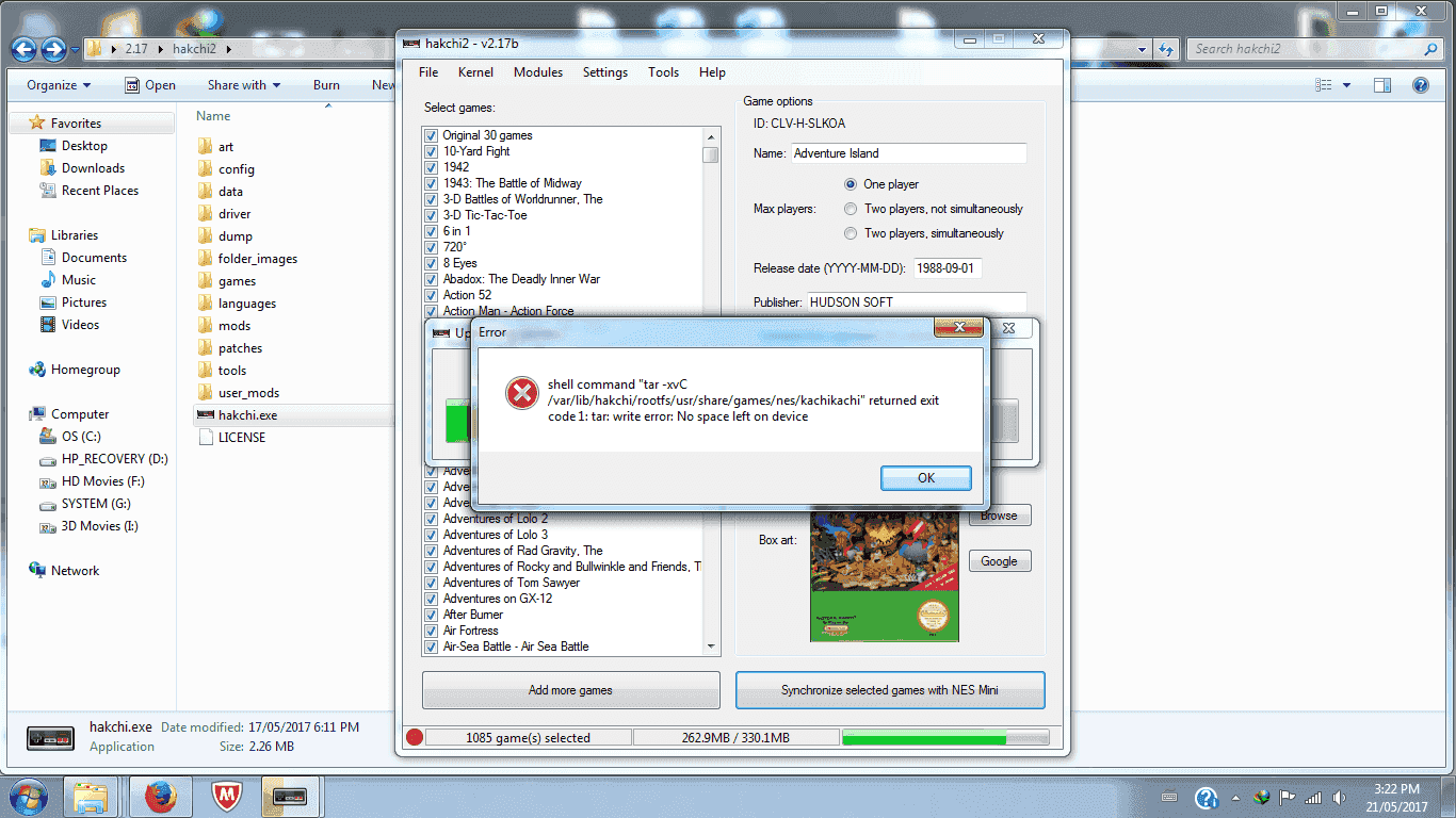

Not sure why I am getting this error?? Can anyone explain?

Ummmm..maybe cause your using an HP computer..haha..
Maybe cause your space isnt showing correctly..did you account for the space for your hmods?
Hey my HP ran solid for 6 years now.. best computer I ever owned.. haha I didn't account for the hmods so maybe just too top heavy on the games..will trim the fat and see what gives..Thanks for the advice

If you want to know how to fix it I will tell you bro

Here is how to fix it. First uninstall all mods. Then completely uninstall hakchi from inside hakchi program. And then flash original kernel. And then turn system on and factory reset it. Then flash custom kernel then install mods then sync games. And your problem will be fixed!
Will give that a try and ley you know..Thanks again for the instructions.
