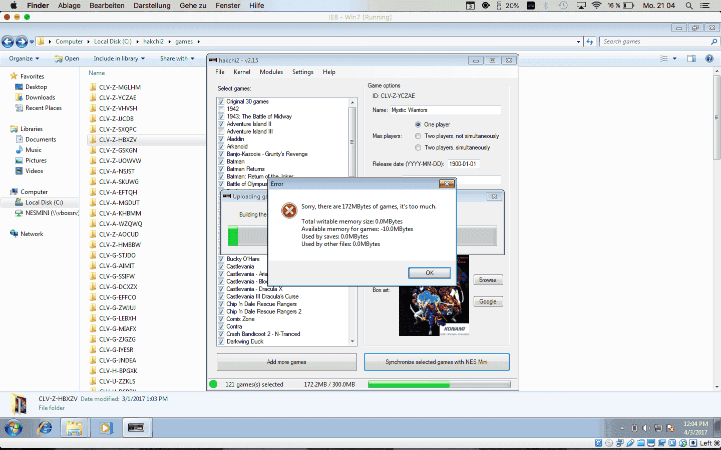

One Month away...two new versions.... now i had time to update...
Update the to 2.15 , Check!
Update the Custom Kernel, Check!
Update the new driver, Check!
Update Retroarch and Cores, Check!
Add the "new" USB device to VirtualBox, Check!
Try to add or delete games, FAIL! (see image at the end)
Ok, Delete Hackchi2 from NES Mini, flash original Kernel, Factory reset, CHECK!
Install the Custom Kernel, 2nd time, Check!
Intsall the new driver, 2nd time, Check!
Install Retroarch and Cores, Check!
Add the "new" USB device to VirtualBox, 2nd time, Check!
Try to add Games, FAIL! (see image at the end)
Any ideas? VirtualBox an Mac user.

I would like like to see a way to bypass that warning....
It doesn't look as if it could actually read the real stats from your nes. Because if it were able, it wouldn't be showing 300MB, it would show the excact size. So I'm guessing the usb passthrough to your virtual machine isn't working. That would also explain why it believes 0 Bytes available.

Same situation. In process of troubleshooting but please let me know if you figure it out!
not a mac problem i had this on windows 10.. i just tried diff compatibilty modes on the exe uninstalled everything and reinstalled mods and games and tried another port and it started to behave ? not sure which one fixed it though
Ya that's weird. I always turn windows defender off whenever I touch hakchi so I usually don't have issues
yeah actually anti virus apps are wierd also i think i have mine off just in case(inside is has a usb driver malware checker type thing ruins things )
