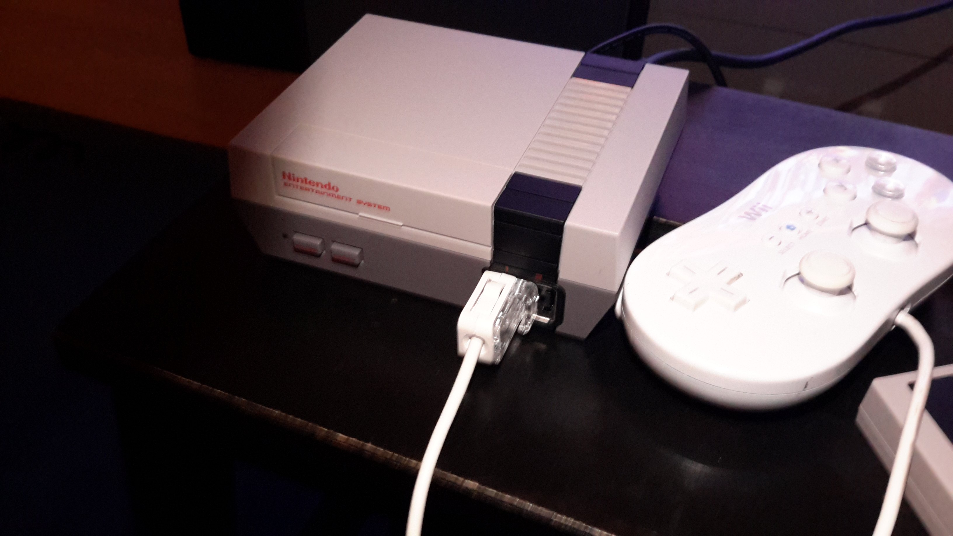

I finally got my wii classic controller, and it seems to work well (also diagonal movements). I wonder how to plug 2 controllers the same time? any idea?
just remove the plastic cap with a screwdriver.
You should get extension cables, they will take away from that protection clip that is on it. I think that might be easiest without having to dismantle it.
Reactions: herm4n
I know in the extension cables I had, that included those clear plastic clips, there was a screw holding it on.. I unscrewed the screw, removed the clear plastic, then re-inserted the screw.. But I didn't screw it back in all the way, as it was now longer than needed since the clear plastic part was now gone. (just to be safe).. If yours has a screw, you can do the same.. Then you will be able to use multiple controllers in the ports. :)
Hope that helps.
Reactions: Kobe46 and herm4n
