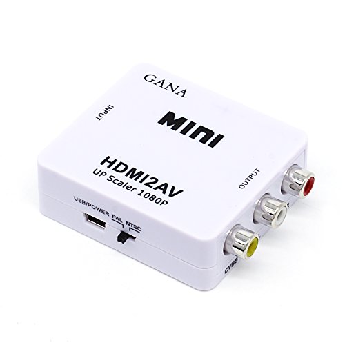

Maybe I'm alone with this one but I'd like to play my NES Classic / Mini on my old school Sony CRT which is a 4:3 aspect ratio...
I posted this on another forum and hopefully (with more exposure) someone CLUSTER or Madmonkey or anyone else can perhaps resolve with a screen display setting change to the DISPLAY on the NES Classic MINI on a future release. To me, I'm an old school gamer, I want to play the NES Classic on my SONY CRT 4:3 TV. However the display when running the classic looks like the image is being reduced. Old school / style CRT's like I have DO NOT have HDMI inputs... So I went on Amazon to get an HDMI to Composite adapter thinking it would work fine. It's funny that these Nintendo Classic Edition's weren't intended to run on old CRT TV's. For comparison I took the original NES (1985) the Raspberry Pi using RetroPi / EMU, As well as the NES Classic / Mini.
First of all my SONY CRT Does not have any HDMI inputs on it. So I'm using an HDMI to Composite (standard RCA or Red White and Yellow cables) converter which is actually this one:
https://www.amazon.com/GANA-Composi...=1486583781&sr=1-7&keywords=hdmi+to+composite
Running the original NES (1985) on the 4:3 SONY CRT produces a full normal nice image without using any converters as it just uses the composite in/outputs...
Without anything plugged in this is what the converter from amazon shows on the Sony CRT 4:3:
This is the menu for Nintendo Classic Edition aka Mini NES using the HDMI to Composite converter(seems to fill the screen fine):
and now this is the problem.. Running the actual game on the Nintendo Classic Edition it seems to squeeze / shrink the image? : it's set to 4:3 mode, not on pixel perfect / pixel perfect actually squeezes the image more..
Just for curiosity the same exact thing happened on the Raspberry Pi (Menu essentially looks fine.. *however..
*Raspberry Pi with HDMI to Composite converter also squeezing screen in-game (not as bad as the NES Classic Edition / mini, but still noticeable):
Any way to fix the squeezing image produced on the raspberry pi / classic nes while using my 4:3 Sony CRT with that HDMI to Composite adapter ?
Have you TV(remote TV control) a button to change the aspect ratio?
Rgs.
Reactions: DRiP_XIII
