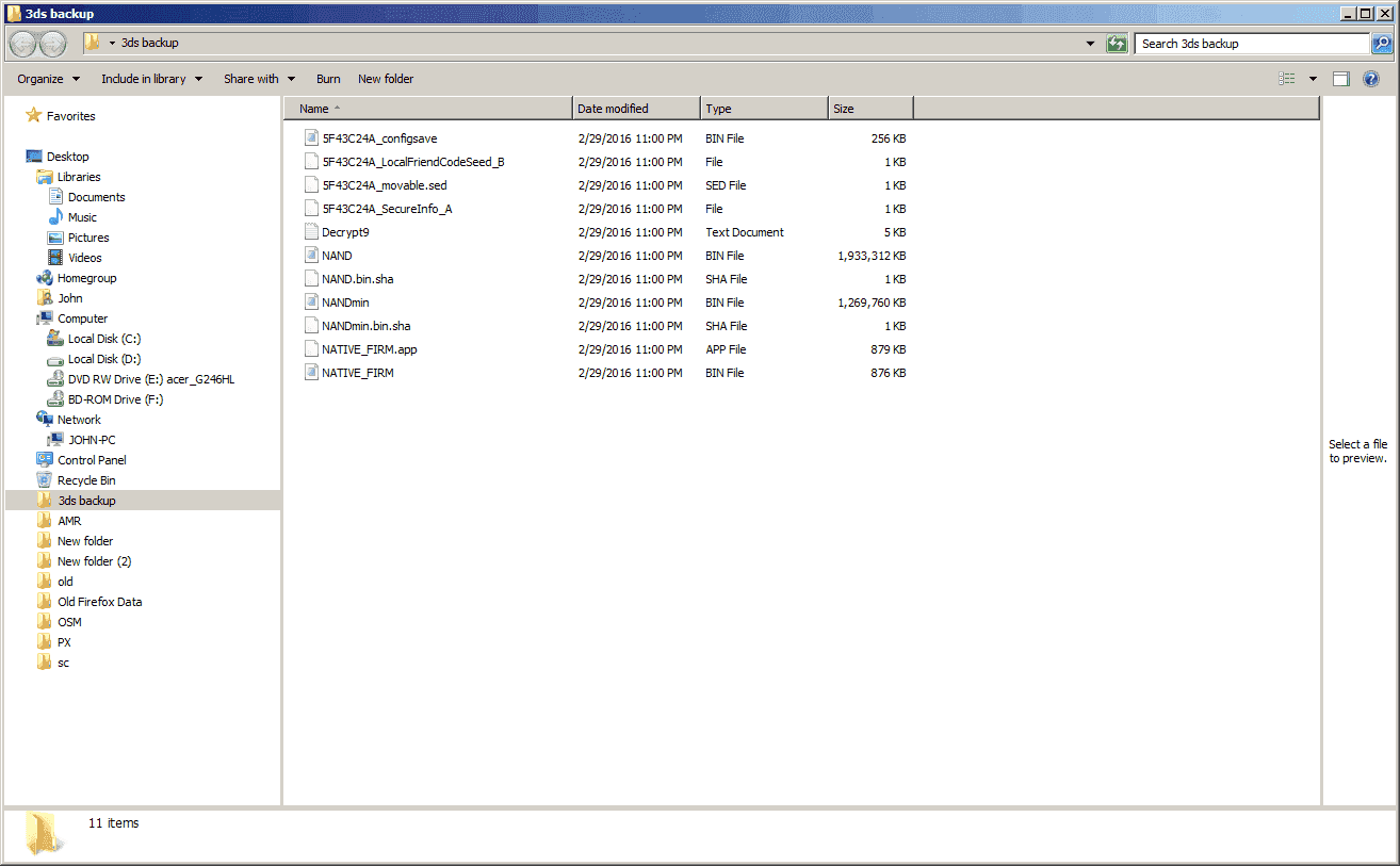

I did, this was what I have.
It appears that you only have the files9 folder, re-download the files and things from where you've left off and carry on, be thankful you have a nand backup
Ok, will do. Should I be worried about the sd card though? What would cause it to have to format like that? It's the only 32 gb one I have, but I have a couple 8 gbs I could use.
