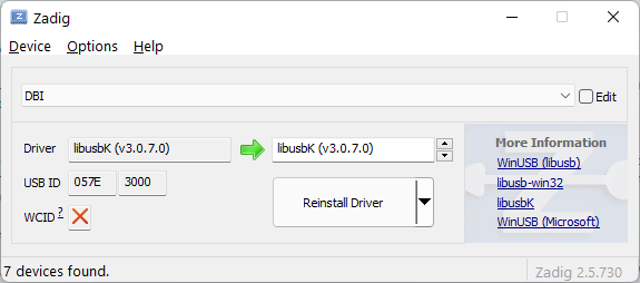

I've got a weird problem. It's most probably something I've overlooked but I can't get DBI to install over USB.
I recently updated to Atmosphere 1.1.1, on OFW 11.0.1, DBI 330. The app opens fine and I can run the MTP Responder but whenever I select "Install title from USB" it refuses to recognize the DBI Backend program. It just counts down then backs out to the app's main menu.
I don't know what I'm missing. I've taken to transferring the NSPs over via MTP and installing from the SD card but naturally USB installations would be preferred. It's always worked before. I'm using a new computer and had to thus re-install the Zadig Switch driver to push payloads. Is there a secondary driver to install for DBI that I'm forgetting?
As ever, any help would be greatly appreciated.
EDIT: To elaborate a bit further, when starting the server from the DBI Backend to start USB installation it reads "Waiting for Switch" repeatedly. When I select "Install from USB" in DBI on my Switch the DBI Backend stops repeating the message. That seems to indicate that the backend has recognized something but either isn't pushing the information to the DBI app or the app can't properly connect.

I recently fresh install the Windows 11. The problem you mention just same as mine. However, I managed to fix this.
Your computer should detected a "DBI" with no driver in Device Manager once you select "Install title from USB". You just need to open Zadig and install the "libusbK" driver to the "DBI". The end result should be like this.
HTH.
HTH.
There are two unique DBI driver scenarios:
1) The hint above from @Jikolp solves the driver issue for "Install title from USB".
Dowload Zadig from here: https://zadig.akeo.ie/
Connect and find DBI device. Install libusbK driver. Enjoy!
2) This hint from @arabtm solves the driver issue for " Run MTP responder".
https://gbatemp.net/threads/dbi-usb...e-on-2-out-of-3-usb-port.589818/#post-9499180
Again, there are two different solutions for two different methods. The switch presents itself as completely different devices (first one is detected as DBA while the second is detected as Switch) with completely different drivers.
Doing this solved my issues for both methods...everything DBI just works now!
Thanks @Jikolp and @arabtm
