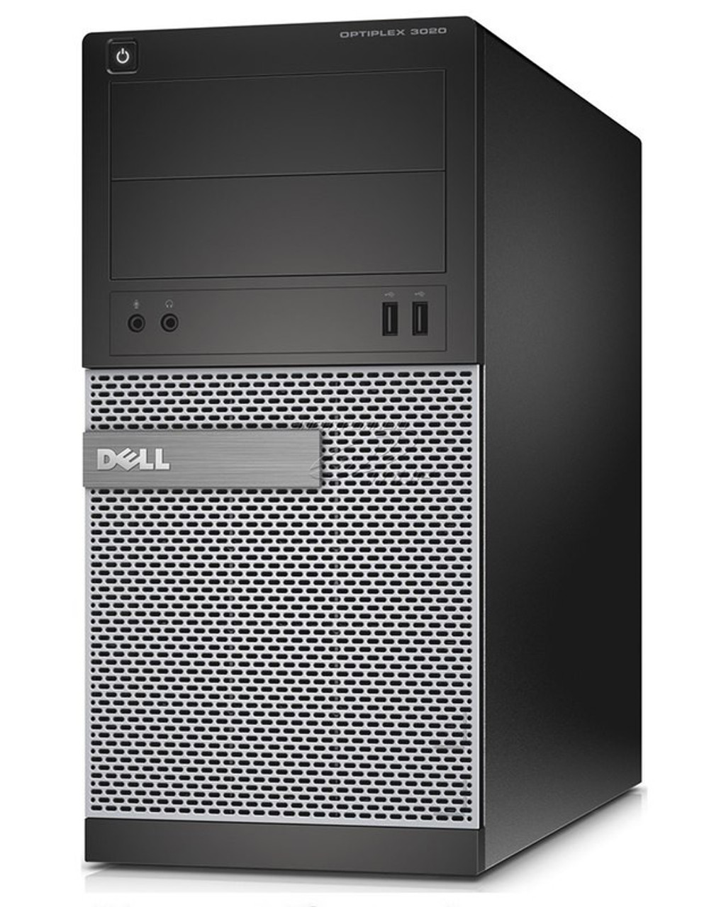

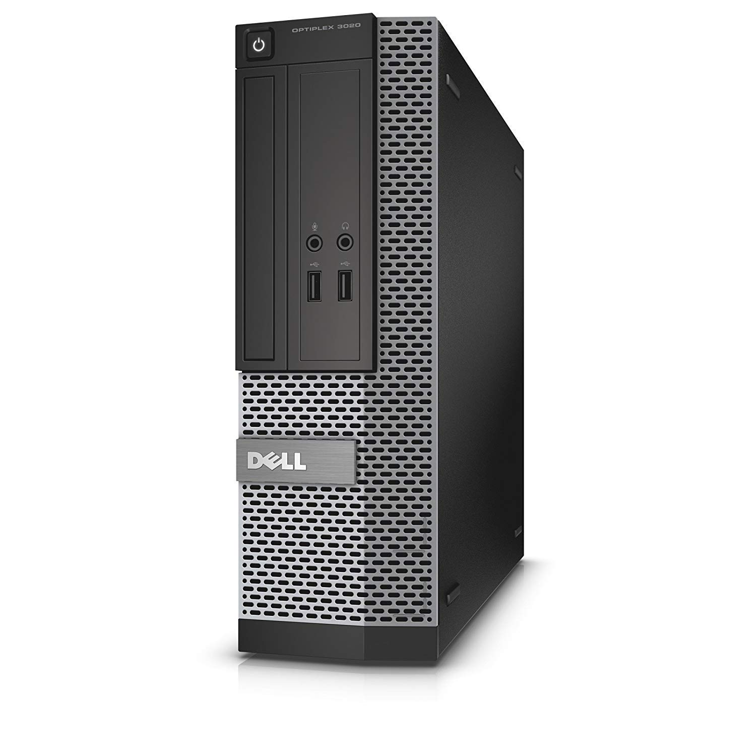

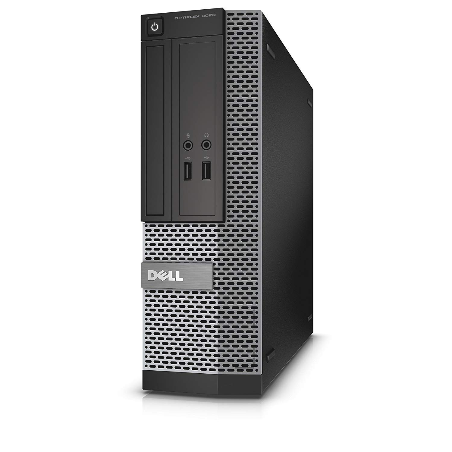

I don't mean case, you should get a full size tower pc instead, SFF have problem with it air ventilation, and you can't put a full size card. If you really want Dell 3020 the left is what you really should go for instead of the SFF on the right.

Ventilation is usually always a problem with prebuilt business PCs, they have few fans and no extra ventilation slots to mount extra fans. SFF might be worse for that but in general they just aren't made for gaming grade components.
Also, I don't know if it's the case for this one, but they often use non standard PSU, and non standard motherboard mounting holes or dimensions, so you can't upgrade the PSU (because it would also require upgrading the motherboard due to non standard plugs, which you can't do, or because the PSU form factor is non standard), so it limits the components you can put in it anyway to stay within the PSU rating.
It's possible to put a GPU into one of the SFF ones, with usable thermals, and staying within the PSU limits. It's probably easier to do it with a full sized one since the components are slightly more standardized and upgradable. But I've seen people do it successfully with both. And there is something cool about a sleeper build in a SFF business PC even if it is limiting.
Thank you, so there should be no issues, just need a bigger case. Thanks!
That is not likely to work because Dell uses a lot of proprietary non standard parts. Non standard plugs for PSU, non standard form factor for PSU and motherboard, etc. You can't expect to put them into a normal case without drilling a lot of holes and potentially cutting holes to make things fit. And there is no reason to because the entire appeal of these used business towers is that they are dirt cheap and often only require a GPU to become a decent gaming PC for dirt cheap, and replacing the case makes it no longer dirt cheap. The more things you have to replace or upgrade, the more you should have just built something from scratch out of used parts or gotten an older used gaming PC and upgraded the GPU in it.
