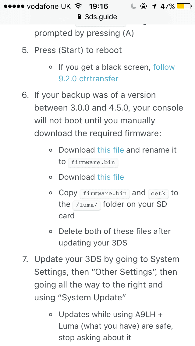

    Look at the photo attached, it's because you're on a firm not supported by luma but doing what it says will fix this..
    Do you still have your backup containing where you installed A9LH? Check if the nand backup is corrupt or not the correct file size.

  9. ocilfa
    OP ocilfa Newbie
    Joined:
    Feb 8, 2017
    Messages:
    8
    Country:
    Thanks man, I must blind. That certainly helps.
