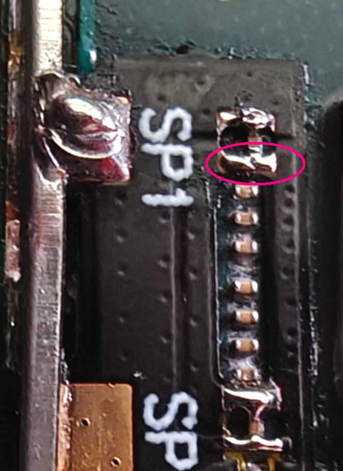

Hello,
I'm having some issues with a new Picofly installation. I have installed the latest firmware, but I'm receiving an error code through the LED flashes.
The pattern is as follows:
1. A **blue** flash
2. A **long yellow** flash
3. A **short yellow** flash
4. (Then repeats) A **long yellow** and a **short yellow** flash
Could someone kindly help translate what this specific flash pattern means?
Thank you for your assistance.
Also i didnt ground sp2 as recomended in the guide i followed in YT, maybe this is related?

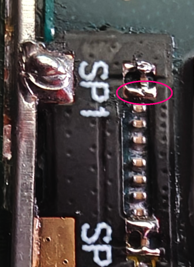

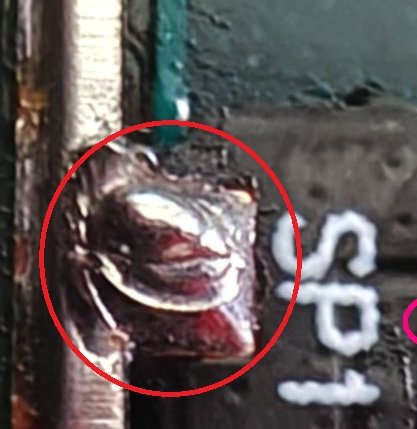

That's not good, soldering SP1 convex prevents the heatsink from sitting flush. You need to remove the solder, press the flex cable down firmly, and solder it concave so the joint sits under the shield plate, not on top of it. I also recommend using a tiny bit of no-clean flux for a stronger connection and a cleaner solder job.
You don't need much solder for a good connection.

thanks for the the comment! that was my first ever solder connection and ended up messy, i have already redone it along with other bad connections the readings are now better too.
