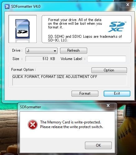

When you use the software to format the micro sd card, it is only
> > useable in the sky3ds, you can't use windows to format the micro sd card
> > to be useable in anything like a camera, it displays that it is a 512kb
> > card instead of 4gb, if you go back to the program it still sees it as
> > 4gb, but it is not useable in anything else, the same thing happened to
> > the 32gb and other 4gb, card, I know this problem does not happen with
> > the gateway card as my friend has one of those. Thanks for your help

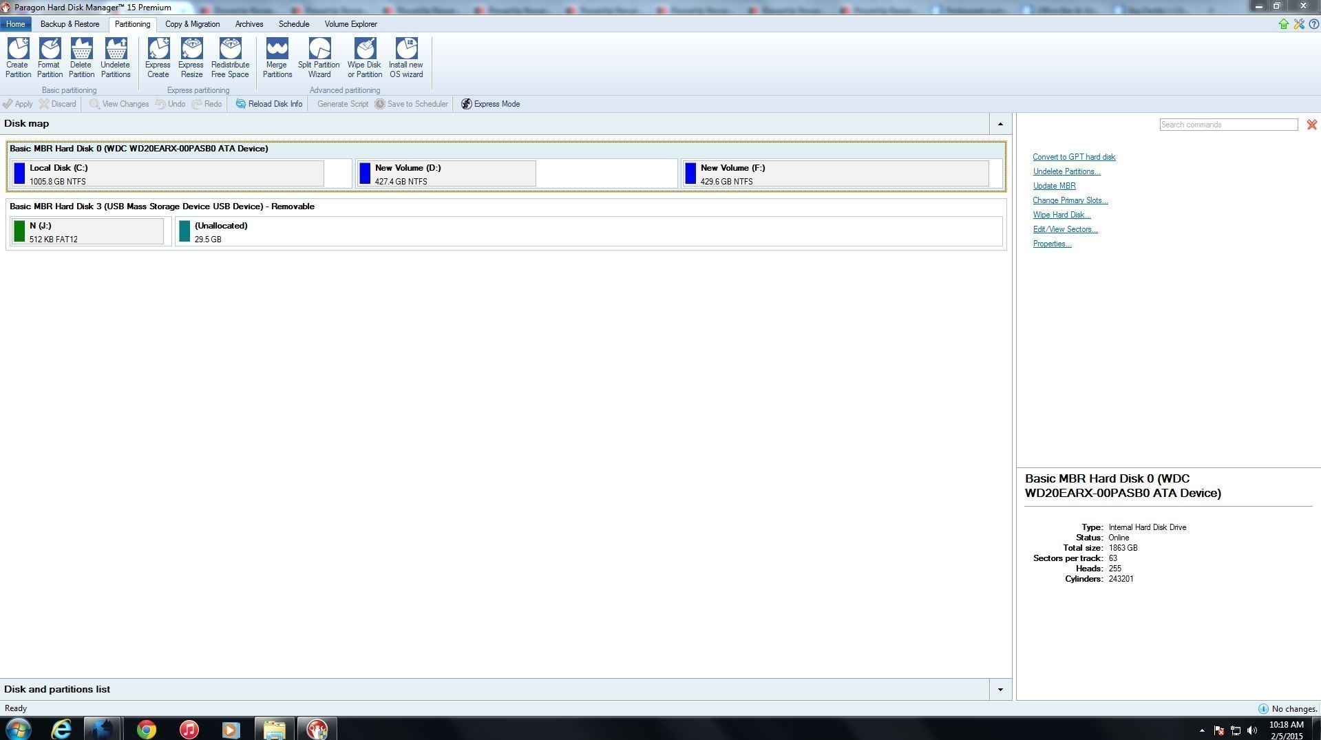

When I tried it is saying the card is write protected. it is in a usb adapter so it is not write protected. i have tried using paragon hard disk manager 15 premium and you can see it shows up as a 32 gb micro sd card, but nothing will format it back.

When I tried it is saying the card is write protected. it is in a usb adapter so it is not write protected. i have tried using paragon hard disk manager 15 premium and you can see it shows up as a 32 gb micro sd card, but nothing will format it back.View attachment 15410View attachment 15411
When you use SDFormatter to reformat a card fully you should set format size adjustment to ON.
It might solve the issue, or it might not.
