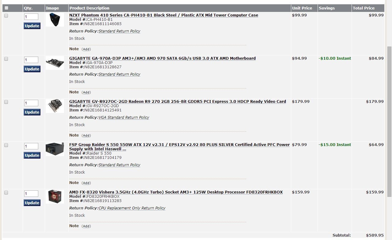

    ok, so im pretty much set on what im getting, just sorta want an experienced hand's opinion on the setup.
    asdfasdfasddd.jpg im scrapping ram/hdd from my current comp. and yes 8 cores seem a bit excessive but id like to see how well it would do with video processing and 3d modeling as well as with gaming. any thoughts, opinions or things that i should do to make it work better are appreciated.

    IF you wanna save some money you could go with a cheaper NZXT case unless your dead set on that one, I've got a white NZXT case that is pretty good that I only paid $50 for, but that's about the only problem I see everything else looks good, although if you wanted you could overclock your graphics to make it a 270x for free saving you about $30.

    yea, im dead set on the case lol. this will be my first build, so idk much about setting things on over clock and stuff. and with the psu being 550watts that would suffice for all components?

    Just remember that overclocking tends to reduce the parts lifespan.
    Edit: also, 550W from a good brand PSU is more than enough for single-graphics card systems.

    thanks for the info, the reviews on the psu i have selected are pretty good, hoping it'll work the same for me. as long as this build will last a few years and do the other things i want it to do (3d modeling/video editing) in a timely manner with no hiccups then i guess im set.

    Building computers isn't hard, just take your time in seeing how the parts fit together and put it together. Take a little extra care with the heatsink for the CPU - you only want to attach it once so the thermal paste between the heatsink and CPU is at its best. If it uses push pins (I've never used an AMD stock heatsink before), then push them in a X pattern (top left first, then bottom right, then top right, etc) for even pressure. Everything else is pretty straight forward. Hardest part is tidying up all the cables at the end.
    Also, clean your hands before starting, and make sure to touch something metallic to ground any static energy from your hands. There are many stories about static shocks killing computer parts, although I've not had it happen to me yet (maybe because I always start by grounding myself).

    as for grounding, do i need to have one of the wrist bands? i've installed my current gpu and ram with out it, and things work fine, but should i chance it with a full build? also bios are with the mother board already or do i have to get all that as well?

    You don't need to. Just touch the metal part of the case every few seconds.
    Also you can get a Radeon R9 280 for $30 more dollars which is a great price considering the perfomance.
