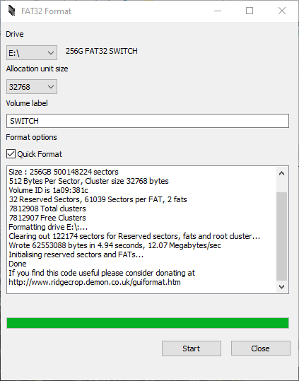

Here are the test results:
Warning: Only 244203 of 244204 MByte tested.
Test finished without errors.
You can now delete the test files *.h2w or verify them again.
Writing speed: 17.3 MByte/s
Reading speed: 18.0 MByte/s
H2testw v1.4
Also I joined a screenshot of the tool I used to format my microSD to FAT32 (which I did after the test finished).
