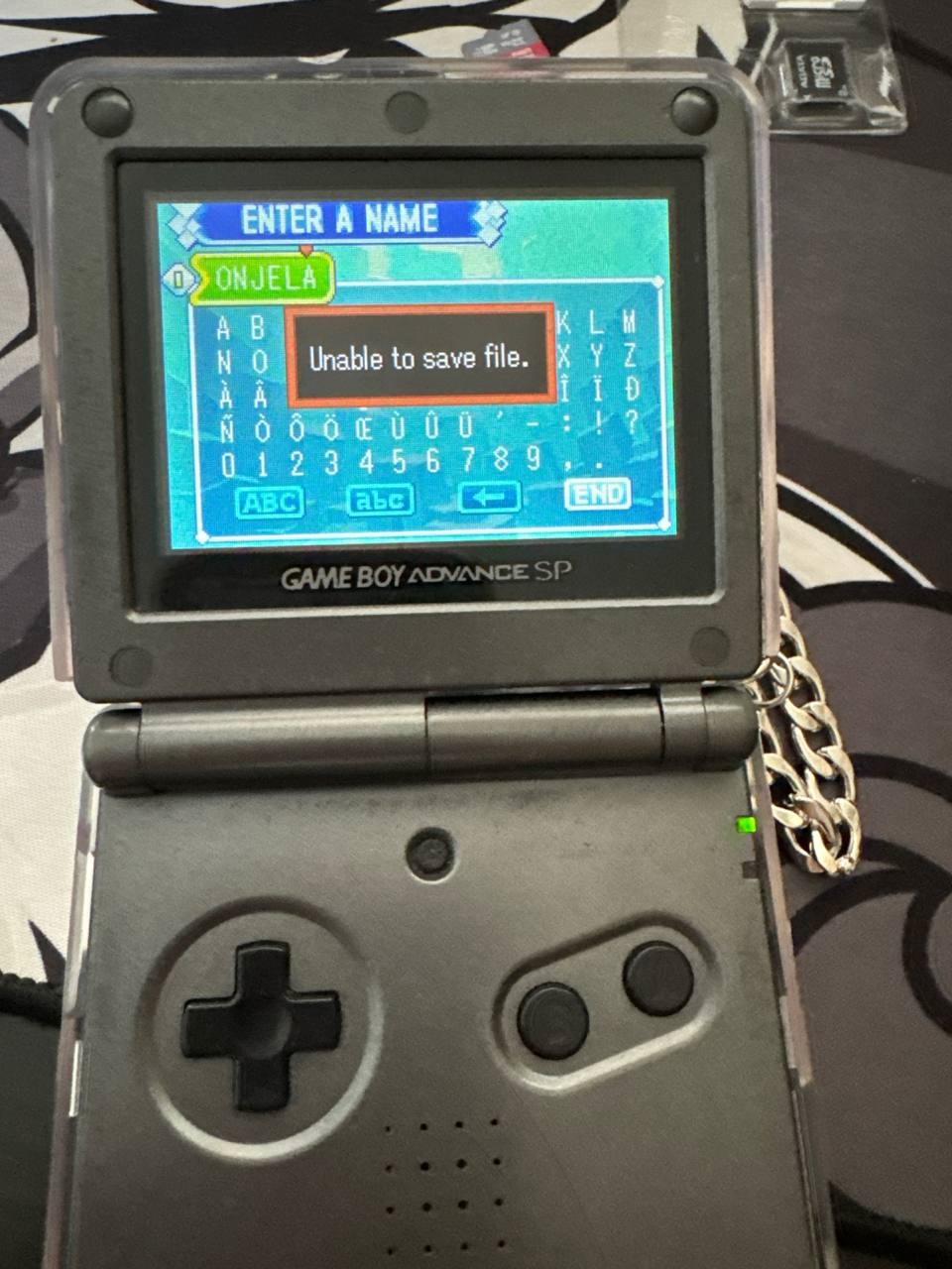

Hello everyone.
I encountered a problem that progress in games is not saved. Also, in The Legend Of Zelda it is impossible to create a save (I am attaching screenshots).
Also, savestates do not work. When using them, artifacts appear and the game freezes.
I installed the original latest firmware and SimpleLight, the problem persists everywhere.
I have a question: is this related to the software or the hardware itself?

Hello everyone.
Is this issue only with the Zelda game? Are other games working fine?
Please check the ROM's hash results compare known online dat.
Or have you manually set the save type in the ROM's launching menu before?
