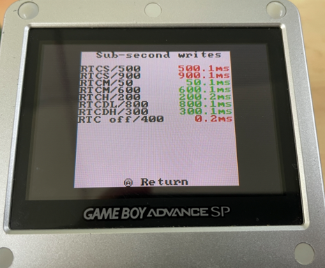

@EZ-Flash2 what are you using as your time source when the cart is running? My tests use the CPU clock as a reference. A 0.3% difference is actually quite large... which is surprising.

it seems the crystal oscillator causes this, If we can confirm that this error is a fixed value on all cards, we can consider manual correction.

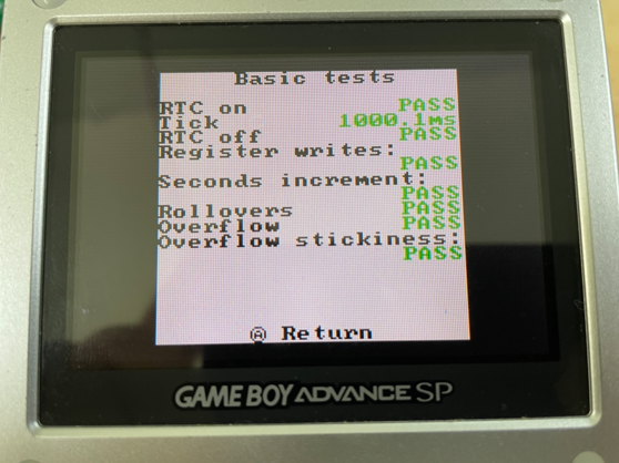

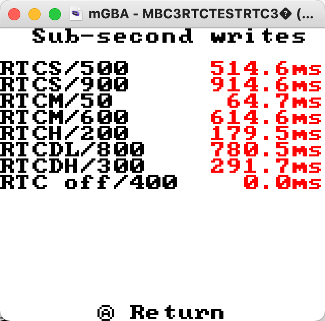

progress report

But, with the newest test firmware and kernel, the Prism still have time shift problem. play time will be included in the time shift. other commercial games like Keitai Denjuu and Pokemon Crystal are not affected.

This is not my opinion, after all, the previous RTC simulation code does have flaws that cause problems with commercial games. Now that the RTC simulation code is getting better, I plan to discuss the problem further with @aaaaaa123456789
