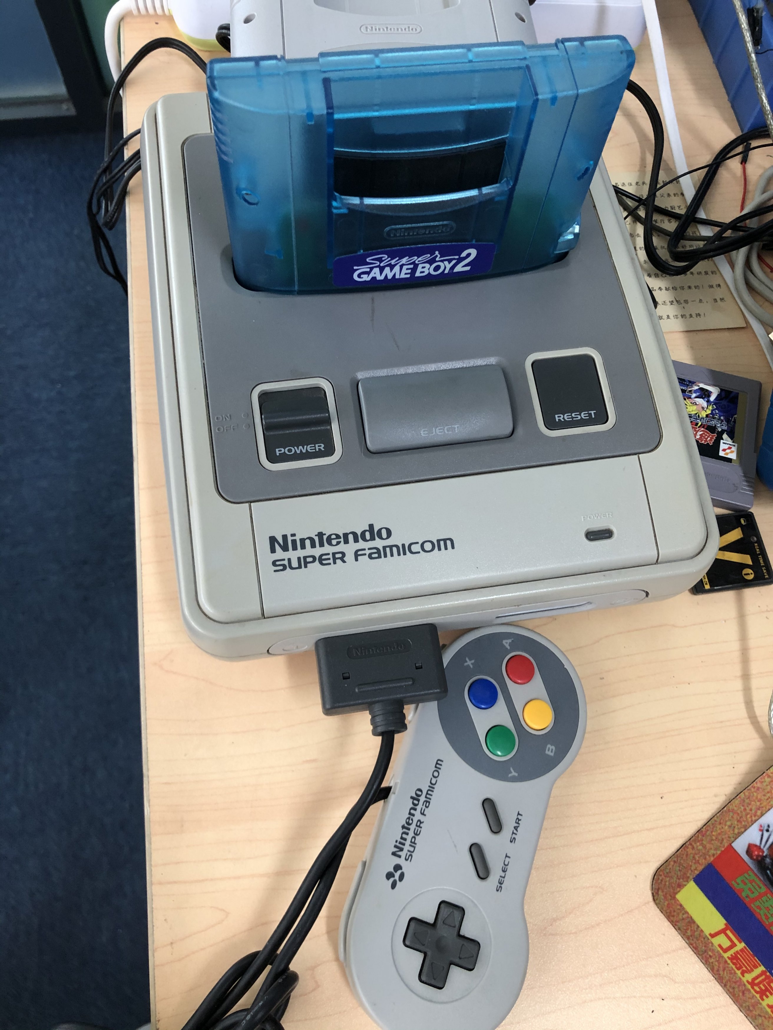

It's been a while since the last update. and while we were waiting for the Prism crew to fix his Junior, some kind Chinese user lent us a set of SGB, but..........
We've found that Junior's development board won't fit into the SGB slot without damaging the SGB cases, as it has a lot of wiring connectors on the development board . So we still need time to modify the development board.
SGB compatibility is hopefully added to this FW5 final release.
Couldn't you just take the SGB out of its plastic shell? It comes apart like any other SNES cartridge.
We can not open it without proper screwdriver. And the unit is old and has bad contacts, so I don't know what new problems will arise when I take it apart.
