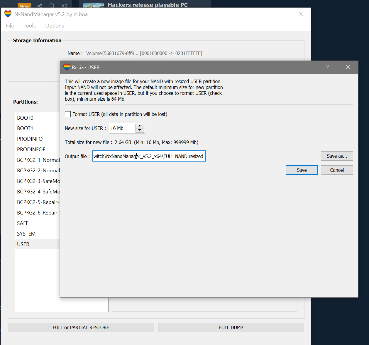

By the way you can do everything with nxnandmanager to bypass the emummc size limit posed by hekate. For me on my oled switch there's no emummc size option between 12GB and full 56GB, so I used nxnandmanager to expand my user partition to 30GB. You can create an emummc with user partition up to 1TB.
First go to tools - resize user partition tool in nxnandmanager, it will create an image with new user partition size:

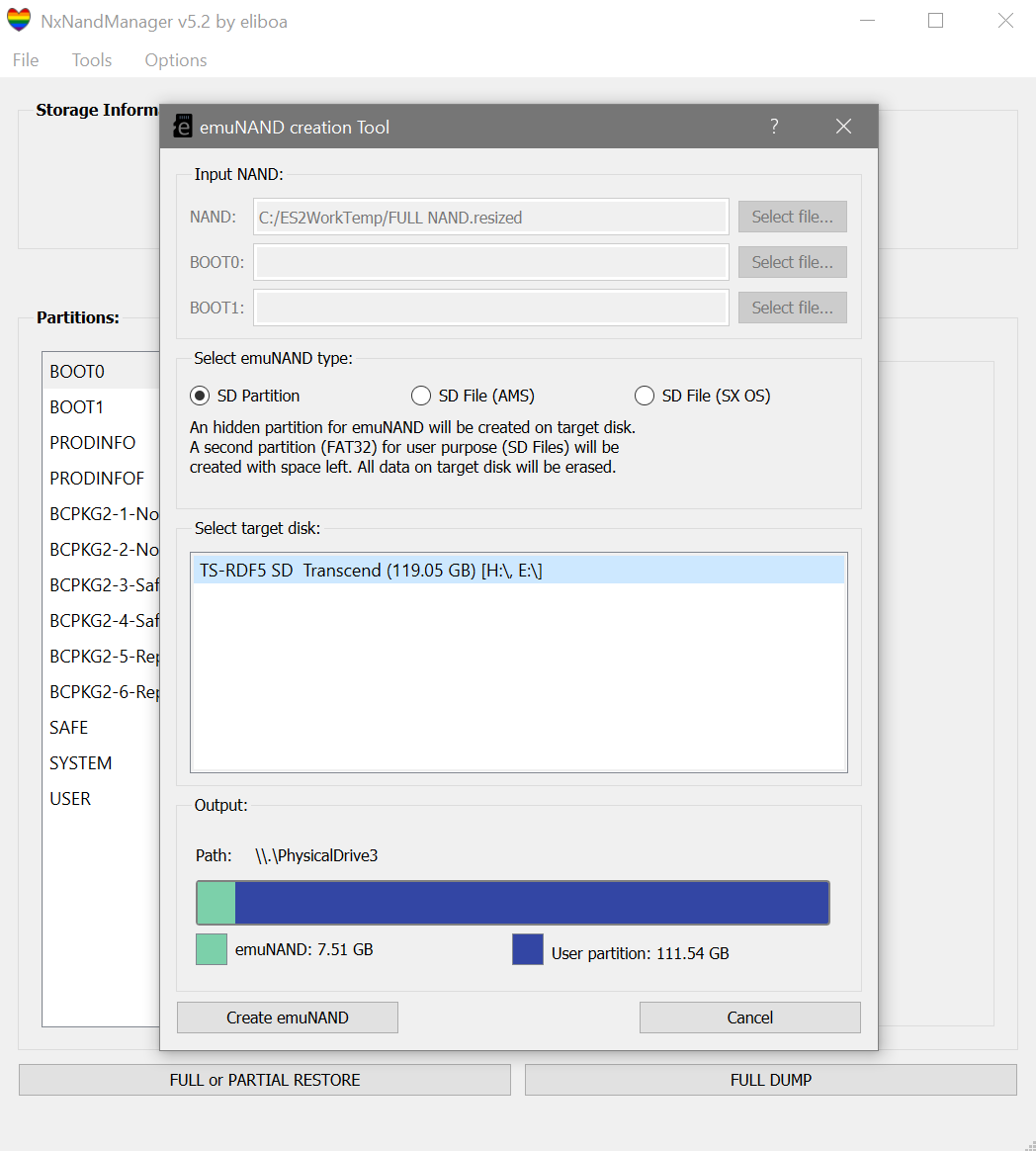

Then open the new image it created, go to tools - emummc creation tool,select your sd card and write the image. You'll need to back everything up on the fat32 partition:
