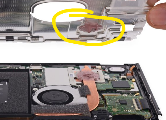

So I repasted my switch last night. I'm using Kryonaut, on everything (no thermal pads on hand).
The back of my console seems to get pretty warm now, but the exhaust air doesn't really feel that warm... wondering if I fucked something up? I'm not new to this kind of stuff (delidded i7 4770k 4.1 GHz stable, liquid metal, repasted quite a few GPU's, etc) but I'm not sure i got it right with the switch.
I did the following:
  1. took the cover apart
  2. removed the RF shield thing
  3. removed the heatpipe for the cooler
  4. removed the shield that is over the SoC and RAM
  5. Cleaned everything good with 99% isopropyl alcohol.
  6. Applied thermal grizzly kryonaut to RAM and SoC (about a pea size drop on the SoC)
  7. reinstalled the plate over SoC and RAM (left the copper shim) hoping that would help spread paste))
  8. applied more kryonaut
  9. Installed the heatpipe cooler
  10. Put a nice line of paste on the heatpipe (probably about 3" - 3.5" long)
  11. Installed the RF shield thing
  12. booted.
Now, everything works, and I don't notice anything different in regards to frame drops. That said, I don't have BotW, or any of the really intense games. I'm also not soft or hard modded at all.

Is Mx-4 enough to bridge the gap between the metal cover and copper heatsink? Kinda hard to find one here
I took the copper plate off and used one of those IC Diamond thermal graphite pads. Best decision ever. Far better heat transfer than the little piece of copper. but to answer you, yes. MX4 will work just fine.
I am talking about the glob of thermal paste, i was hoping that mx-4 will be enough to fill it so i dont have to buy and wait for thermal paste
should be that is what I did on my switch and its still going good today and plus it runs cooler and games seem to run better but that may just be me though.
Yup. That garbage they used is useless. Any thermal paste will work better then that goop.

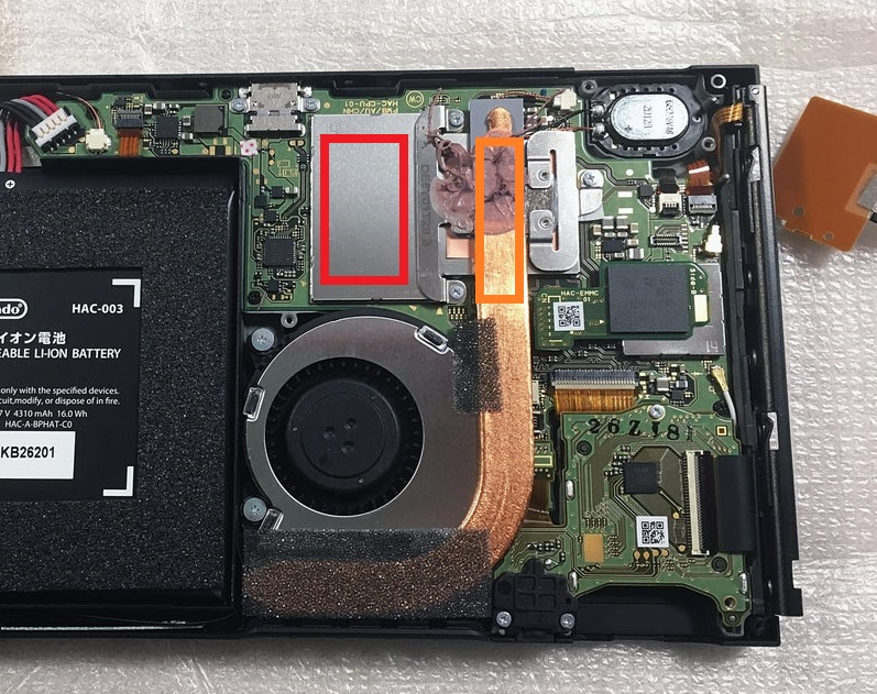

I am disappointed with the result after thermal replacement. Before replacement when docked mode is about 56 degree c after replacement is about 54 degree c. Which is within margin of error in measuring. Replaced both thermal paste on top and below the heatssink and remove the copper tape.
Did you make sure you put fresh paste on the cpu and then put the copper shield back on? Because if you just took it off, big problems will come.
I remove the copper tape so that that heatsink is directly connected to the CPU die. What "big problem" you referring to?
That's normal. Nintendo seems to prioritizes keeping a lower fan speed over temps, so all replacing the paste will really do is reduce the fan speed.

I replaced the default paste with mx-4 without any pads and my switch is the hottest at the exhaust compared to last time around the middle area. But see no major improvement in temperature monitor, i guess the better thermal paste only makes the cooling system more effective in a sense that the heat is more directed to the exhaust instead of spreading it around the switch. .
