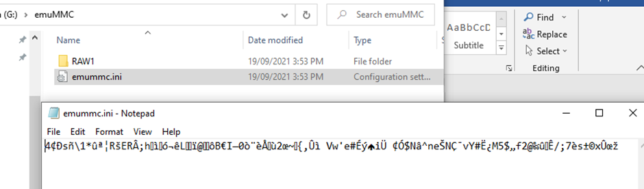

I also noticed my emummc.ini text looks weird, its not ment to be like this right?

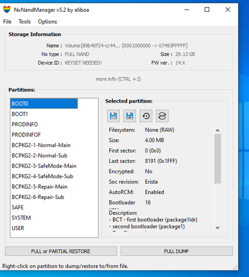

I can see from one of the pics you uploaded from NXnandmanager it says something about “Device ID: keyset needed”. I have no clue if it’s normal but may be a red flag in tracking down what’s going on with the not-working emunand. I.e. prod keys issues? Boot0 related? Why would any of these stop hekate from booting?
