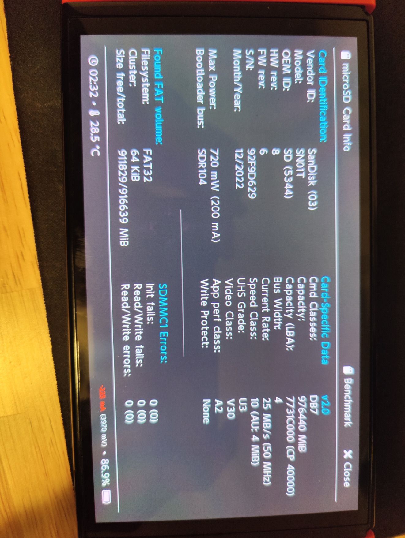

Hey all. I have a OLED with HWFLY 4.1. The sdcard reading is slow. I get long load times and laggy cutscenes in games. I have tried multiple sdcards from other switchs (that work fine). I tried swapping the sd card reader also. Still all the same results. I cannot figure out why im getting slow reading/writing on this console. I took the sdcard out of this switch and put it in another and reads and writes quickly. Hekate does not say Im running in 1 bit mode either. I have formated the sdcard and recreated the emummc multiple times. tried file based and partition based. all the same. any clues at all?

Hey all. I have a OLED with HWFLY 4.1. The sdcard reading is slow. I get long load times and laggy cutscenes in games. I have tried multiple sdcards from other switchs (that work fine). I tried swapping the sd card reader also. Still all the same results. I cannot figure out why im getting slow reading/writing on this console. I took the sdcard out of this switch and put it in another and reads and writes quickly. Hekate does not say Im running in 1 bit mode either. I have formated the sdcard and recreated the emummc multiple times. tried file based and partition based. all the same. any clues at all?View attachment 412611
Change resistors to 100ohm on A and C on your chip.

hey thanks for reply. I'll test the resistors when I get home.

this not a picofly. Does that matter? Can anyone confirm firm which resistors are for A and C? I can't beep them out because the installer covers the chip with UV resin.
I'm gonna leave an update here. I just swapped the hwfly to a picofly with the proper resistors and emunand still doesn't boot and I get 25mbps still on the SDcard. I think the switch is defective? No body has seen anything like this? This switch has me stumped. cfw sysnand boots. ofw boots emunand does not boot because it's is reading directly from the SD card.
