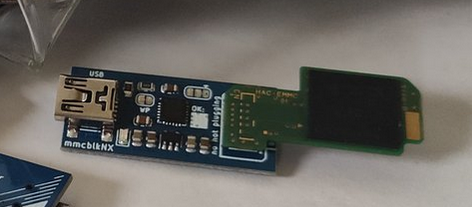

A Hardware eMMC reader capable of reading HAC-EMMC raw partitions including boot0 and boot1

You need Linux to read and write boot0 and boot1 with this external emmc adapter,thanks to Ignas Urba for this nice repair tool.

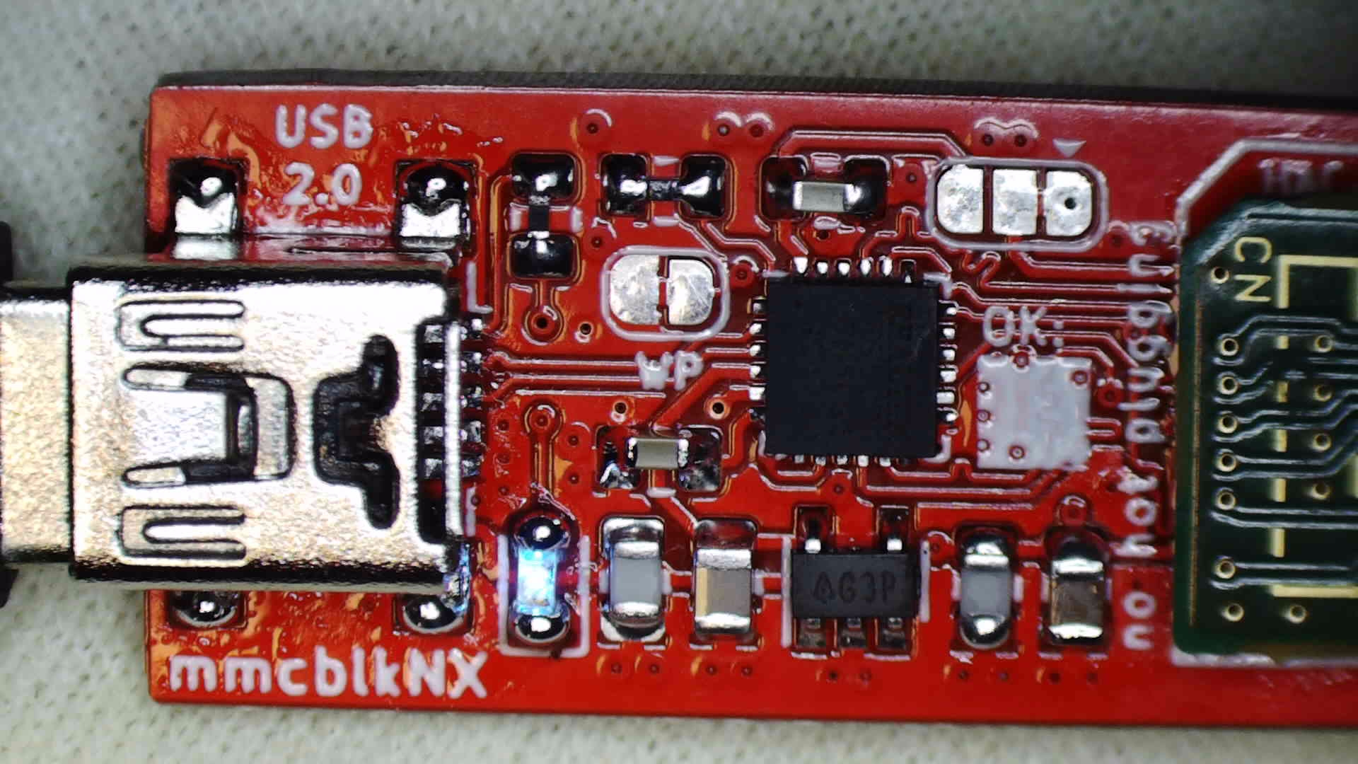

I chose the ugly self assembly route with some incorrect foot print parts found around the house :)
All info is in the project page,except the write commands.

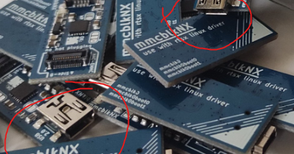

Hello. I ordered this tool from tindle.
Who received it, could you tell me if a USB cable is included?
If it weren't included, from the photos I seem to have seen that it has a USB Female, so I would need a Male-Male USB cable to connect it to the PC, so I evaluate if I have to buy the cable first or not.
Do you confirm?
Do you confirm?
That's not female USB-A, that's USB mini B.
