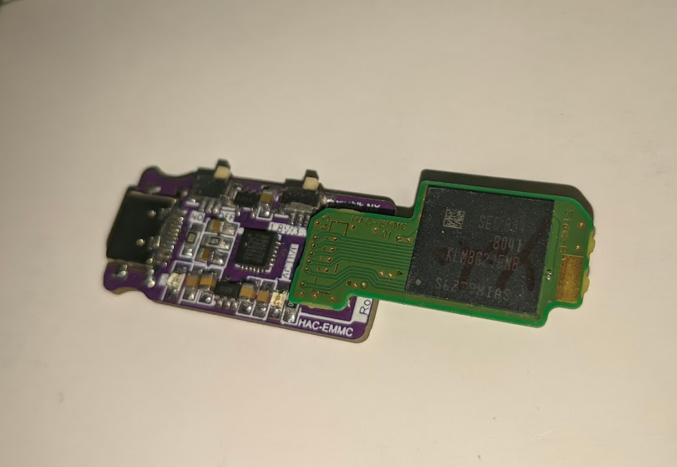

It's simply a card reader that is able to read the bootpartions on emmc chips.
You need Linux and this tool and then you can mount the emmc partions.
It's similar to mmcblkNX GitHub documentation.

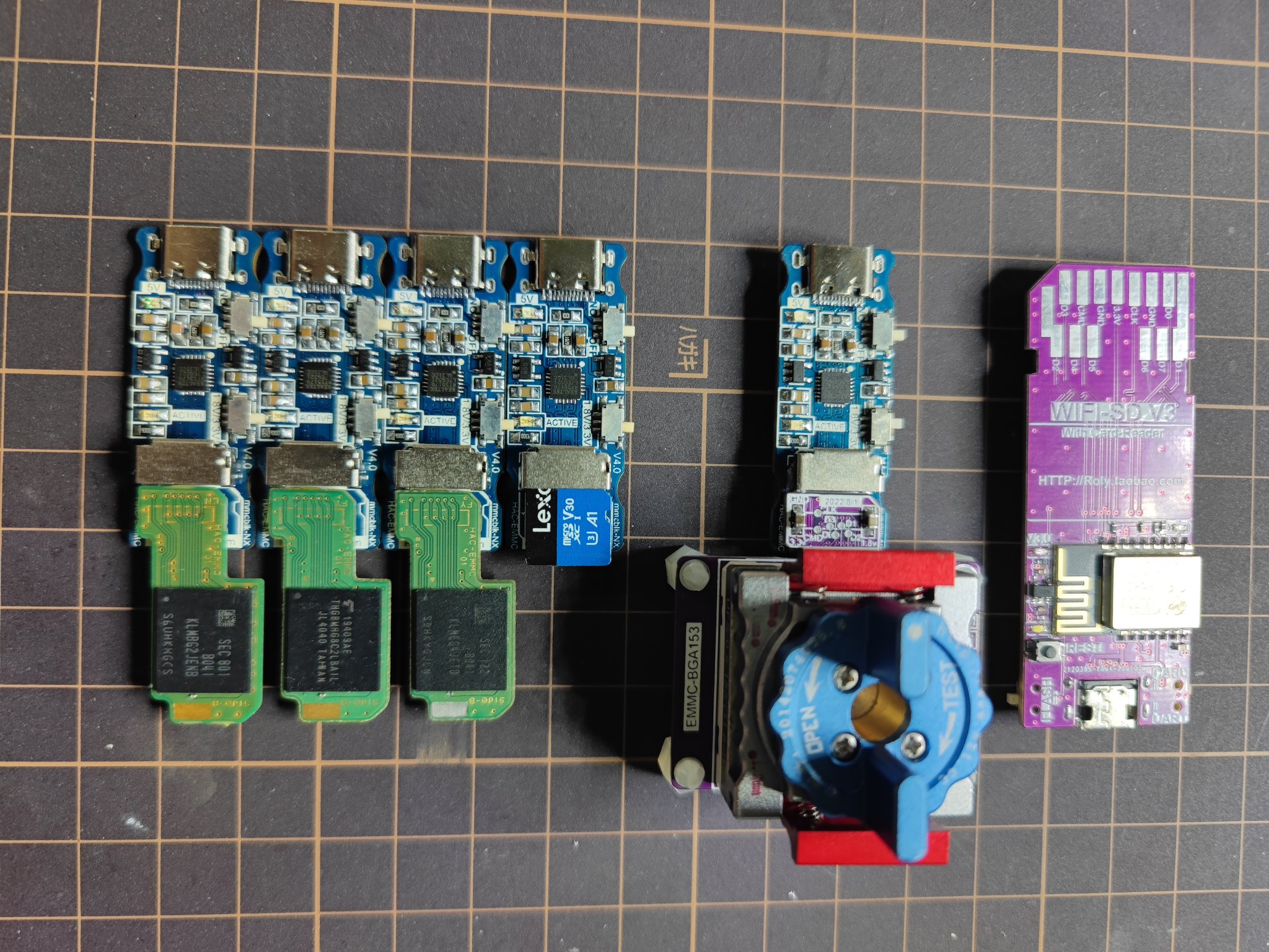

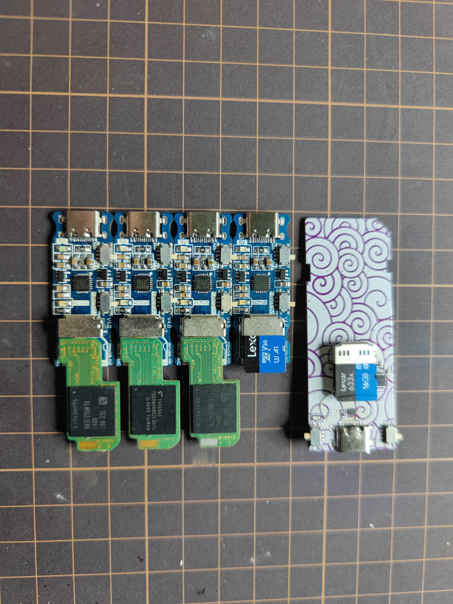

Thanks - I saw the one on Github, but that's based on an RTL chip + the rtsx driver.
In the photos of the one from @JBDZ it looks like it's based on an RPi 2040, so I just curious how it's working in Linux without any particular drivers?
Nope, it uses same RTS5170 like the GitHub original designed.
I guess I can kinda see the resemblance from the pics? But I don't blame him too much because the CSS/Superbuy listings both say "RP2040" in their titles lol
I guess those reseller sites are just doing eye catching title, and literally they have no idea what the item does.
I got mine from "Yellow-fish"(nick name) Chinese market place from the @JBDZ store, I dont see any rp2040 mentioned inside out.

When the time is right, I will send out my RP2040, which will be unique.
@JBDZ - can you help with this please?
The latest mmcblk V5 has added a power switch,3.3V and 1.8V regulated power switch. Currently, it can support all EMMCs. For the time being, it can only work under ubantu system, dumping data information and BOOT0 and BOOT1 information by command. You can use the following tutorials. https://www.bilibili.com/video/BV1fS4y1B7Cy/
