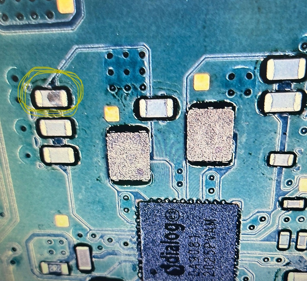

Before I got the 808B0027 code, I removed a capacitor from the board and then the code appeared. I put it back but the code is still there. Does anyone have the information to replace it? Here is the image of the component
This chip is power supply for SSD controller and chips around it - nothing to do with your problem. Just check that you have power to the BT/wi-fi module. Fuse F7002 - from one side of the board you shold have 3.3V, from the other side is 1.8V.

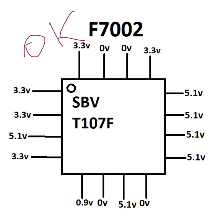

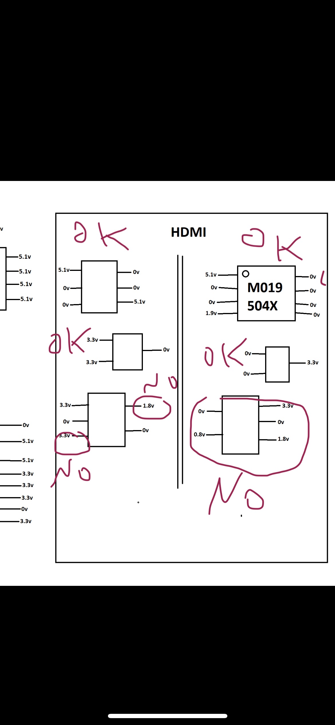

Thanks for your help. Here are the results.

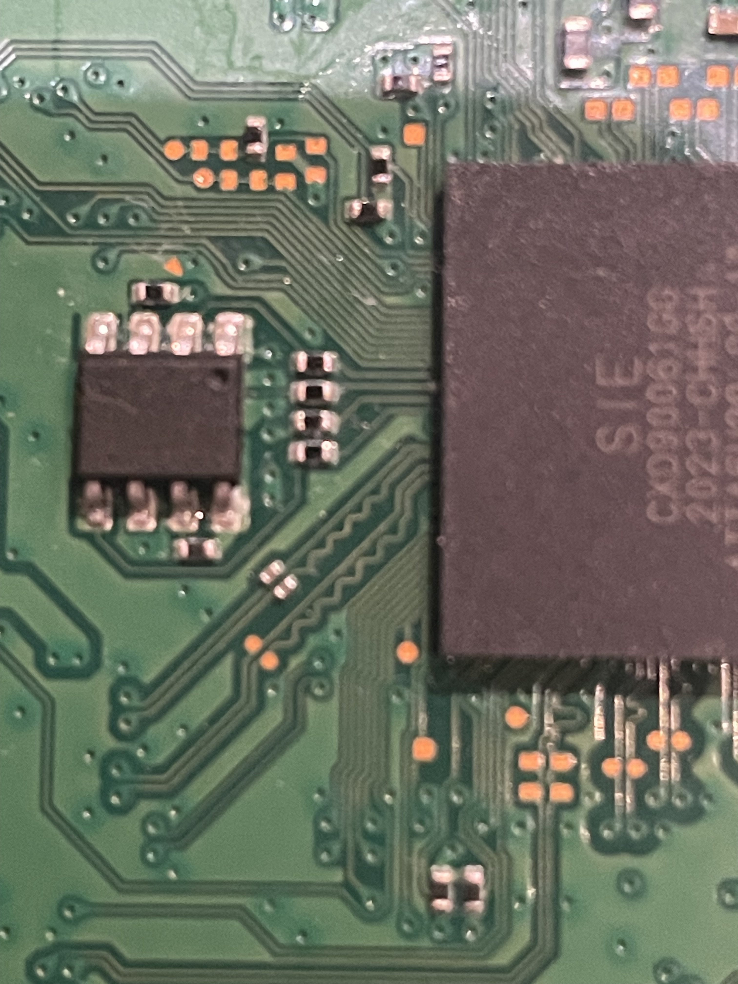

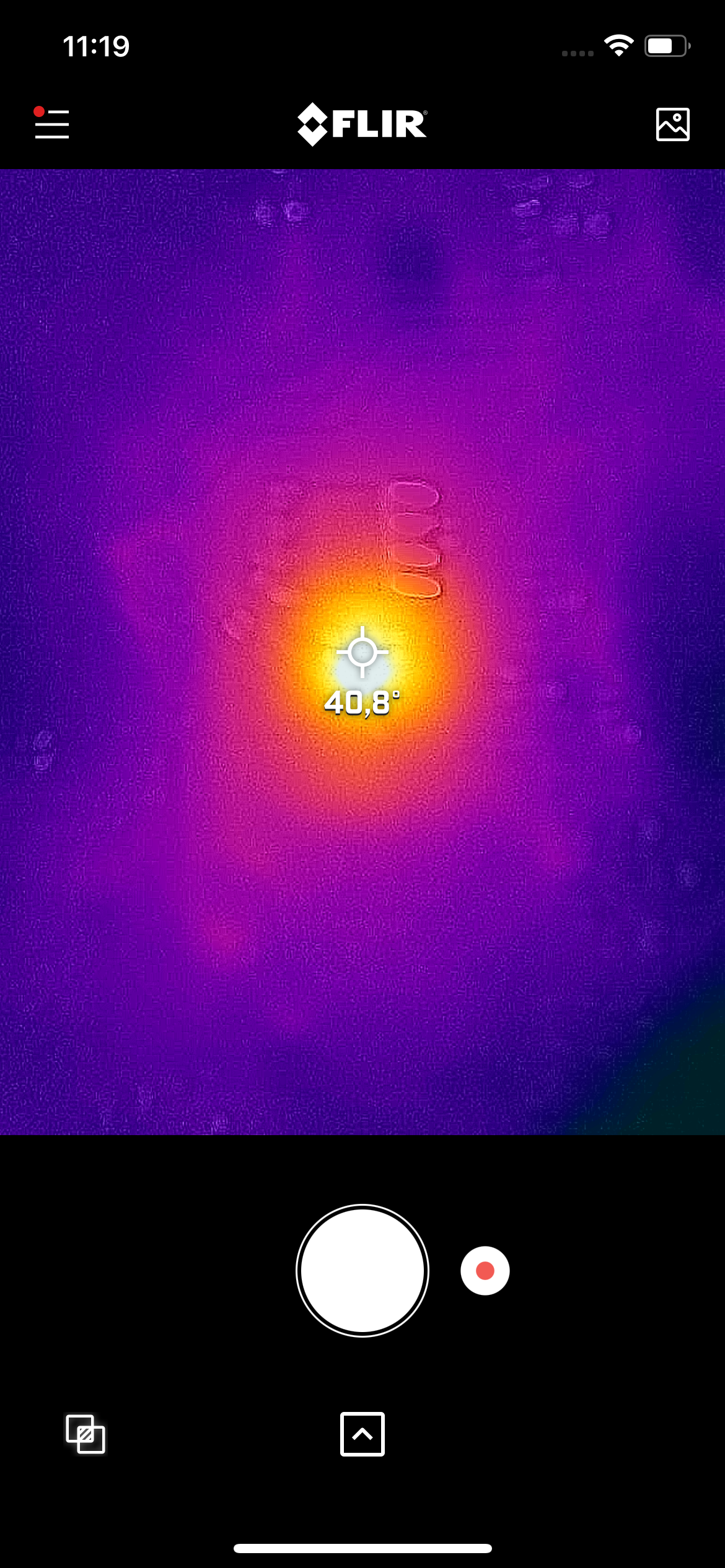

My Wi-Fi chip has 3.3V and 1.8V. The voltages at fuse 7002 are OK. I have 5 volts and 3.3V. The chip has the correct voltages. On side B, the voltages of 5.1V and 1.8V are OK. I'm missing voltages at the hdmi chip (see image). However, when I plug in the lab power supply and click on power, I noticed a warming up, and I think the problem is coming from there. It rises to 40°C, it's between the SIE chip and the BIOS. There are four components. I took readings: multimeter in ohms
- black on ground and red on component: 1.8 mohm, 1.8 mohm, 12.4 kohm, 1.8 mohm
- black and red on component:
47.9 ohms on each
