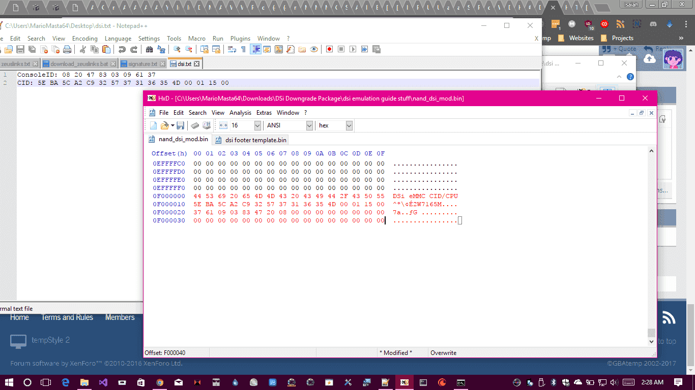

lemme get out some dev dsi apps or something now. or i could use the flipnote dump from getting my id
same error :<
same error :<
Ahh, I see the issue. Your are lacking the correct naming for your DSi BIOS dumps! :P
They should be named BIOSDSI7.ROM and BIOSDSI9.ROM. My dumps have a CRC32 of 9F1840D9 for the former, and 3D64D498 for the latter. Lacking those dumps gives me the same 2-2435-8325 error code. (Mine were attained from the Internet Archive)

so only issue was that apparently it didnt accept my dumps (no$gba never accepts any dumps i give it :< no matter ds or dsi and idk why)
REEEEEEEEEEEEEEEEEEEEEEEEEEEEEEEEEEEEEEEEEEEEEE:
I guess that solves the mystery of why you couldn't get even a clean dump booting. :P
Make sure you flash back the NAND dump that doesn't have the footer. Since there isn't enough space on the NAND, I don't think it would cause any issues with a hardmod, but it might make software-based methods act strange... :unsure:

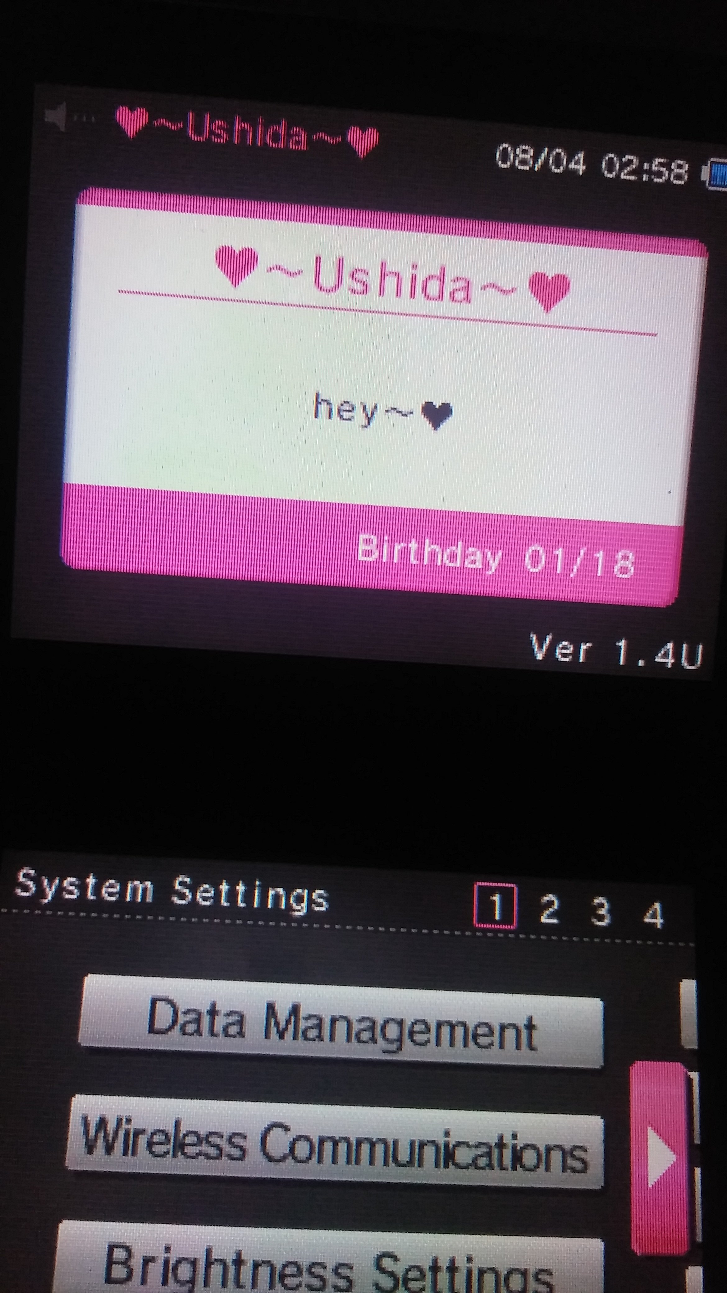

this is the one i saved without the footer. i "save as'd" into the no$gba folder so that it wont affect the original. i even checked the original top make sure. im a very careful person.
well. time to write the image back to dsi.
flashing nand back to console now
wish me luck
AYYYYYYYYYYYYYYYYYYYYYYYYYYYYYYYYYYYYYYYYYYYYYYYYYYYYYYYYYYYYYYYYYYYYYYYYYYYYYYYYYYYYYYYYYYYYYYYYYYYYYYYYYYYYYYYYYYYYYYYYYYYY:
i feel so happy i got this one right :D last one died because someone decided to come in my room and yell my name. returned it to the pawn shop because it "stopped working"
Woo! Congratulations! :P
