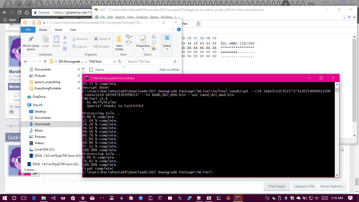

now with the footer. its AAAAAAAA forward and BBBBBBB backward. correct? so 12 34 56 would be 56 34 12

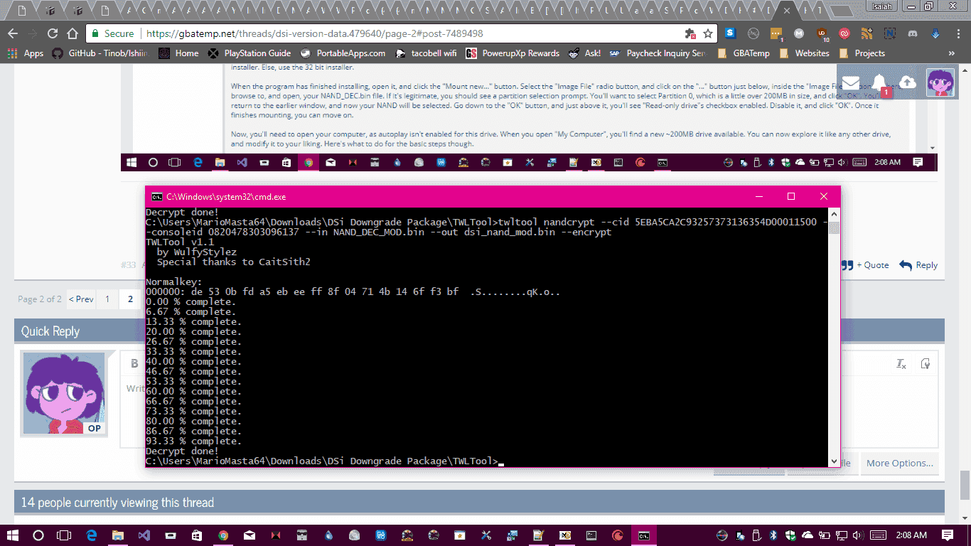

Oops, that might be your mistake -- you didn't add the --encrypt flag to the end! :P
lmao wut
is this better?
lmao wut
Yep. Your command should have been:
twltool nandcrypt --cid XXXXXXXXXXXXXXXXXXXXXXXXXXXXXXXX --consoleid XXXXXXXXXXXXXXXX --in NAND_DEC_MOD.bin --out dsi_nand_mod.bin --encrypt
Try that, and see if it fixes anything. ^_^
Reactions: MarioMasta64

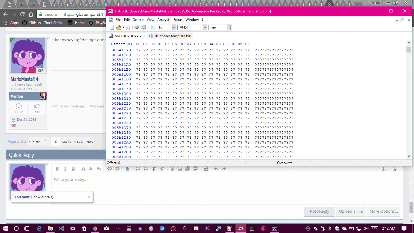

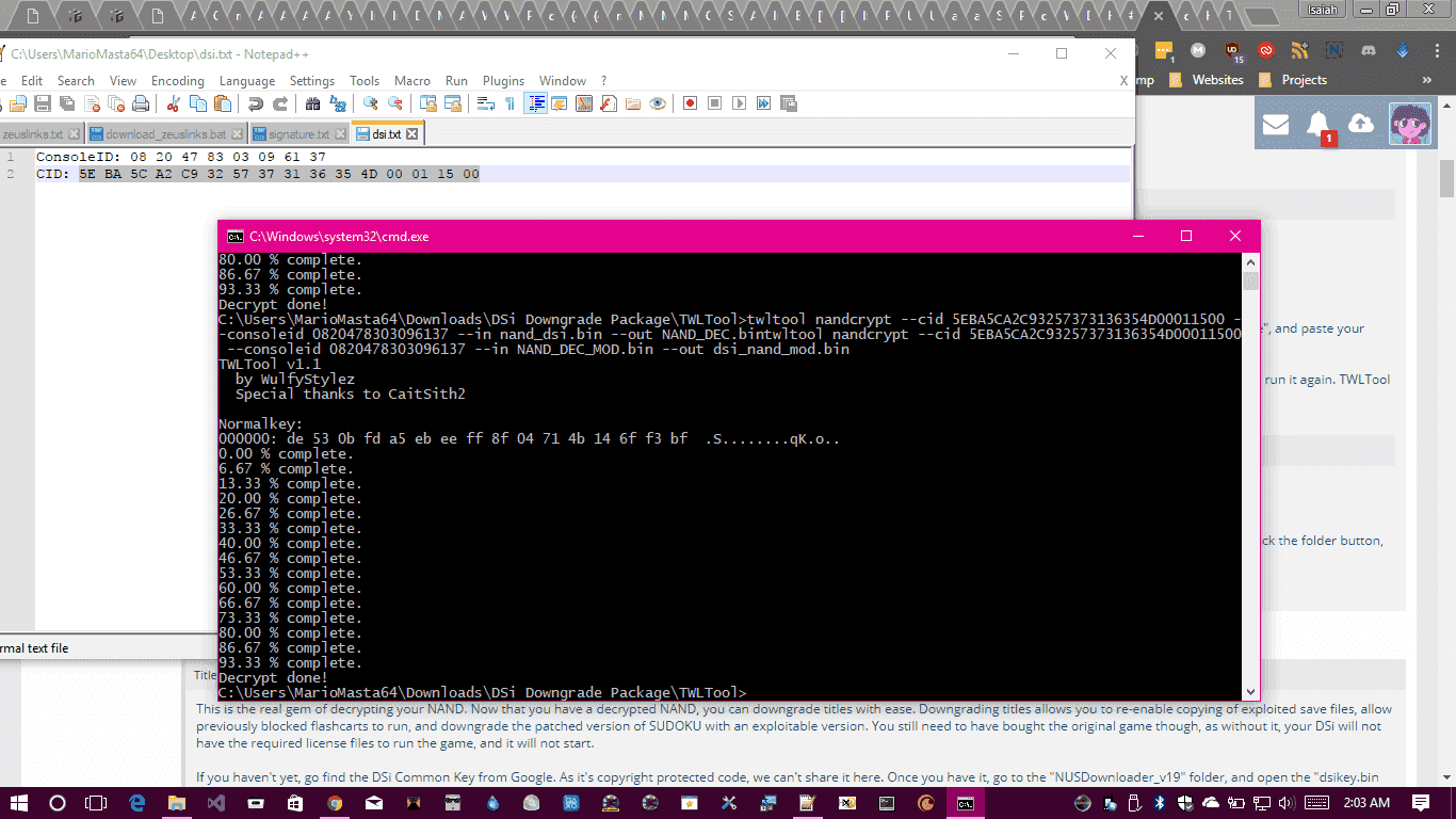

Yeah, that sounds wrong. I noticed that you're using a particularly old version of TWLTool. Try updating from 1.1 to 1.6?
also:
especially since dec_nand is full of data:
The bytes turning into question marks typically means that HxD lost access to a file that was open -- perhaps it was moved, or a program took control of it?
