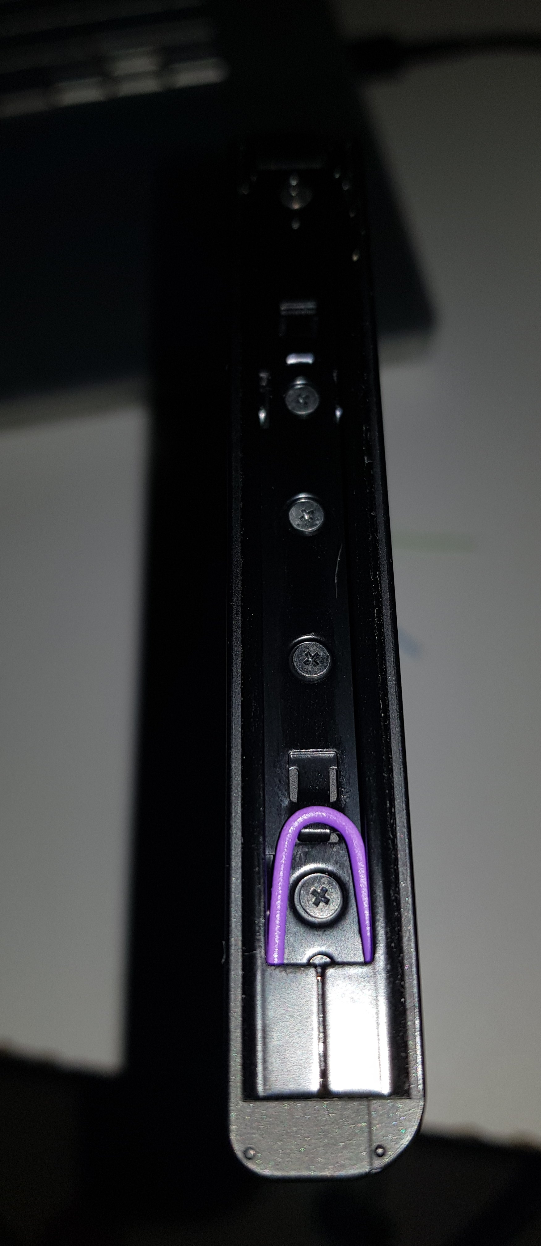

I bought a ton of paperclips to finally get my 4.10 switch running on homebrew, but when I stick it into the joycon rail it just starts the switch up like normal, does anybody have a tip on how to exactly bend it?

Well its in like this, but when I hold vol up and power it just boots like normal
Once you find a paper clip or a small piece of wire that fits in there, and isn't covered with plastic, take your phone's flashlight and aim it inside the rail. Take a good look at where the pins are, and make sure you're grounding the pin on the far right side. Check that it's actually touching the pin, and not just jammed to the bottom, plastic part of the rail.
Well i've been trying it and it doesnt seem to work. Either my macbook doesnt like my switch or the paperclip isnt conductive
It's definitely not your MacBook. You'll know you get into RCM when you put the paperclip in, and then hold the Volume + button and hit the Power button, then nothing happens on the screen. If your console boots, you're doing it wrong. If you have a twist tie or something like that, try peeling the plastic off of the wire and using that. That's what I use and it works perfectly every time.

you will know you are in rcm when the display stays dark.
do it like thise:
- Short the pin
- press and hold vol + and Plugin the usb cable
- Switch should saty off, if it turns on remove cable , adjust the jumper and repeat step 1 and 2.
